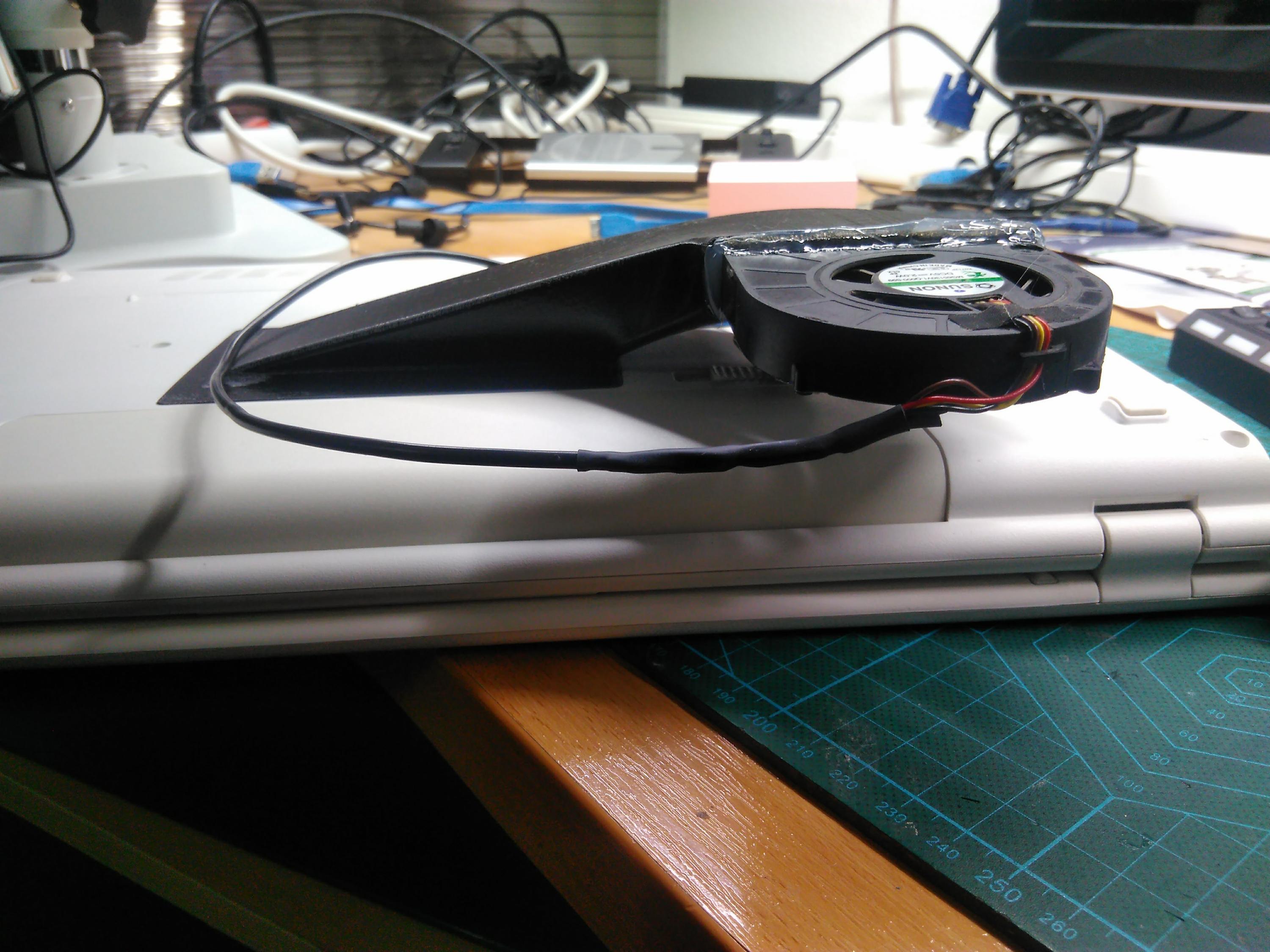

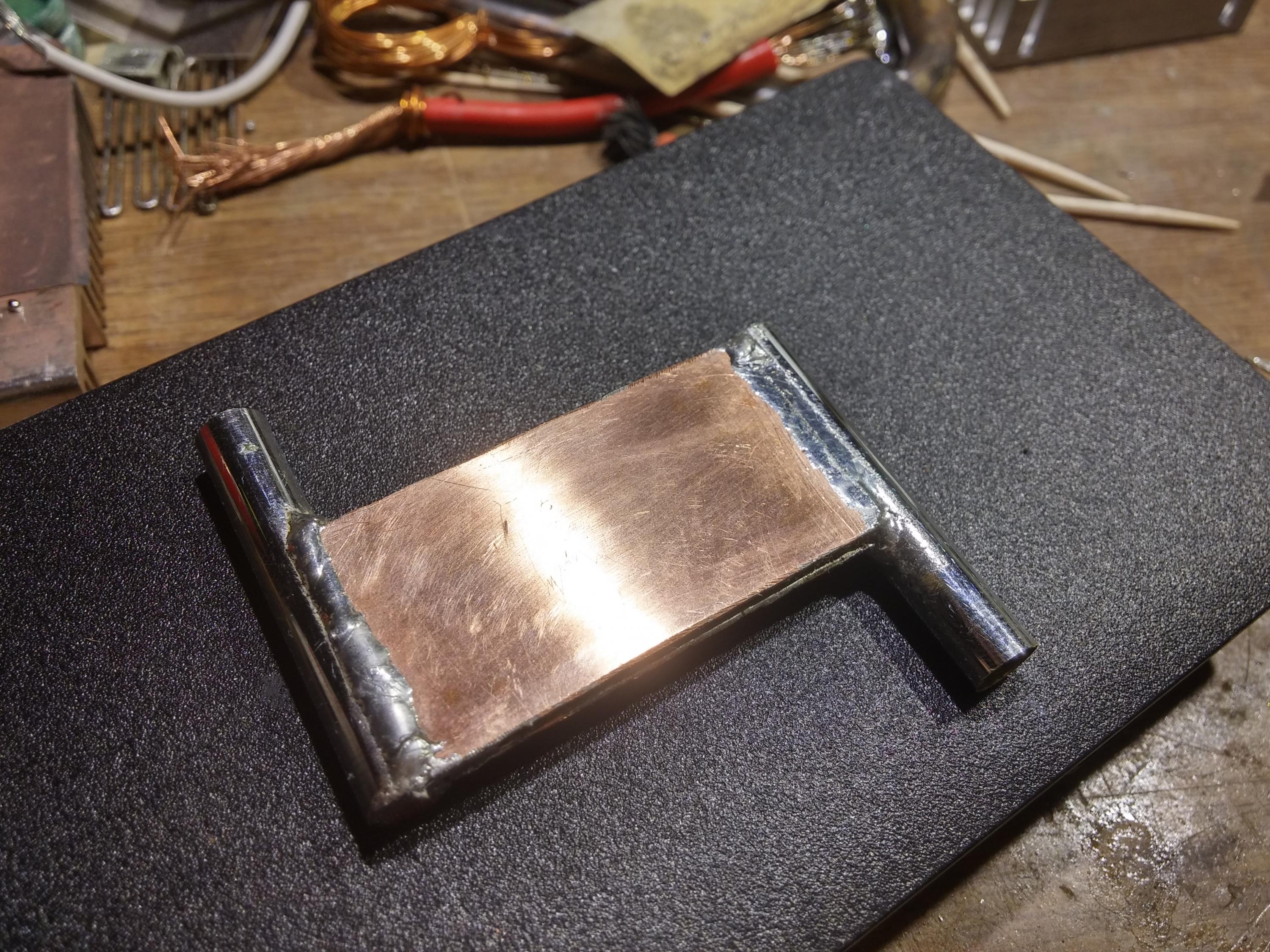

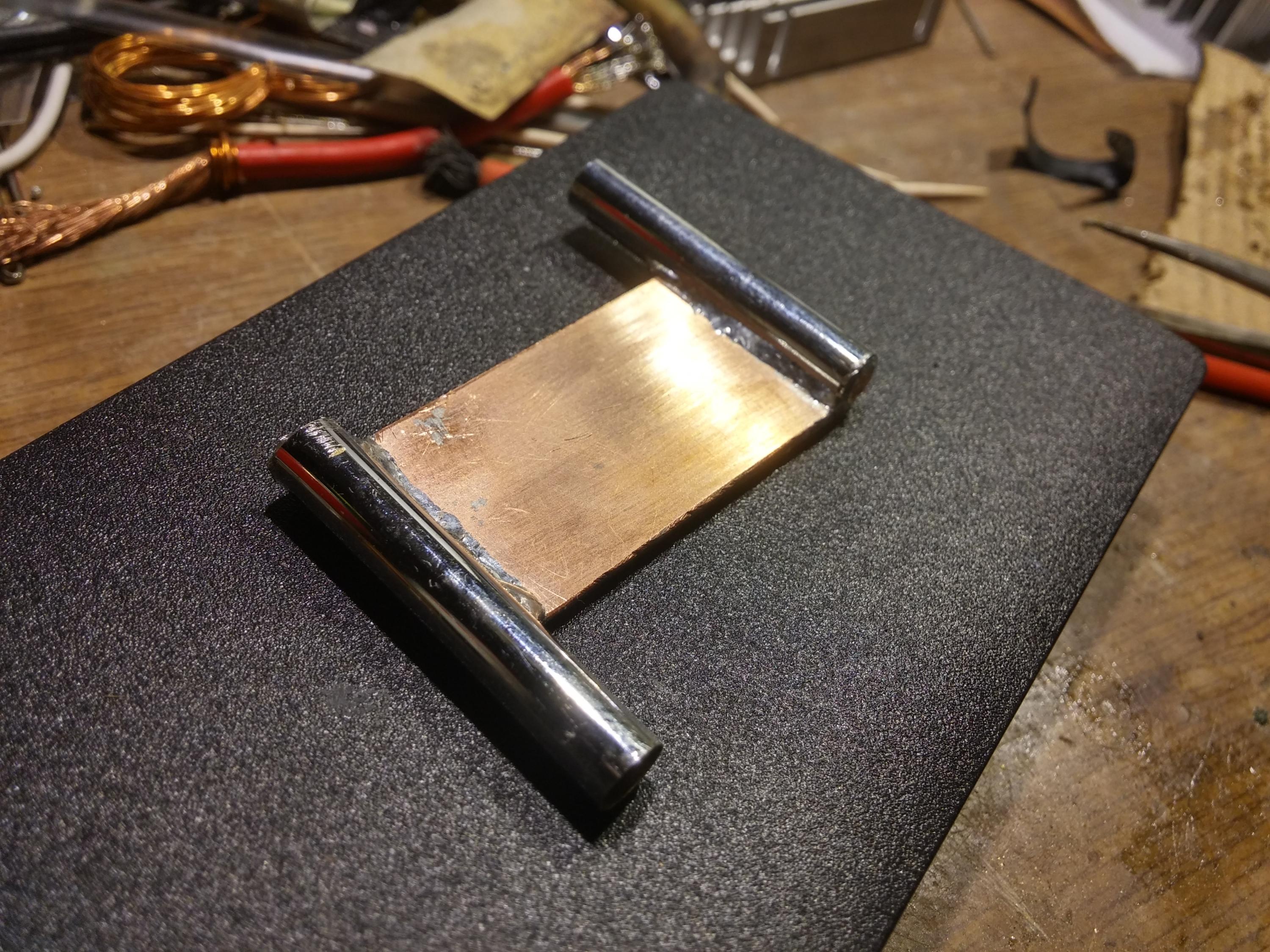

    I've found only two examples of people water cooling their laptops but they were pretty sketchy.
    I'm actually in the process of water cooling my laptop. I'm doing it not because the laptop runs hot but mainly because i like overkill. The laptop only gets up to 75C full load but i want even lower temps, which is why i decided to make a custom water loop for this laptop.
    I'm very curious whether or not there are more examples out there of people DIY water cooling their laptops, maybe some that i've missed (i like comparing my projects to others)
    Anyways, i'll attach a pic of my custom water block and if you wish to see more you can go to my blog at brimmingideas.blogspot.com .

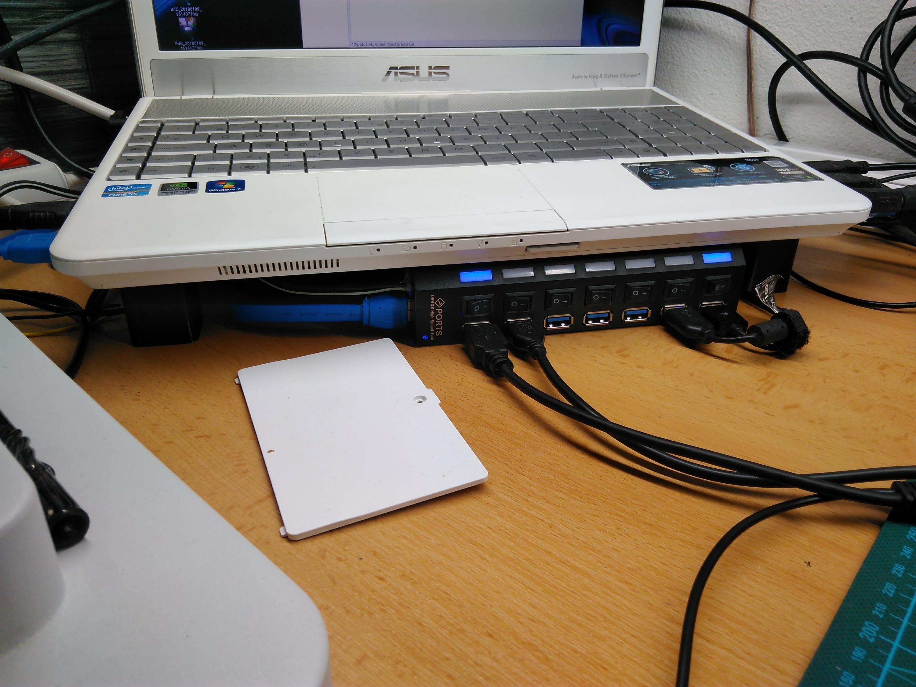

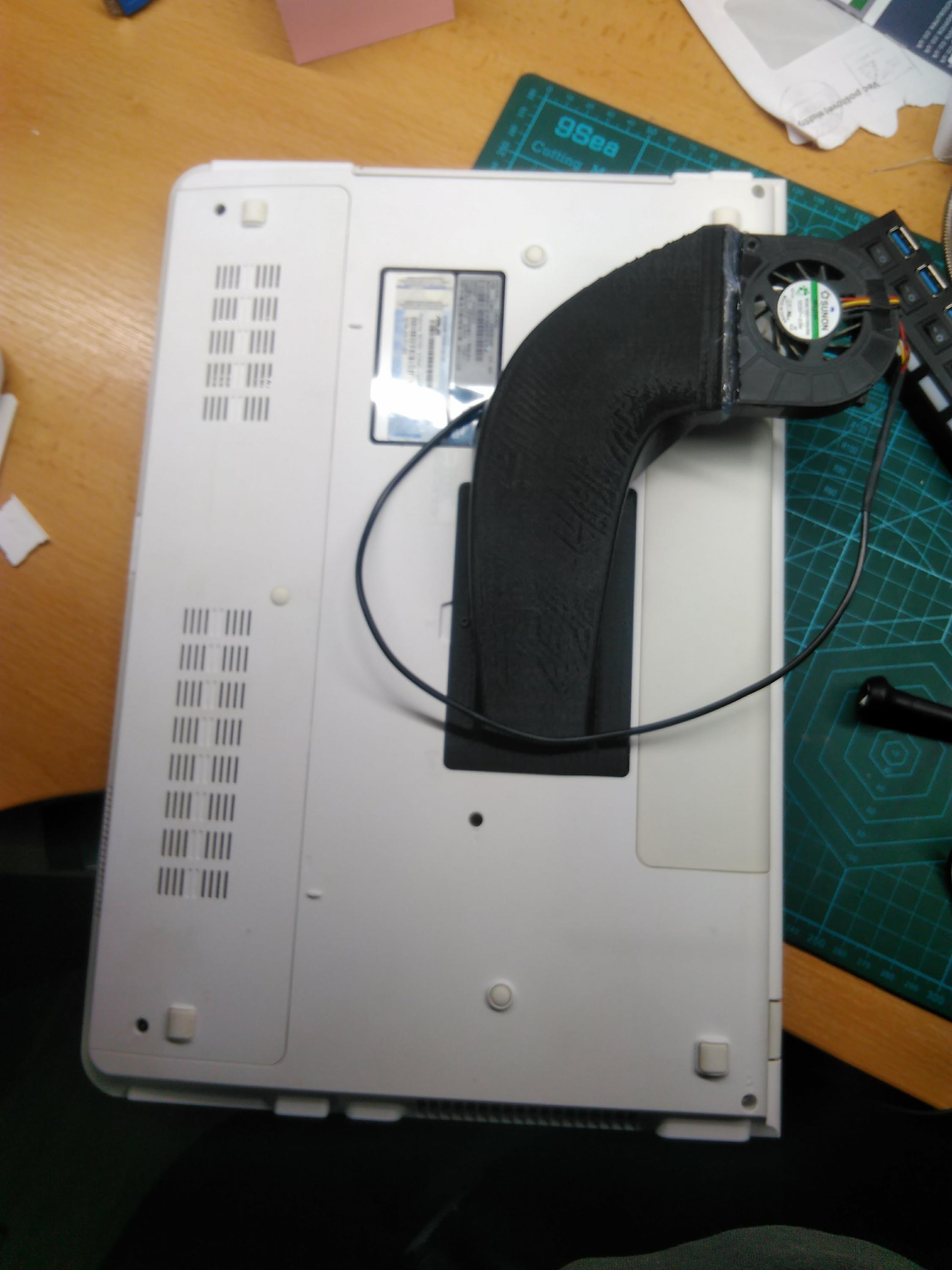

          Is water cooling laptops taboo or something? The laptop i'm water cooling i found at the dump and it has no battery so i'm not concerned about the portability of it. For now i have decided to use the laptop as a platform for upgrades and experiments.

              The cooling in that laptop is as good as can be but of course i want to add water cooling just for the kicks.

                  This is cool idea,i use laptop also as not-portable workstation.After processor upgrade i get little more heat and i upgraded it like you see on the photos.Water cooling? Why not!! I like this idea

                    Well, i did some quick flow tests and according to my calculations my CPU temp should be less than 30C on water, that's full load on both CPU and GPU, assuming 60W combined heat output. I might have to add some cooling to the VRM as well while i'm at it. I get about 500ml through the block in about 24 seconds. That gives me 0.048 C/W, and for antifreeze i just guessed a ballpark figure of 0.1 C/W.
