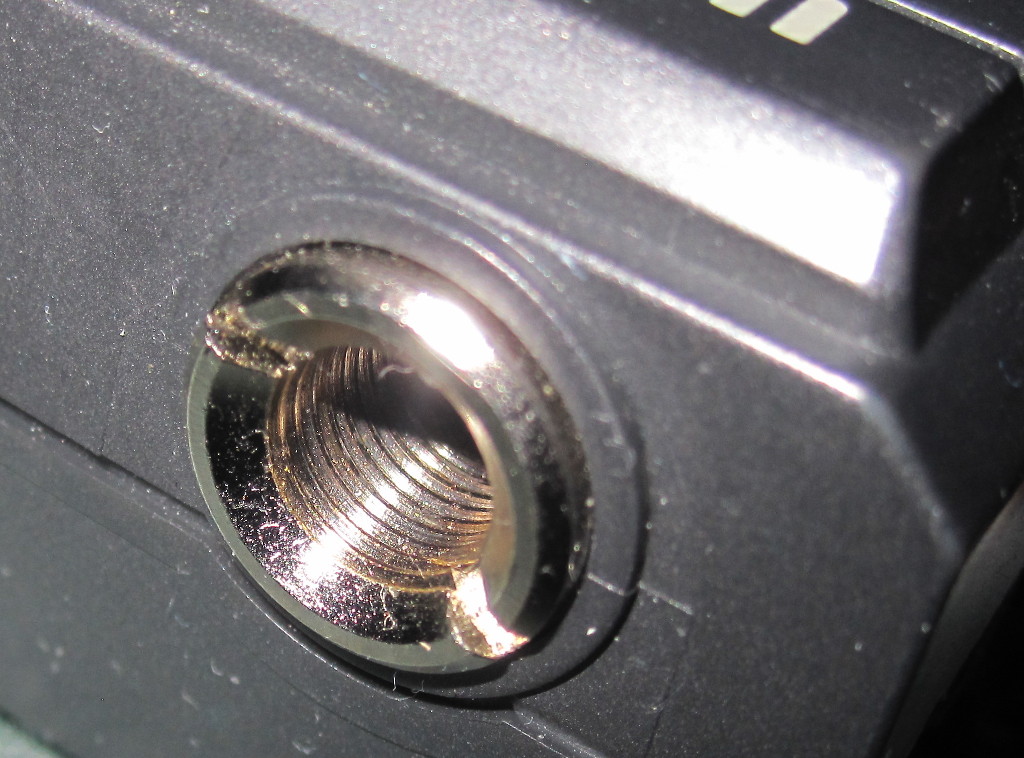

    I have a Uniden handheld CB that's missing an antenna and battery pack. The battery pack is not too big a deal because it also has a standard coaxial power receptacle.
    The antenna is annoying. While it also has an RCA phono jack, using it is unwieldy.
    Now it does have a 5/16" (~8mm) NEF thread (32TPI or ~0.8mm thread pitch) screw mount for an attached antenna. Anyone have ideas of what I could snag that would mesh with this, so it wouldn't be necessary to rethread it?
    (Hmm... I just thought of something, the standard Schrader valve could possibly be the right threadding... might have to look into finding a dead one and gutting that.)

    I might guesing what you mean. Could you post a picture of a socket? Mini-UHF might be close.

        No, that would defeat the purpose, would like for it to be directly attached to the radio. I think I have a couple of those RCA phono plug to BNC adapters, but having an antenna sticking out the bottom isn't quite right.
        Here's the threaded receiver. I suppose this is "HF" - shorter wavelength than shortwave but longer than VHF.

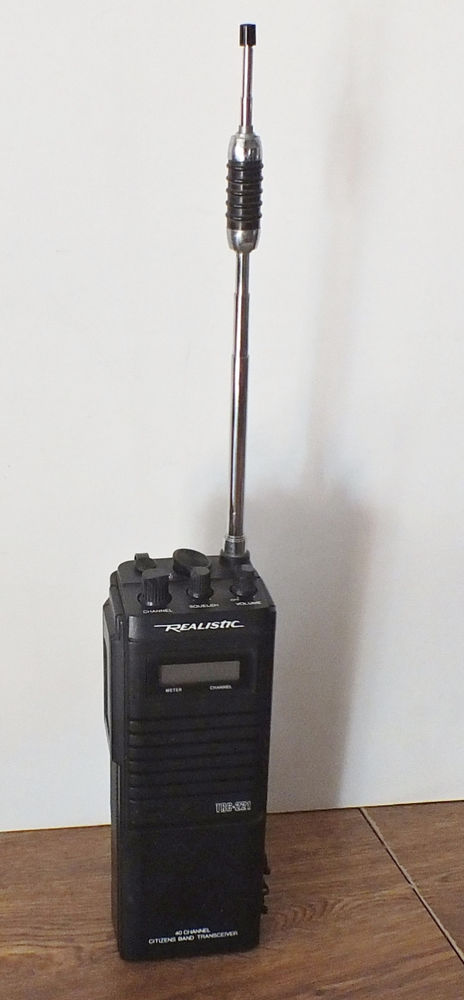

                  The optimal antenna length (1/4 wavelength) for the cb frequencies is 108 inches, not very practical for a handheld, so it would need some sort of loading coil to have it shorter and still be efficient. I remember the RadioShack handhelds used a telescopic center load antenna. The did have a short rubber (about 10") antenna available, I think the whole length was a coil
                  Not sure if this is any help.

                          I thought standard pots were 3/8"? I grabbed a nut off of one of them and tried to mesh it against one of my car's tires (which I believe is the correct 5/16" 32TPI) and alas it's too big. The hole is visibly bigger than the receptacle in the radio. Was there also a standard 5/16" pot? Might be a mini pot or something which I don't have any of as far as I know; I'd have to sacrifice it too...

                            Re: Homemade Uniden CB antenna replacement
                            I'm not 100% sure if it is from a pot, switch or jack, I have a few in the shaft nut drawer
                            If a Schrader valve fits that might be the easiest, that seems to be a unique thread
                            That picture looks like it is a much coarser thread

                              hold on, if it's japanese the thread will be metric.

                                It quite possibly could be metric indeed. However it seems to mesh with 32tpi SAE thread feeler and both NF and NC (28 and 24 TPI respectively) do not mesh. A 6-32 screw meshes fine too, at least it looks like it holds flat against the wall as far as I can see.
                                I found that my air compressor screw-on blow gun nozzle tip will thread into this thing. And a Schrader valve cap will thread onto the blow gun nozzle!
                                I wonder if there are any other common things that will thread onto a Schrader valve cap?
