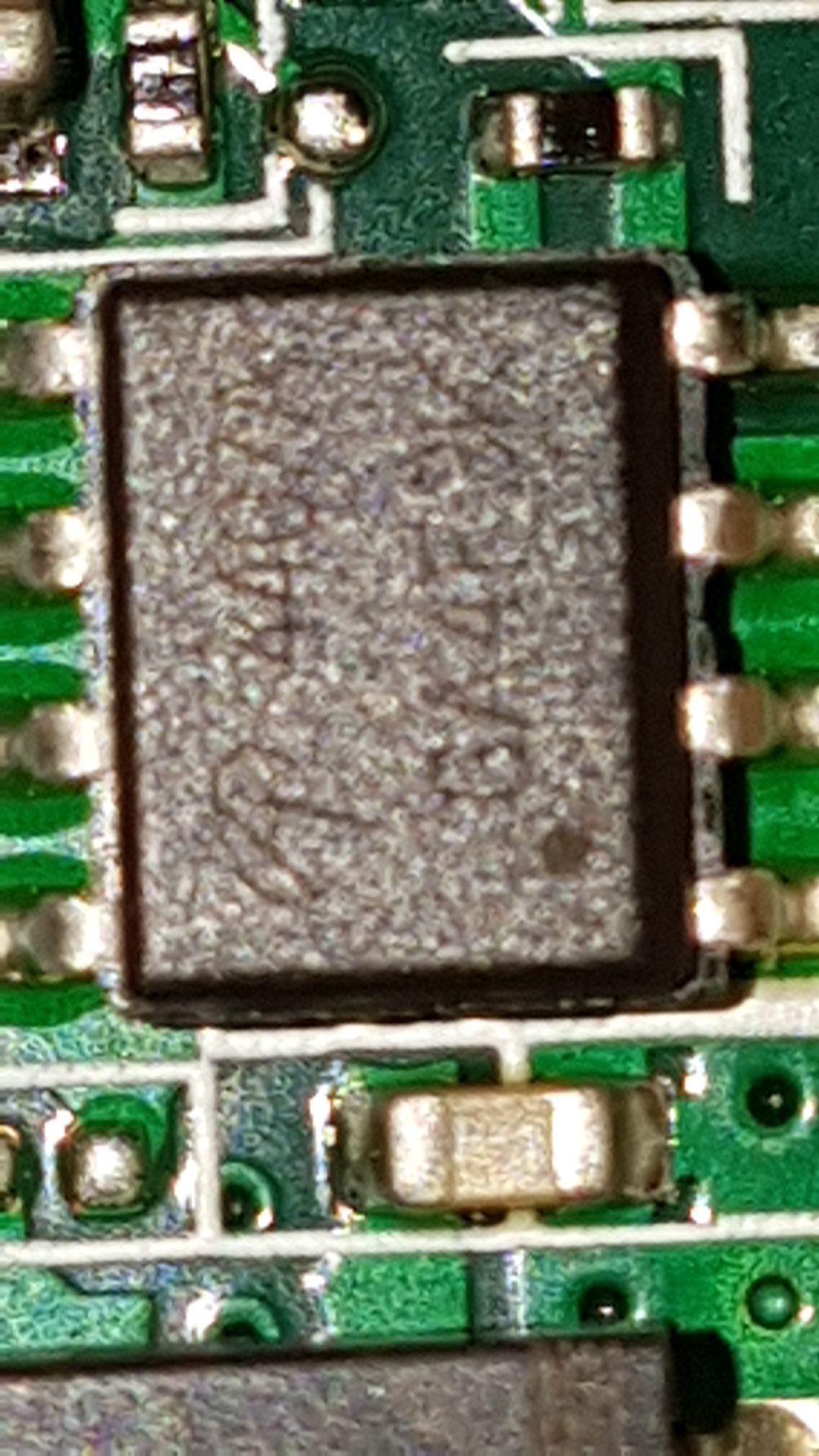

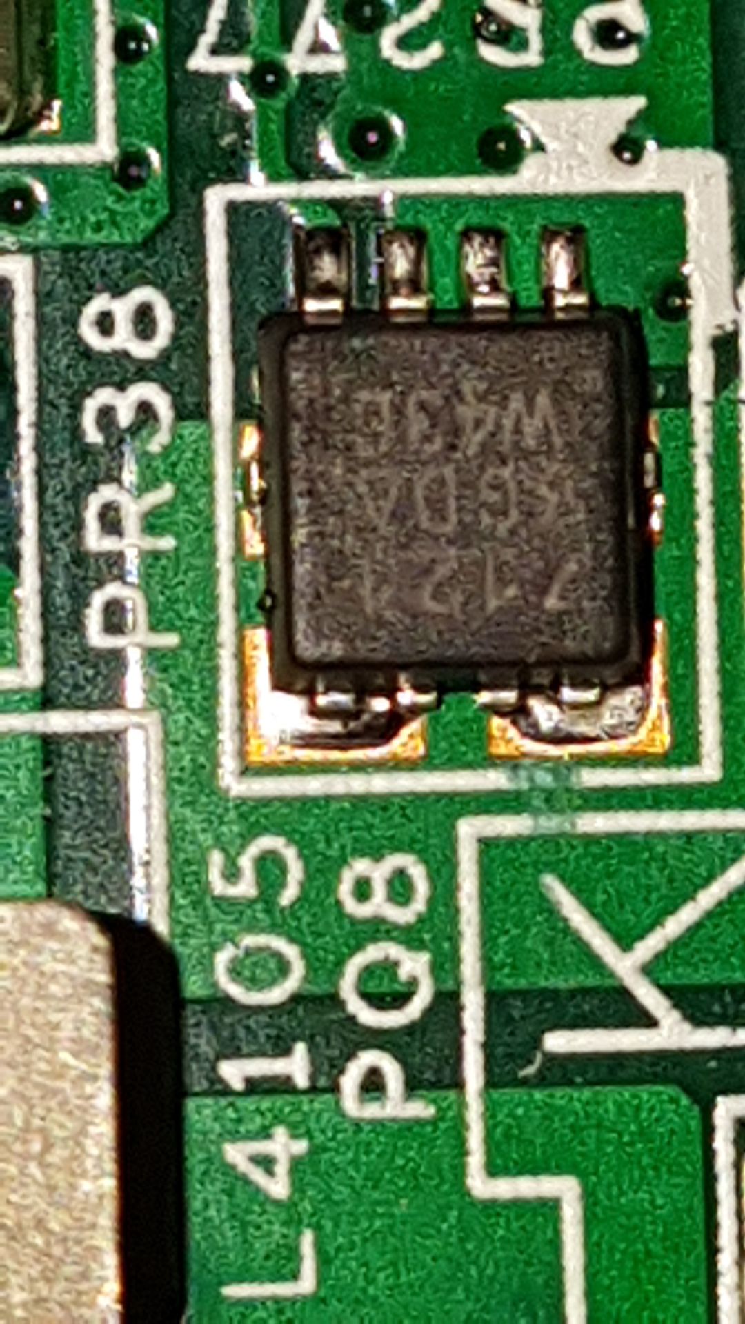

Hi Guys, anybody able to help identify the Mosfets as pictured, i havnt been able to find anything on the net, the quality isnt great unfortunately so when searching i might not be entering the correct info, lol, many thanks
Need help to identify components please
Re: Need help to identify components please
The first one is AO447A, the second looks like 7121, one of these perhaps ? http://uk.farnell.com/vishay/si7121d...212/dp/1684060

diff, thank you so much for your help, greatly appreciated, thank you also for the ebay link, i will most certainly take your advice and purchase one, cant complain about the price, lol. Happy New Year and many thanks again for your help.Comment
