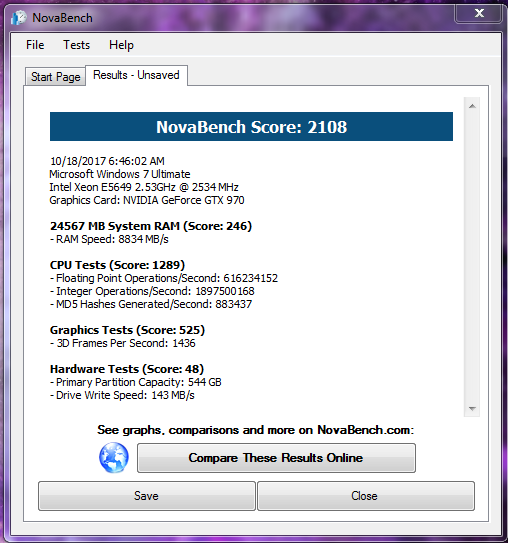

      Re: Ratdude's Main Rig V6
      Worked late, too tired last night. No pics yet.
      But, I did have an old copy of novabench on my server, so here's a classic novabench:

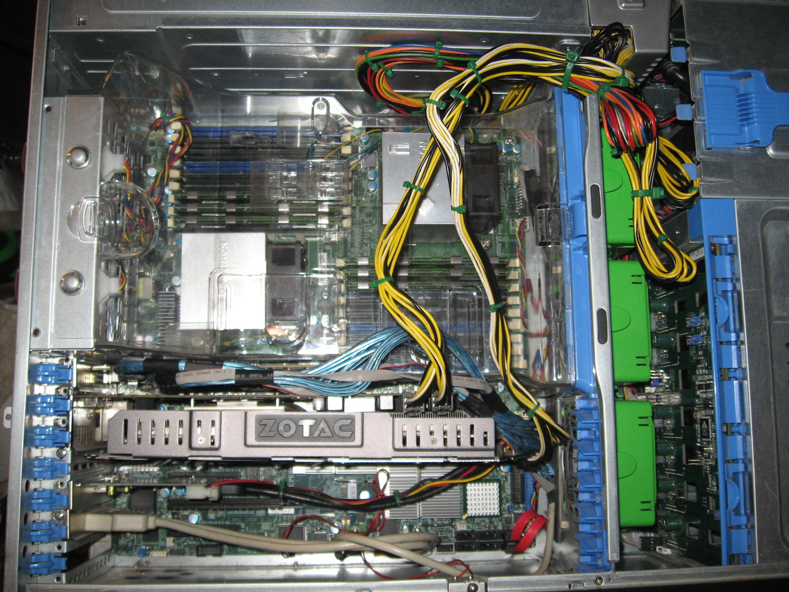

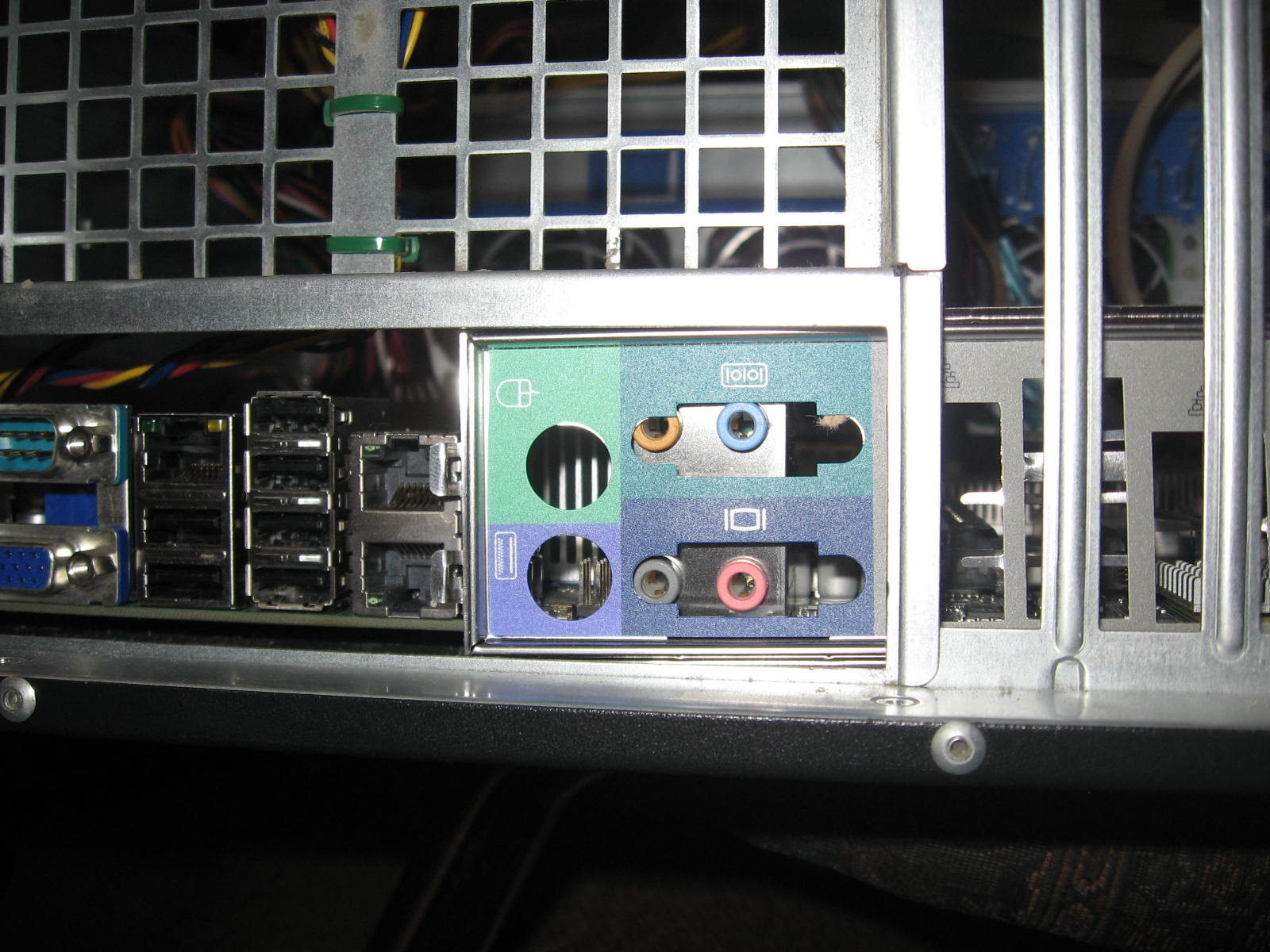

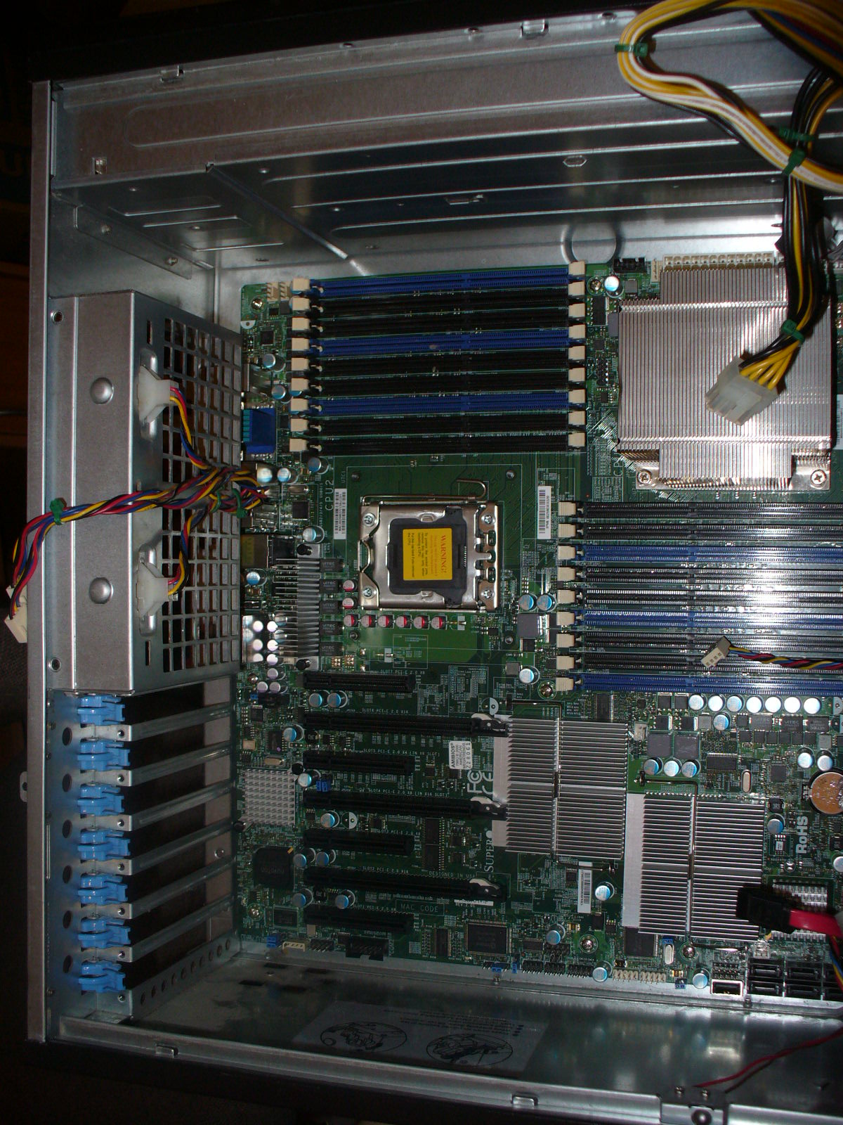

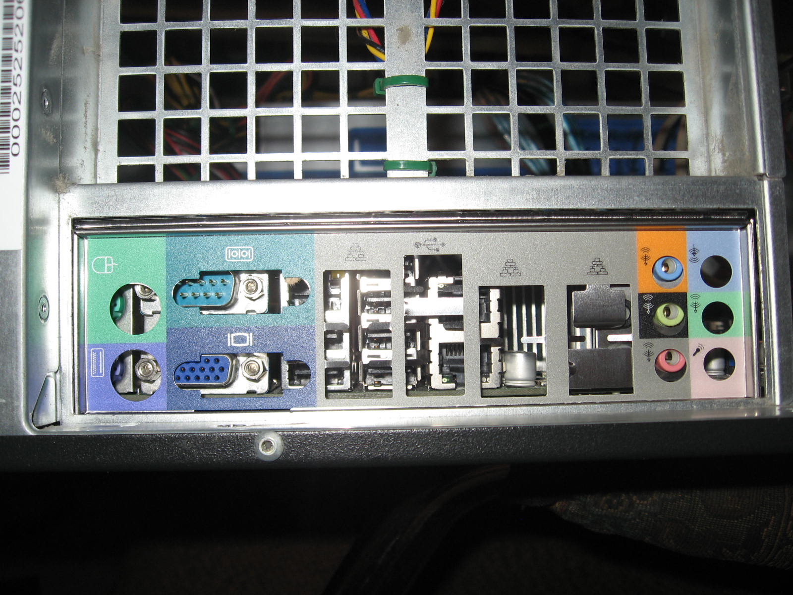

        Picture time:
        Initial fitup testing: She fits!
        Note the extra 35mm or so of extra board above the I/O shield area. That's what makes this board special; it's enhanced extended ATX. The only cases I've seen with appropriate provisions out of the box is Supermicro tower/4u convertable units with modular slim PSUs (like what I have) and some supermicro rackmount servers (actually where most X8DAH___ boards seem to come from, ironically enough). It uses a somewhat different standoff pattern (which uses the larger footprint), so retrofitting these into other cases might be, ahem, "interesting"
        Final build pictures:

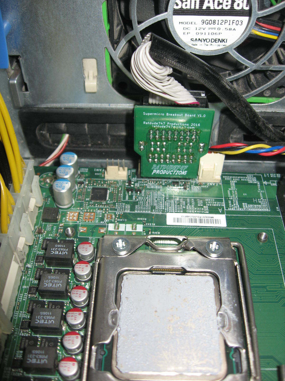

        Just for laughs, I put in one of my breakout boards:
        Last time I ordered PCBs from china, I ran 10 of them, and bought parts to build up 3. Just in case I ever want to re-purpose my HDD LED, now I can.

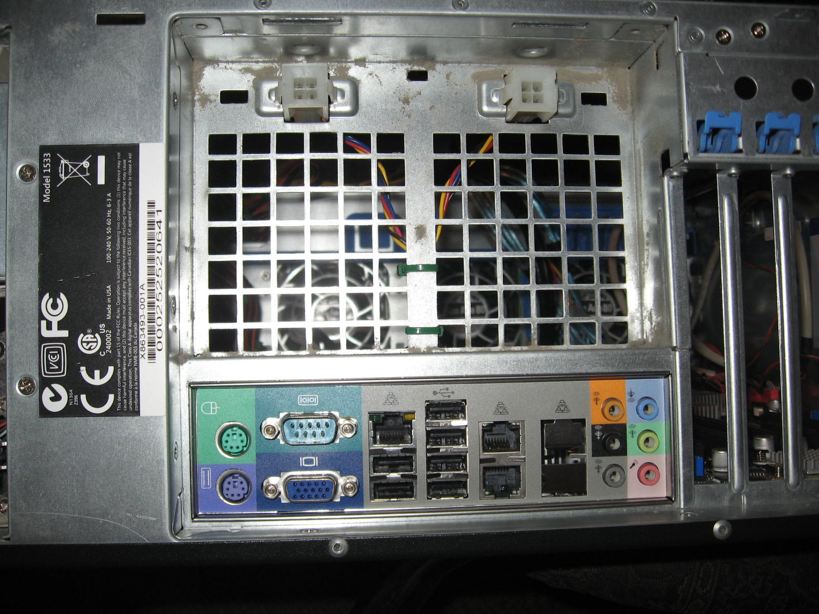

        One issue is I didn't have an I/O shield with the board, and removing and installing the mobo in this system is a massive PITA (mainly due to the SAS cables, more on that later). So, instead, I unscrewed the board, and did this to sneak in the shield:

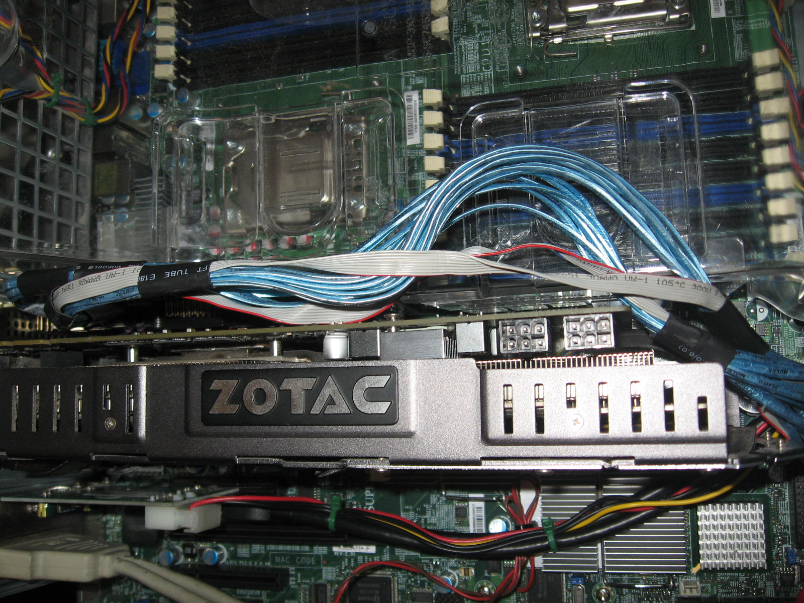

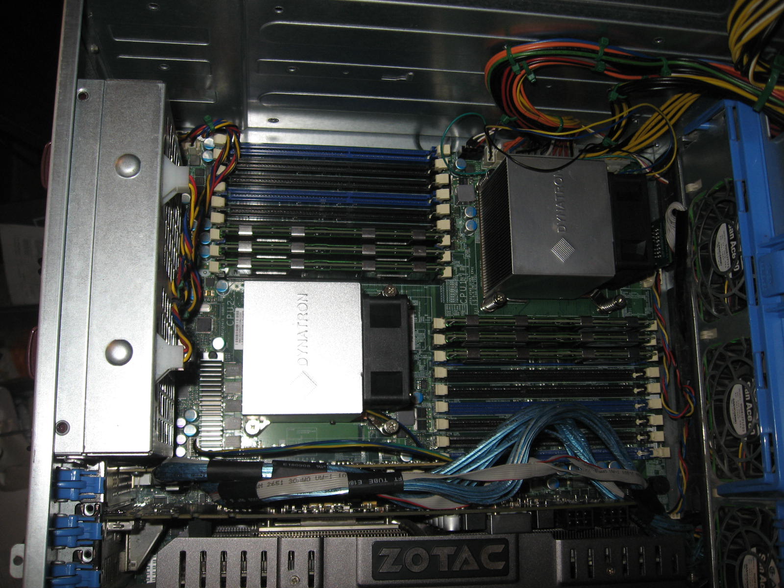

        Now, about the SAS cables. As shown in other threads, the SAS backplane connections are a ship in a bottle to deal with, and the sidebands in particular are a pain due to the ends being slightly shorter than the SAS cables themselves and the sideband connectors on the backplane are slightly away from the SAS connections. As a result, I had to do this to make the sidebands reach:
        Why SM didn't use a mini SAS instead of separate sideband and SAS (SATA) plugs is beyond me, although I've seen other companies do it too. I think it's stupid, to be honest.

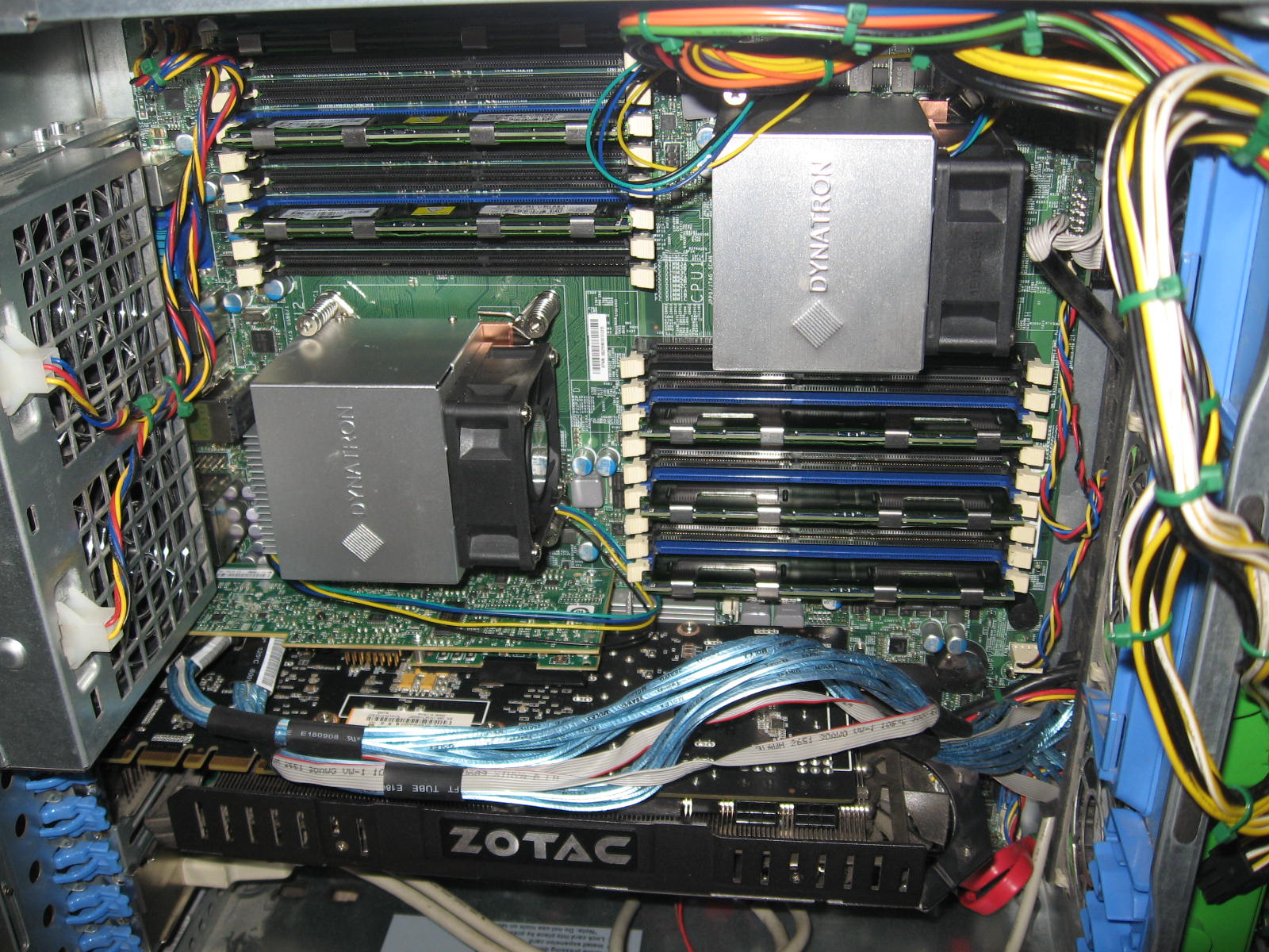

        CPUs, coolers, and RAM installed:
        Duct installed, everything ready to go:
        Looks good? Well, there is a problem. If you read my mess of posts above, you'll see that ding dong over here skewered the RAM, putting everything one one channel, not split between channels. As a result, the speed was dropped (a clue I missed) and I even got an ECC error out of the blue. Here is how it should have been:
        No more ECC errors, RAM shows as triple channel at full speed.
        One other gremlin I had to deal with was that the onboard graphics are always default, unless one disables it with a jumper. Was the cause of a lot of confusion during initial testing.
        The LSI setup was "different", but once setup all is good. Runs fast enough, and has a much quicker boot time than the adaptec in V5.x.
        So far, so good... Jury is out on the BBU, but I do have a spare if issues come up.
