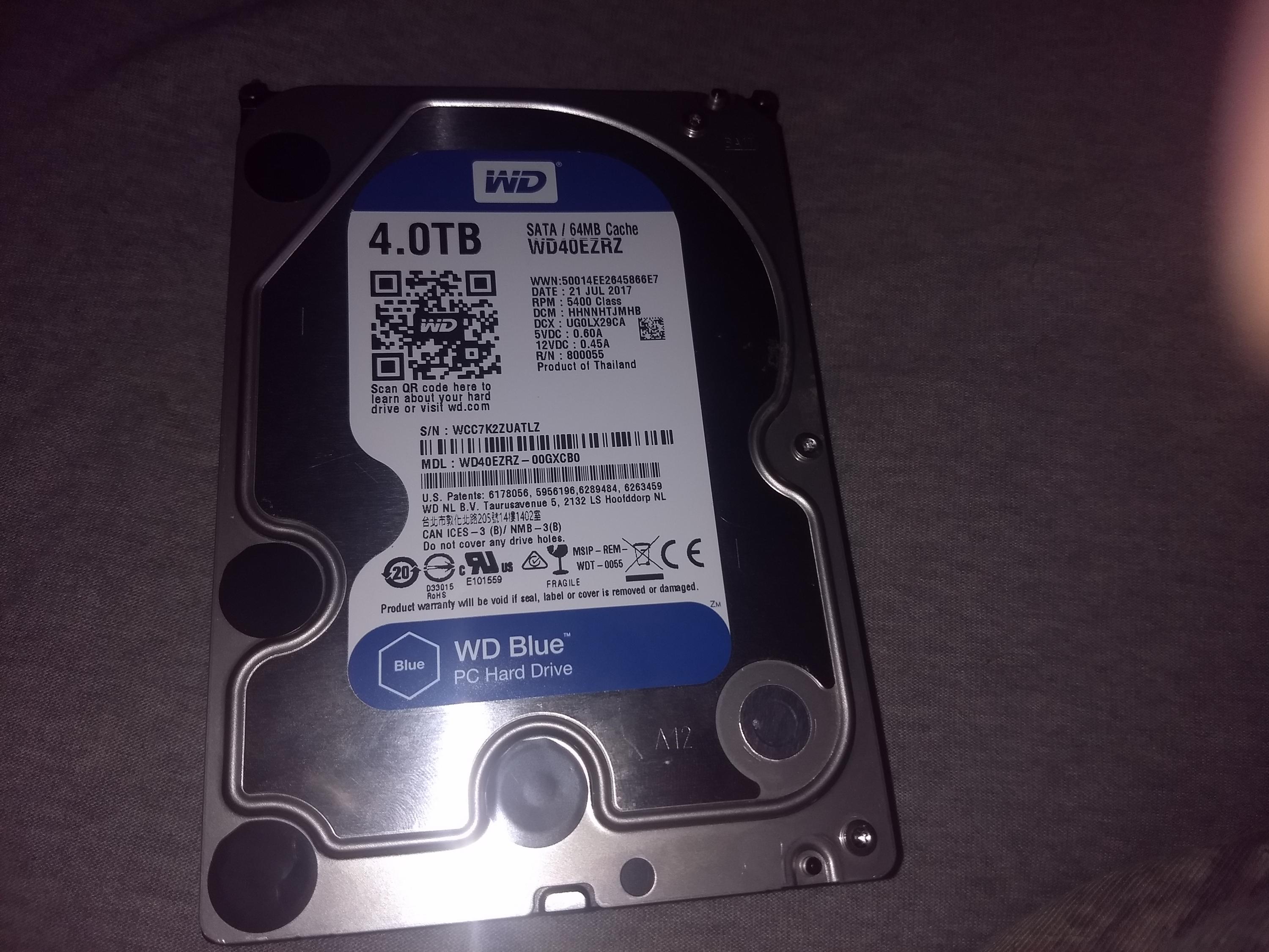

                        Here's a real turd. Or maybe bad luck. I'm not sure. Its a product of what i like to call the WD "Turquoise" line. Where they merged the green line into the blue line of drives.
                        Model Family: Western Digital Blue
                        Device Model: WDC WD40EZRZ-00GXCB0
                        Firmware Version: 80.00A80
                        User Capacity: 4,000,787,030,016 bytes [4.00 TB]
                        Rotation Rate: 5400 rpm
                        3 Spin_Up_Time POS--K 209 186 021 - 4533
                        4 Start_Stop_Count -O--CK 100 100 000 - 14
                        5 Reallocated_Sector_Ct PO--CK 173 173 140 - 794
                        7 Seek_Error_Rate -OSR-K 127 013 000 - 3107
                        9 Power_On_Hours -O--CK 100 100 000 - 41
                        194 Temperature_Celsius -O---K 125 117 000 - 25
                        196 Reallocated_Event_Count -O--CK 145 145 000 - 55
                        197 Current_Pending_Sector -O--CK 200 200 000 - 12
                        It was online less than two days before my RAID controller kicked it offline for IO errors. First error is 543096832 bytes in...
                        Never buy the 5k RPM blue line of drives.
                        The worst part about it, i was trying to salvage a failing array so the first thing i did was go down to Walmart and buy an external drive to pull the drive out of, instead of having one shipped, so no warranty for this thing....

                              bad luck i guess. if the drive was sitting on the shelf instead of behind the counter, it may have gone through lots of fiddling and moving around with and someone else could have dropped the drive and put it back. and after a few days of power on, bam... PHAIL!
                                Given the bad sectors so early in its life, most likely some parts of the magnetic media on the platters is marginal and probably needs to be mapped out. Similar to CPU and GPU binning, HDD platter binning probably works in a very similar way - i.e. if for example, an HDD of 1 TB with 2 platters and 4 heads (250 GB per platter side) has lots of defects on only one side of one of its platters, the manufacturer may just remove the head for tha platter and disabled it in firmware, effectively making the HDD a 750 GB one. If another platter has problems, they may even bump it down to 500 GB or even 250 GB.
                                So in essence, the platters in your HDD probably passed the factory tests enough to qualify as capacity X, but over time turned out to be unstable and the drive really should have been marked down as a lower capacity (or just junked altogether).

                                    #57
                                    Re: Hard drive reliability
                                    Thus, I only see this ending two ways: either the drive is going to reallocate some (or lots of?) sectors, then "settle down" and play nice -OR- it will reallocate until the whole drive is dead/useless and/or not detecting.
                                    To get that process going, my suggestion is to perform a zero fill once. This should hopefully find all bad sectors that need finding, and then the HDD should either remap them or leave them as bad. After this, do a normal read/surface scan with HDTune and look where the bad sectors are. Take a screenshot and then re-run the scan. If the bad sector map stays the same, you can either format the HDD into partitions around the bad blocks (if they are fairly large and clumped together), or use the HDD as is, if they are all over the place, but not changing (if they are, the drive is useless). But if the bad sectors keep increasing every time or appearing in different areas from before, then no point in further trying to do anything with the HDD. (Actually, even this is probably too much for most people. But given it's a fairly big 4 TB drive, it might be worth a shot to keep around as an OS test drive. At least I would )
                                    As I've mentioned before in this thread, a good number of my drives have at least a few bad sectors (some even several hundred!) But as long as the HDD settles down and the bad sectors stop increasing (or just do at an extremely slow rate), you can still get life out of that HDD.
                                    The PC (laptop) on which I am typing this post from has a 20 GB IBM Travelstar with 5 bad sectors (though some of these might have resulted from a bad connection, as the drive also has 26 in the UltraDMA error count). I've been using it like that since 2010! And I'm not even its first owner - the HDD is probably from the very early 2000's. It's also 97% full at the moment - i.e. most of its sectors are in use with my data. Do I trust it? - After 8 years, I can safely say, yes - at least more than any new HDD from today.
                                    Ive tried zeroing it. It fails in the same spot as the RAID controller reported.

                                      Originally posted by goontron
                                      Here's a real turd. First error is 543096832 bytes in...
                                      At sub-1GB! WTF! And dd only recorded a paltry-for-even-a-dozen-years-ago 40 MB/s!
                                      Looks like a steaming pile o' dogshit!
