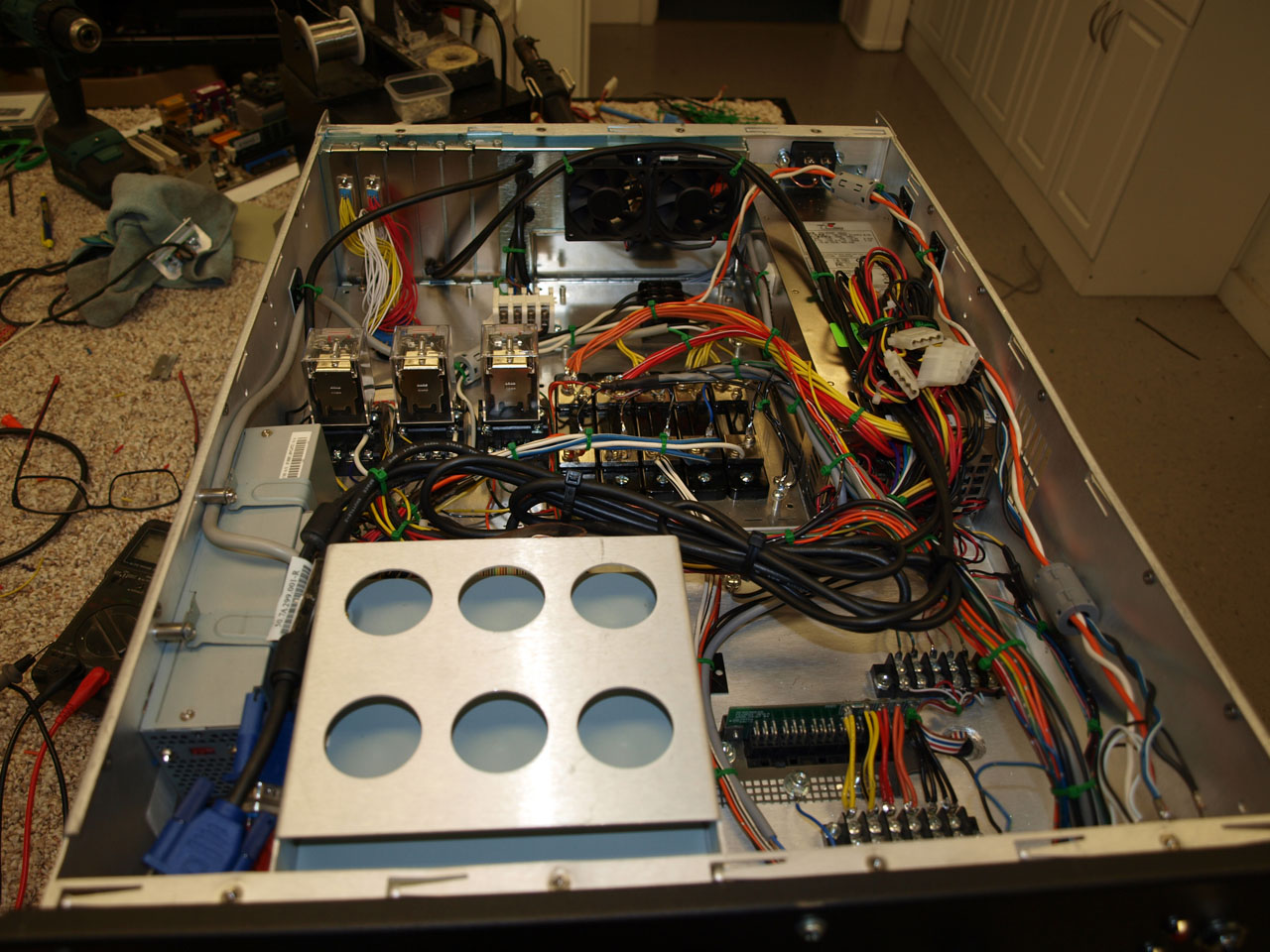

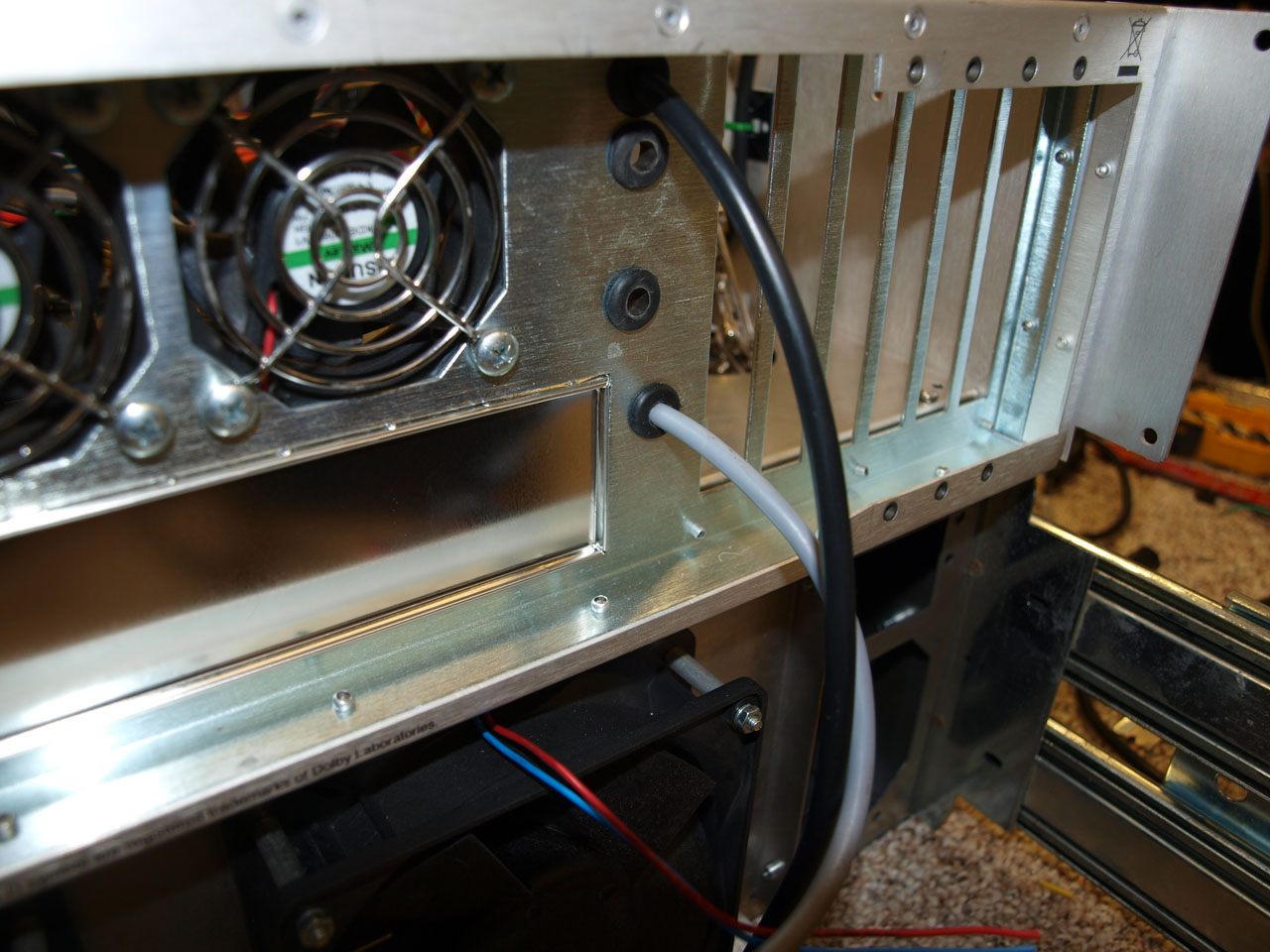

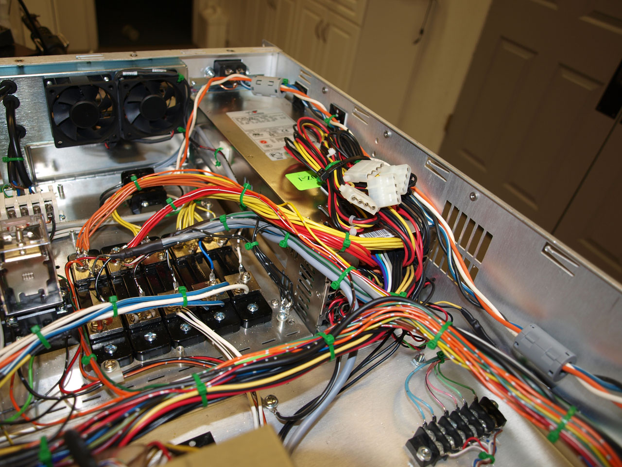

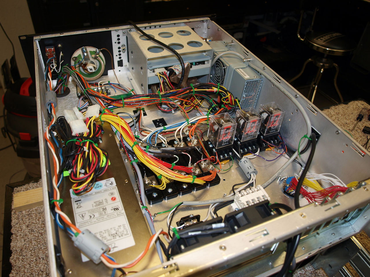

        Good time for this thread to have turned to a new page! Pic heavy today as wiring has been completed. It was every bit as daunting as I expected....it's probably why it sat so long from then till now....I knew what I had gotten myself into....but here we go!!

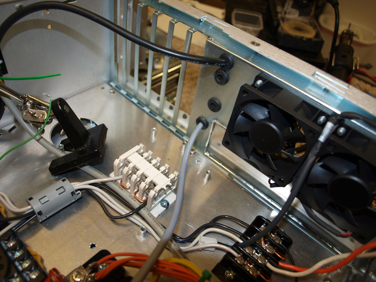

        Hole poked in the back of the lower section for the test bed bay fans, grommet, and wire.
        Attached.
        Tidied up.
        Wired to the rheostat.

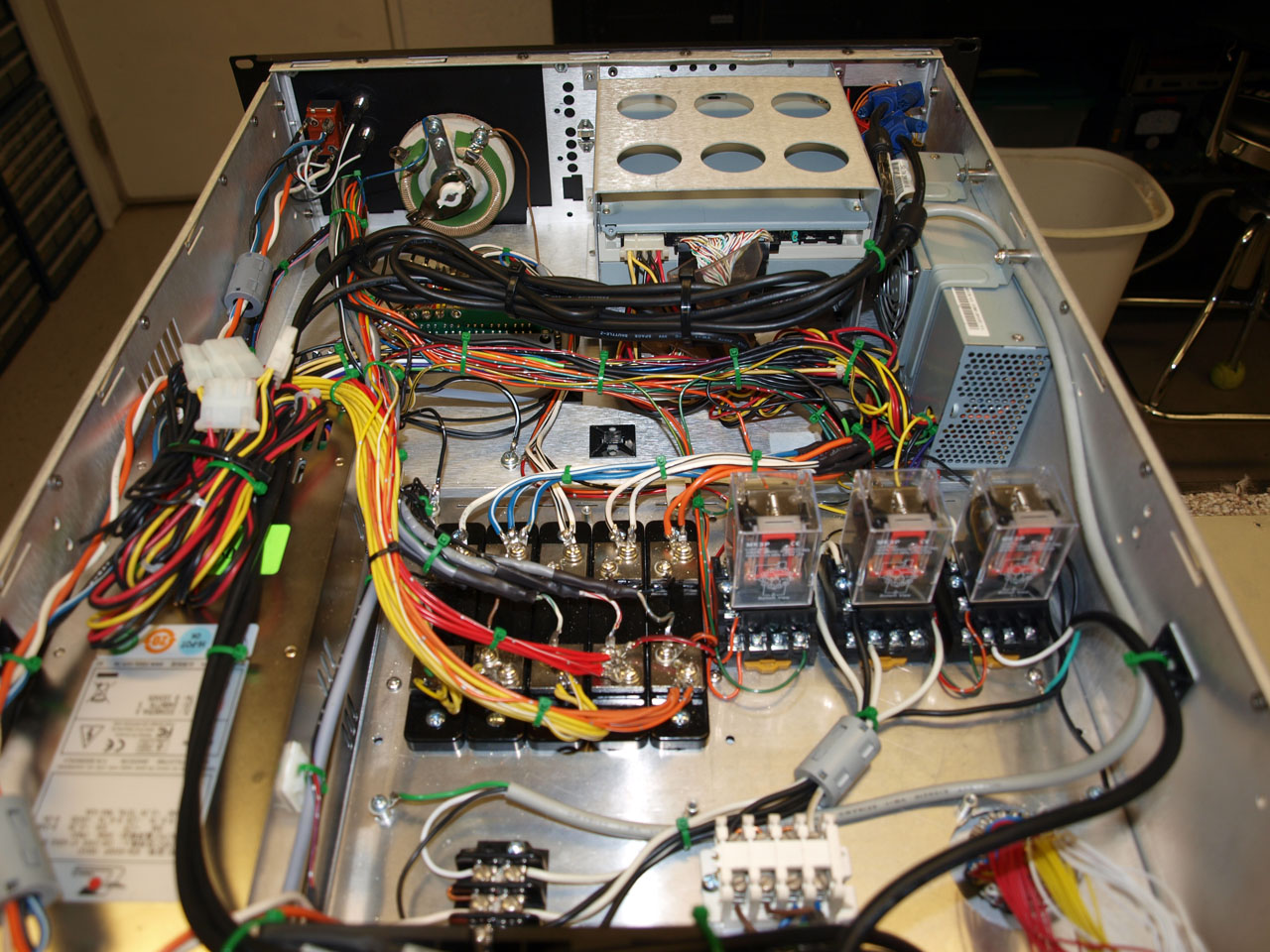

        Wiring completed and tied up in rough and relays installed. I'll do a final cleanup when it's 100% finished....but today was a huge step in that direction!
        Extra plugs....just incase I add something later.
        Moment of truth!
        First live test was performed with no motherboard. This test was to verify voltages on the TPU output; as a lot of modifications were made to its harness....needed to make sure no mistakes were made that would result in magic smoke. All voltages present & accounted for. That cheater plug will trip the power_on for the PSU when plugged in. I also developed an override for ATX soft-on, mainly for testing AT style boards.....
        2 lights, good sign and no snapped breakers!!

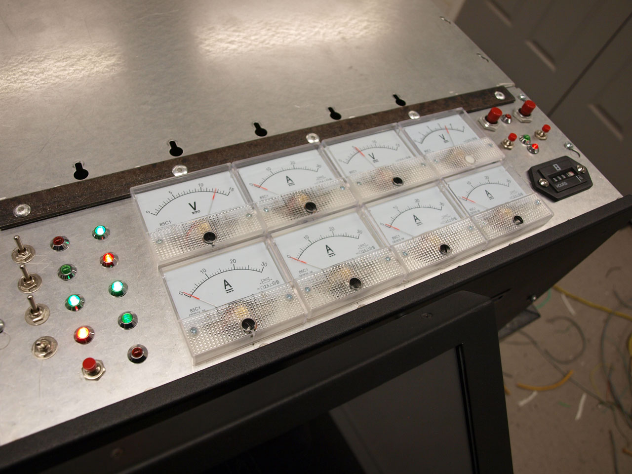

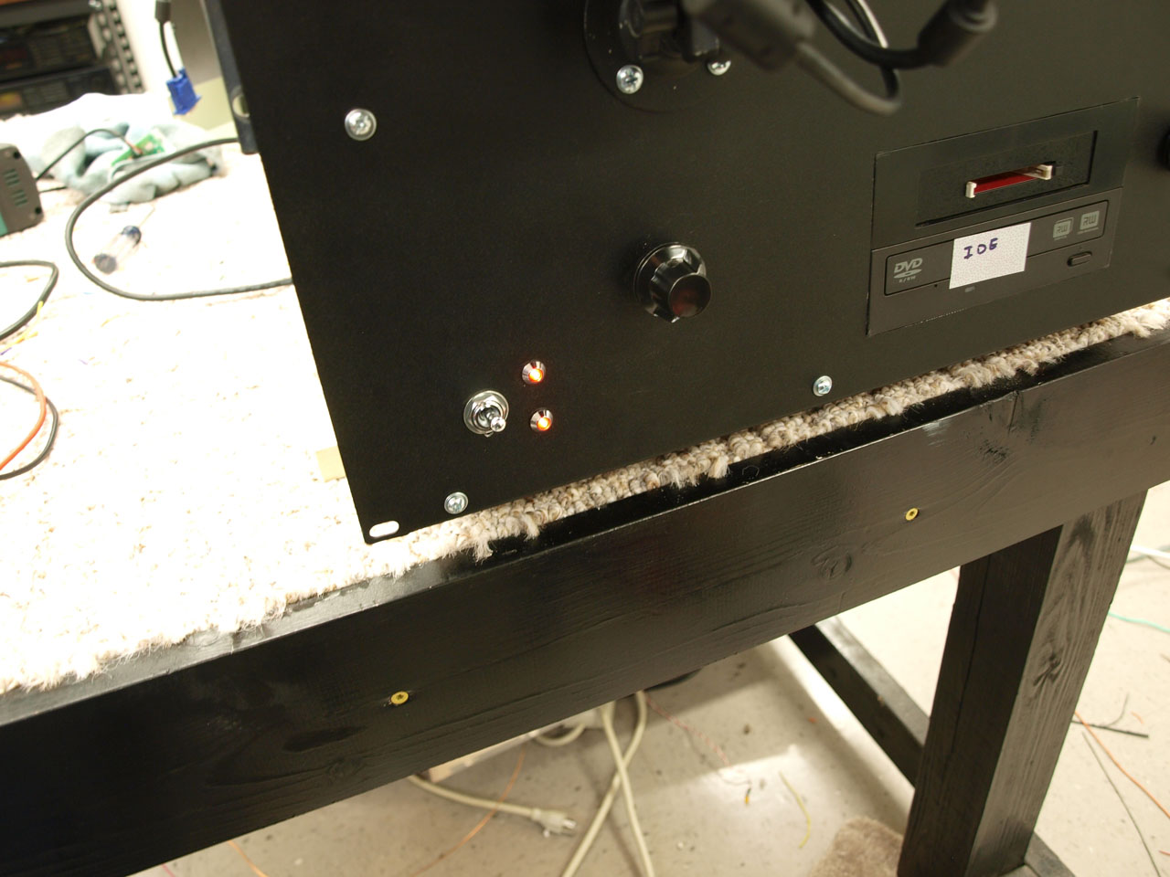

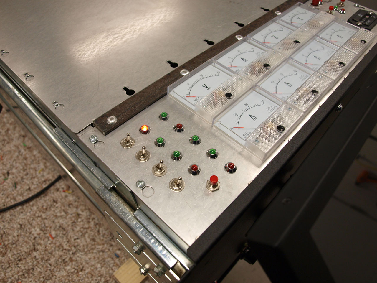

        All switches off, red lamp indicates IPU has standby power. Switch 1 (top-most) turns the IPU on.
        Switch 1 on, IPU powered up as expected. Since the 'cheater plug' was not connected, I turned switch 2 on; which is the ATX override, which turns the TPU on with nothing connected (or an AT board that has no soft-on). The red lamp indicates it's in override. The override control is powered by the IPU, this will function even if the TPU is off; which leads us to switch 3, which powers the TPU.
        The 2 lamps next to the switch indicate the presence of -5v and -12v. The two lamps below that are TPU status. The illuminated red indicates standby, the green indicates PSU is ok. It will go out and the red below it will go out if the PSU reports an error, and start screaming. The red button next to the red lamp silences the alarm.
        There was only one known glitch, the TPU standby is supposed to go out upon powerup....it does not. I have to check my wiring.....but all things consdered, this is very minor. You can see it in the pic....the red standby lamp next to switch 3 should be off with the TPU on.

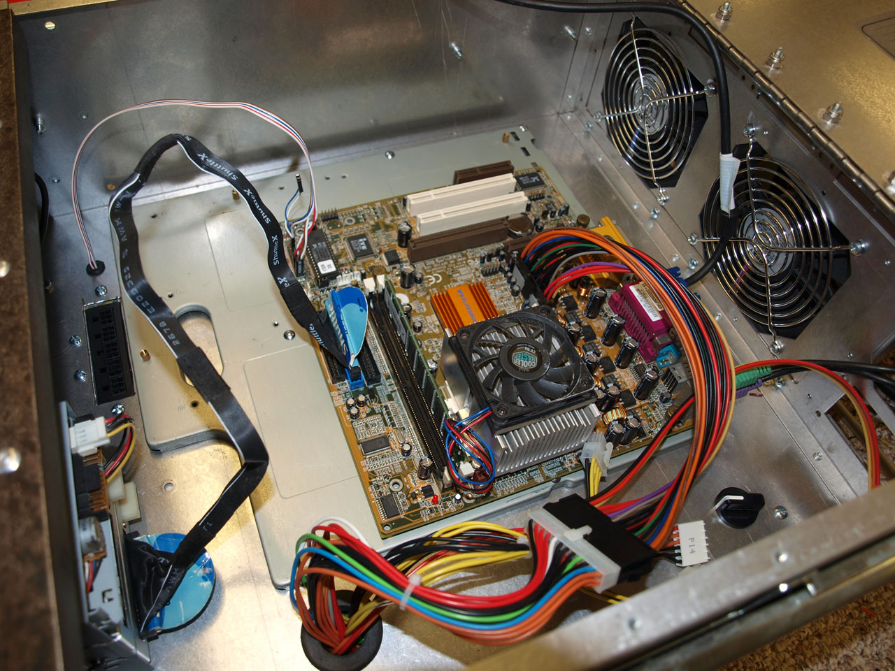

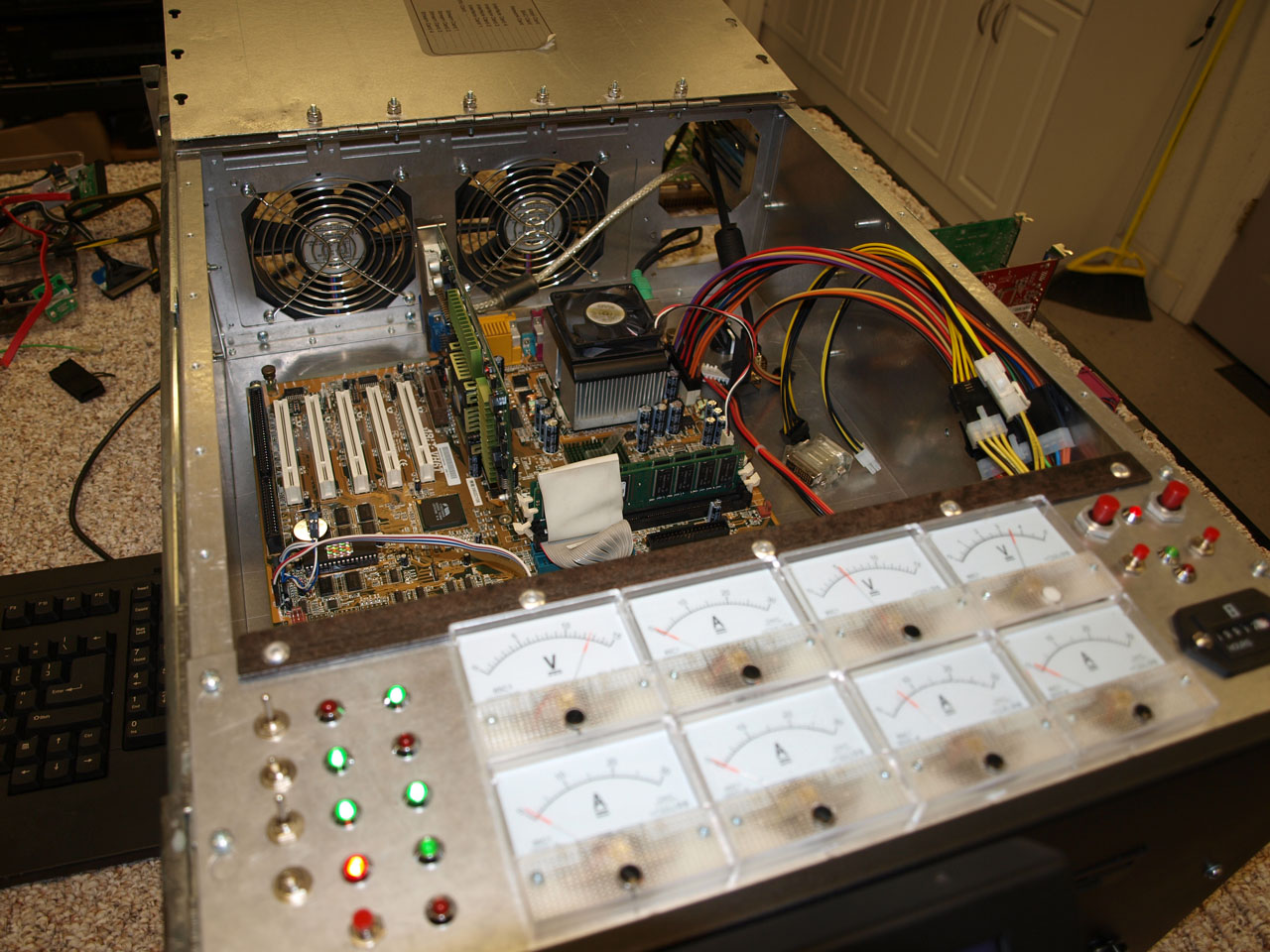

        Now to test with a motherboard....a junky old socket-a.....lab rat.

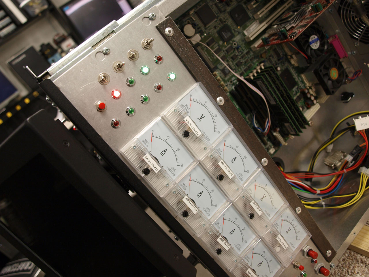

        Alive! Meters are in rows, 1-4 are the top; left to right. Bottom row is 5-8.
        Meter 1 = +12v ATX rail
        Meter 2 = draw on the 4/8 pin +12v EPS
        Meter 3 = +5v ATX Rail
        Meter 4 = 3.3v rail
        Meter 5 = draw on the 20/24 pin +12v
        Meter 6 = draw on the PCIe +12v
        Meter 7 = draw on the 20/24 pin +5v
        Meter 8 = draw on the 20/24 pin +3.3v
        ...and here it is!! It's pulling 10A off the +5v rail, as expected for something of this era. Pulling nothing off the 12v rail. A few amps off the 3.3v.
        The clock is running!!

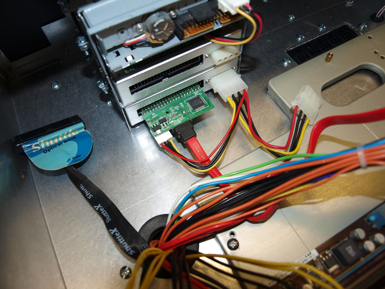

        Lets step it up a little.... Athlon FX4100 board.
        Here's the answer as to why I only had IDE interfaces....
        Adapter!!
        The shroud interfered with the housing, so I simply removed it from the shroud.

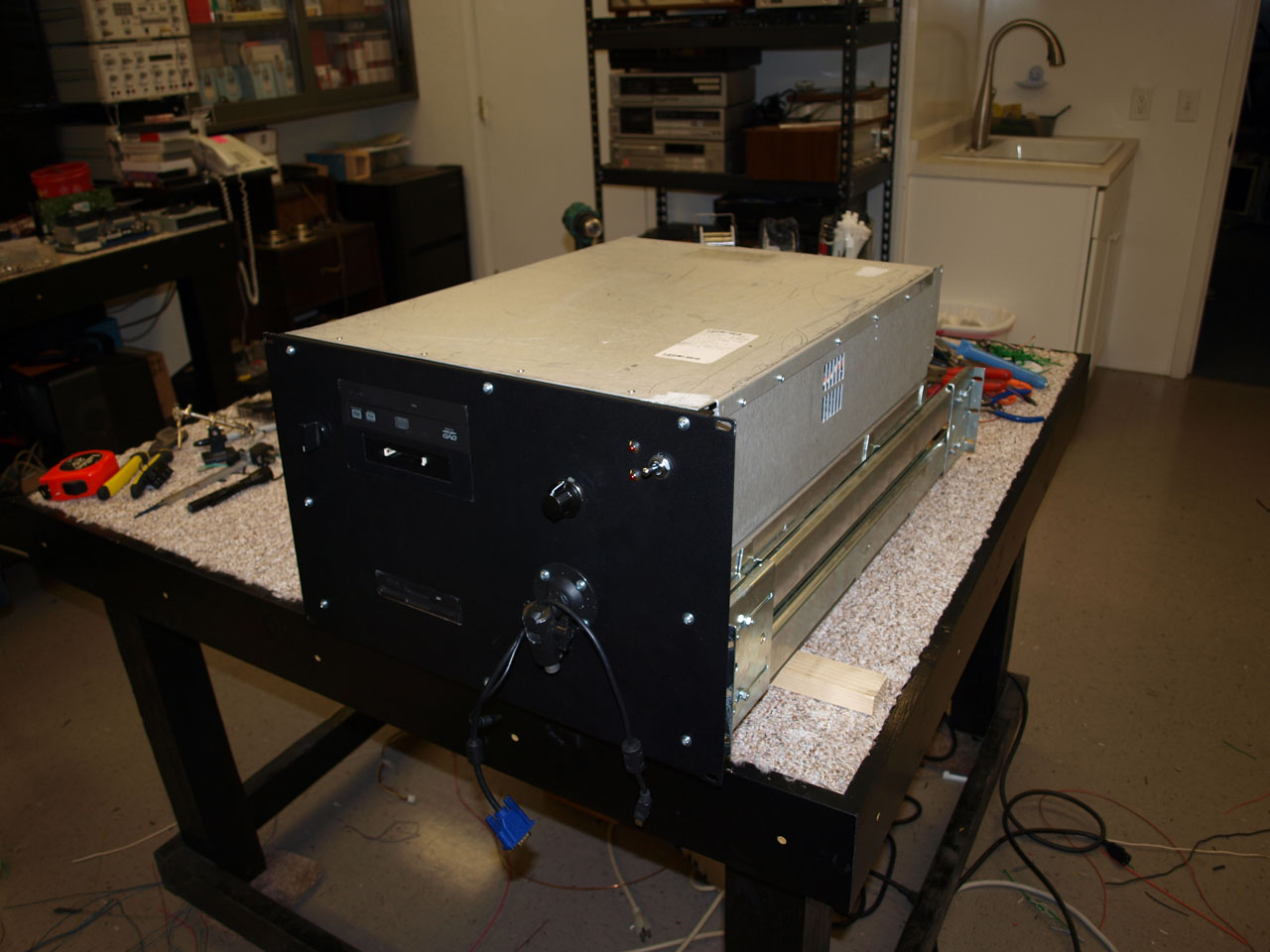

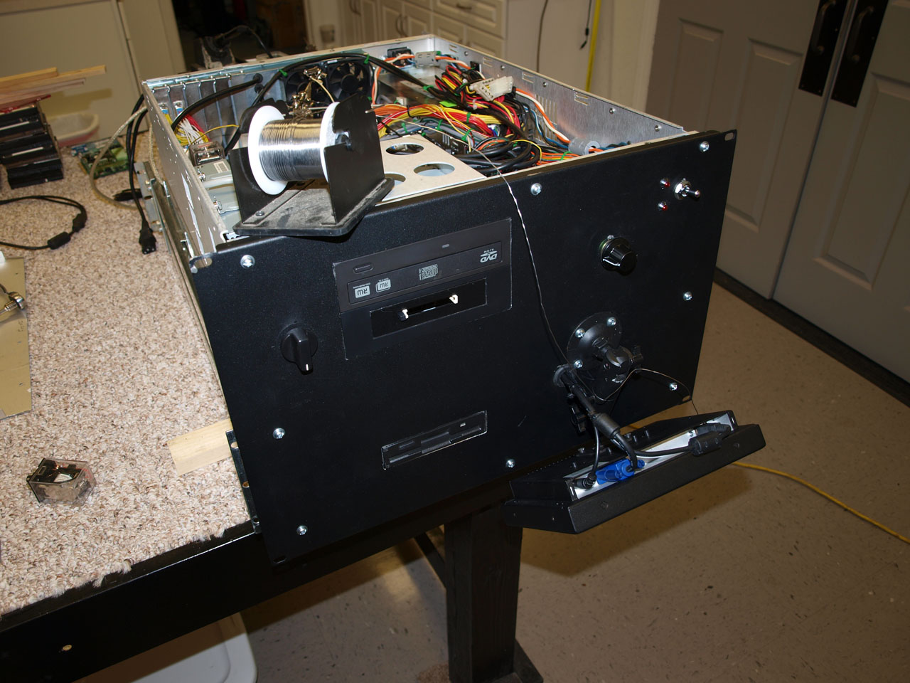

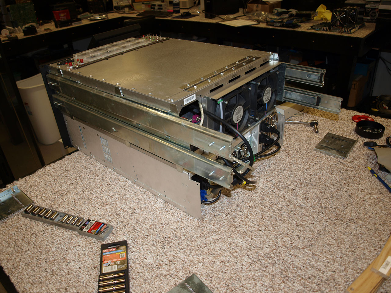

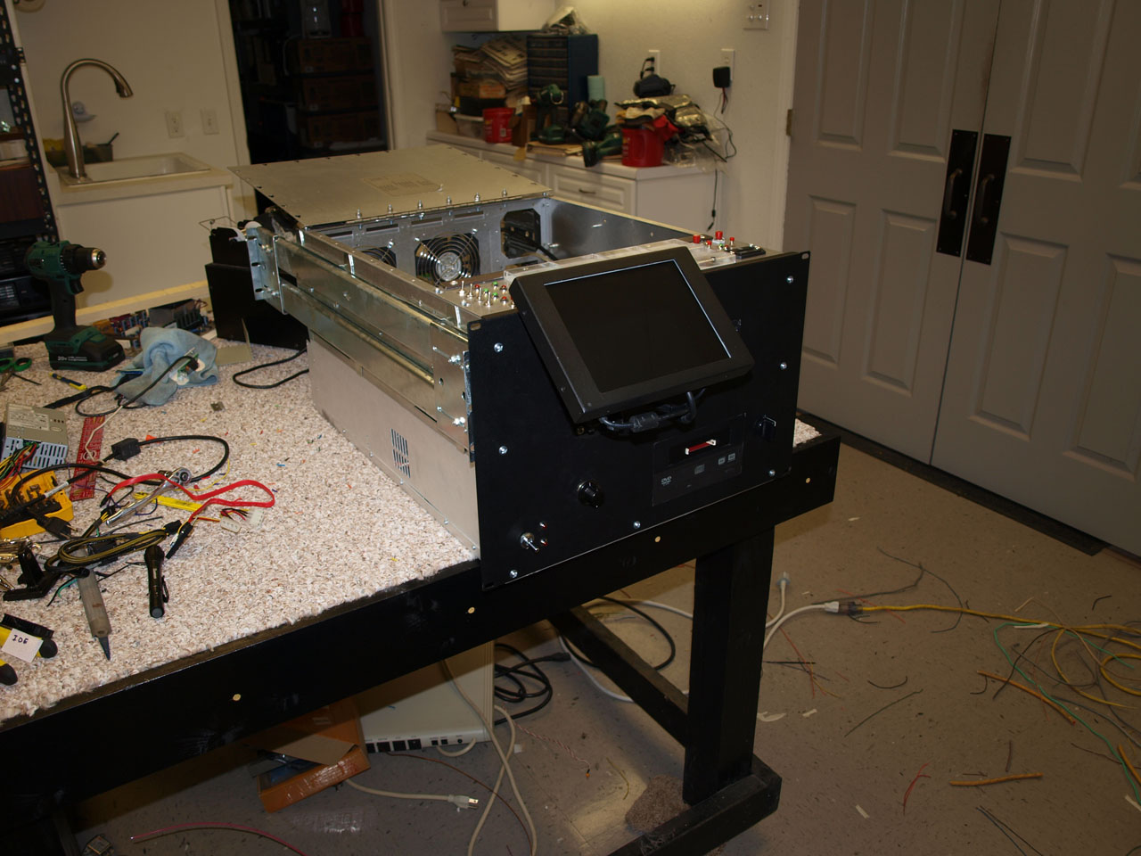

                  Time to button up the high voltage section....which means all the transfer switch connections for VGA need to be completed..... There was no real pretty way to do this, but thankfully they're out of sight. Enjoy the view, because unless something majorly fails, this should never need to be opened again!
                  The Sub-D connector in this shot is for the external display. It will have to be used with a gender changer and additional cable. No biggie.

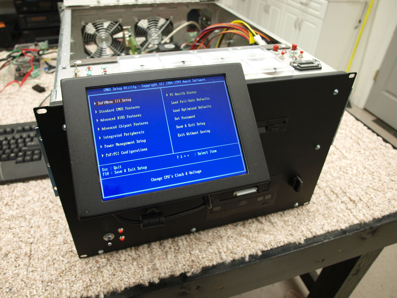

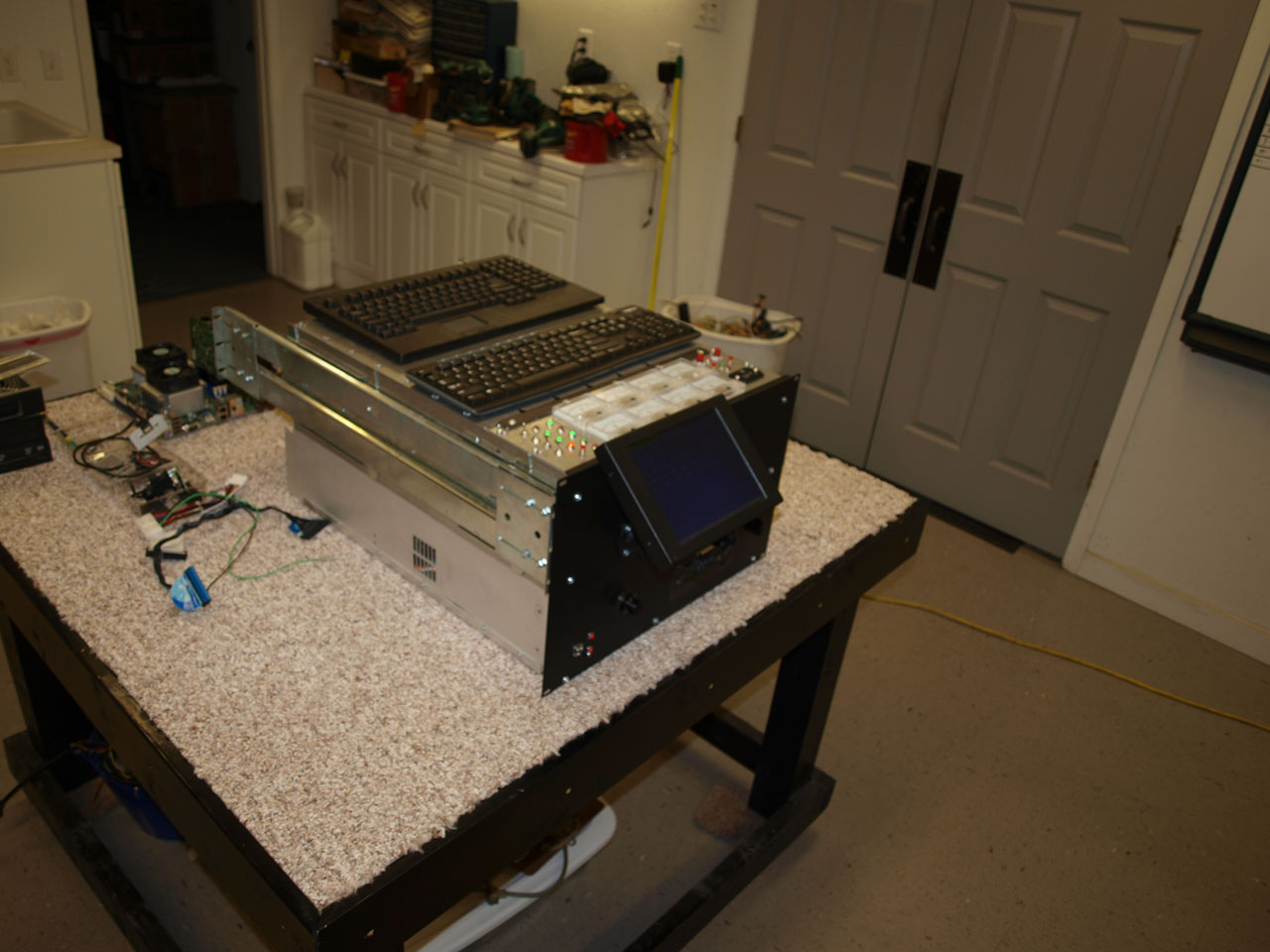

                  Now for the first time in a couple years, the Dolby cabinet is reunited with its cover. When the Dolby unit was original, this would have been the top lid. It's now the bottom.

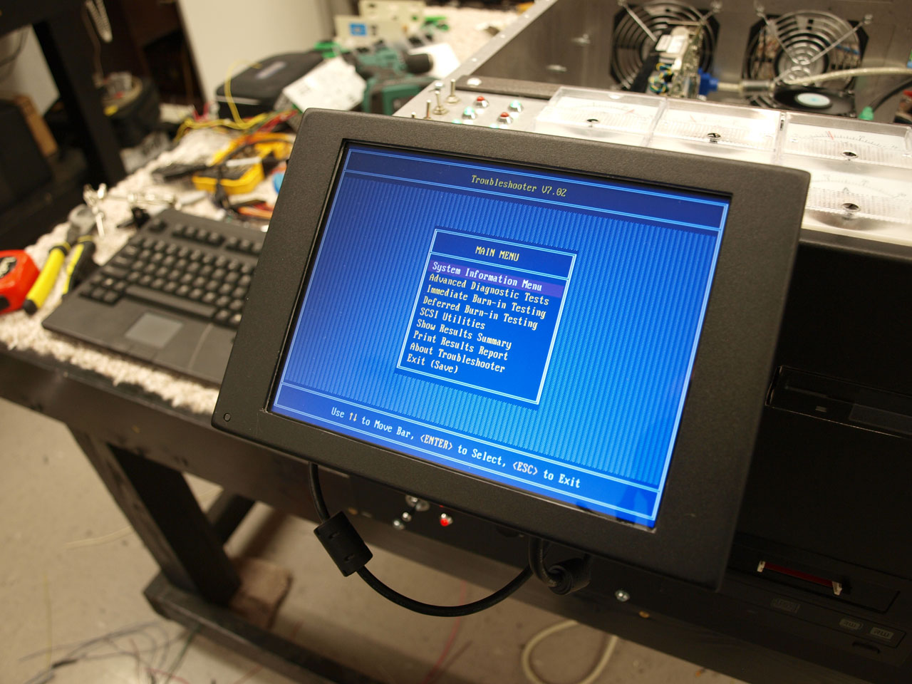

                  Turned upright and internal display installed. I probably could have gotten away with flushmounting the display, but the pedistal makes it far more viewable.
                  The test bed, power for all standard form-factor boards. I do have a ATX to AT adapter dongle, it's just not shown.
                  Rear shot. The opening where the VGA cables enter the test bed will be remedied in time, it's quite clumsy & unsightly....but poses no functionality issues....so it's not urgent.
                  Now for the mess!! I was on janitor duty during some of the testing steps....
                  This pail was nearly empty when I started the entire wiring process!
                  The pinouts. I am not erasing this yet. I still have to put this all down on paper. I will also make a 'legend', so knowing blindly what meters & lights do what aren't an issue. In time I will make proper lettering & decals for meters, switches, buttons, and lights.
                  Much better!! If you are wondering what that unused power cord is coming out the back, that was for when this unit was to have a rear mounted display. I left the cord there just incase things change later, I can add one easily.

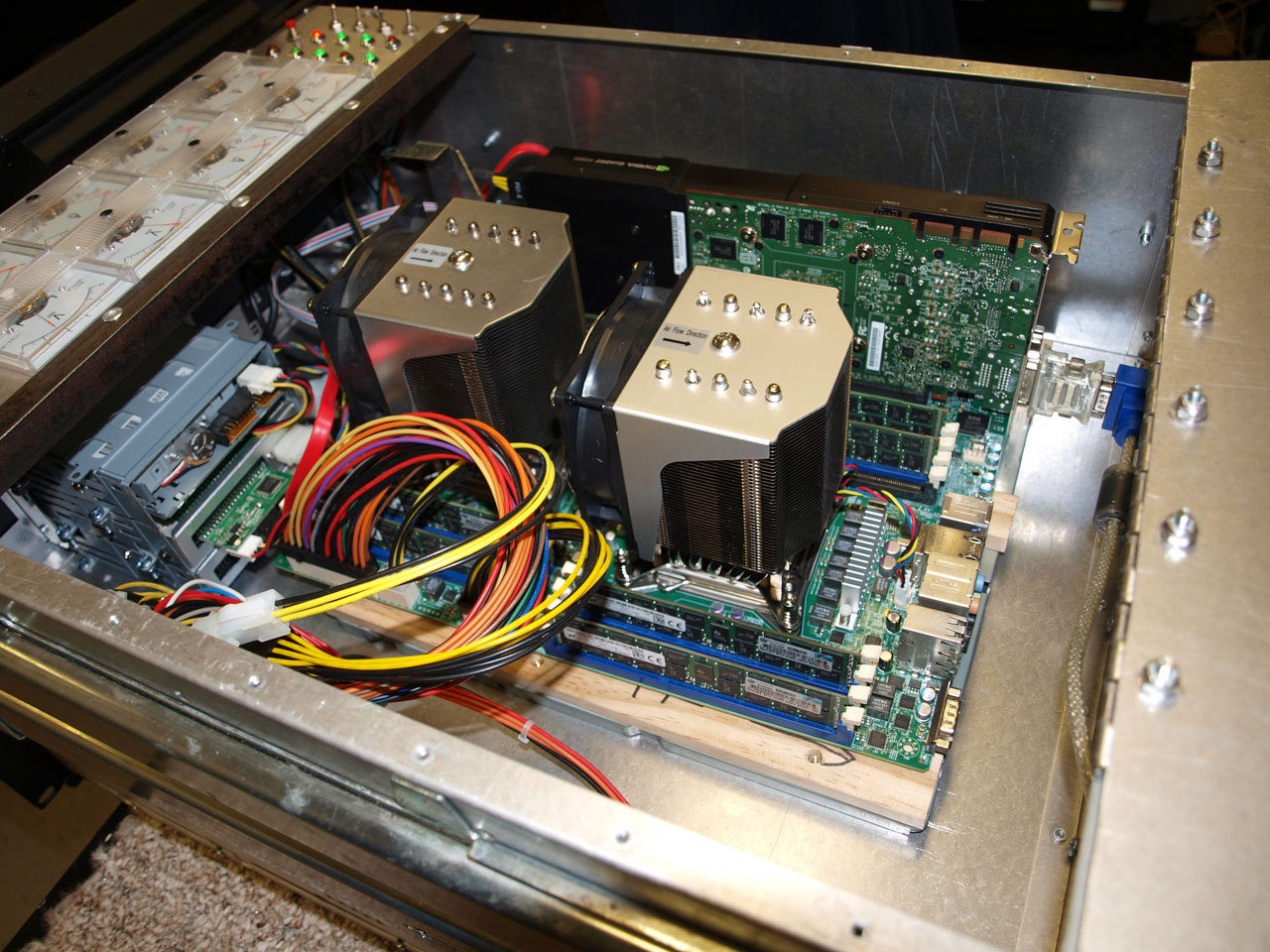

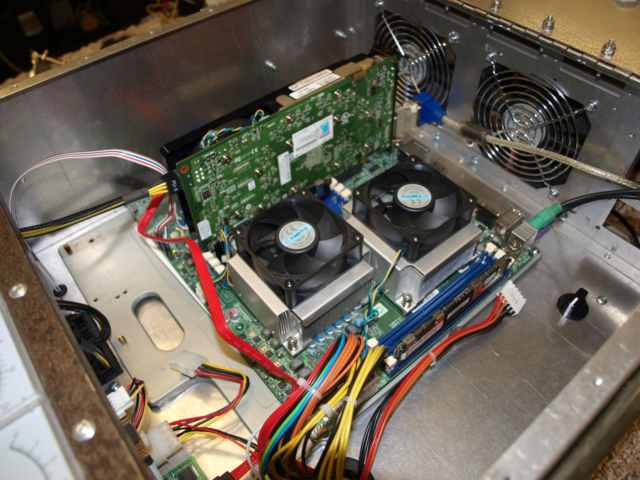

                  Now for some on-the-fly mod fun. I tested nearly a dozen different boards with no real issues.... I was comfortable putting something a bit more valuable in there this time....big eATX Supermicro X9DAi eATX board.....first board I encountered that doesn't follow the standard standoff pattern. Pulling standoffs and moving them every time for non-standard boards is silly....so here was a better solution.
                  Cut some thin wooden strips that are ~3/16" thicker than the height of the standoffs. and marked them for standoff locations. I then drilled them out, using the standoffs so everything stays put. These risers simply lift up and store away when not needed....but nice to have them when I do!
                  Now she sits in there....snug but fits.
                  Big daddy board fired right up.
                  memtesting. I have nearly 1TB of these 16gb PC3-12800R modules to test. This will get some hours packed on this machine, it takes about ~12hrs for it to run a fully loaded board (holds 16) @ 256gb per run....and then if there's a failure, the time to weed out the bad one.
                  Memtest is also entertaining on the ammeters. Different tests creat different loads.
                  ...and there it is... A couple years work is now usable!
                  It is not finished, still odds & ends....but at this point it is now usable and will be commissioned in the shop for use. I will leave it on the island table for now, I am not going to add it to the rack for a while....I want to make sure it won't need to ever come back out again. This thing fully assembled is VERY heavy and cumbersome. I don't really want to have to move it around once in installed in the rack....but it'll function just fine on the table. Another big question mark is KVM - ala keyboard/mouse. There will be quite a few things in this rack when its all done....I really don't want a bunch of keyboards/mice in there....but KVM's can be fickle sometimes.... I wonder if there's a PS2 to USB adapter....I've never gone that way with one before...
                  There's a few members here that directly and indirectly had a hand in the development, I wanted to say thanks!! Particularly Ratdude, Momaka, KC8ADU, and Hondaman! You fellas are the best!

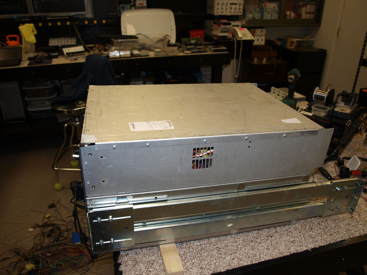

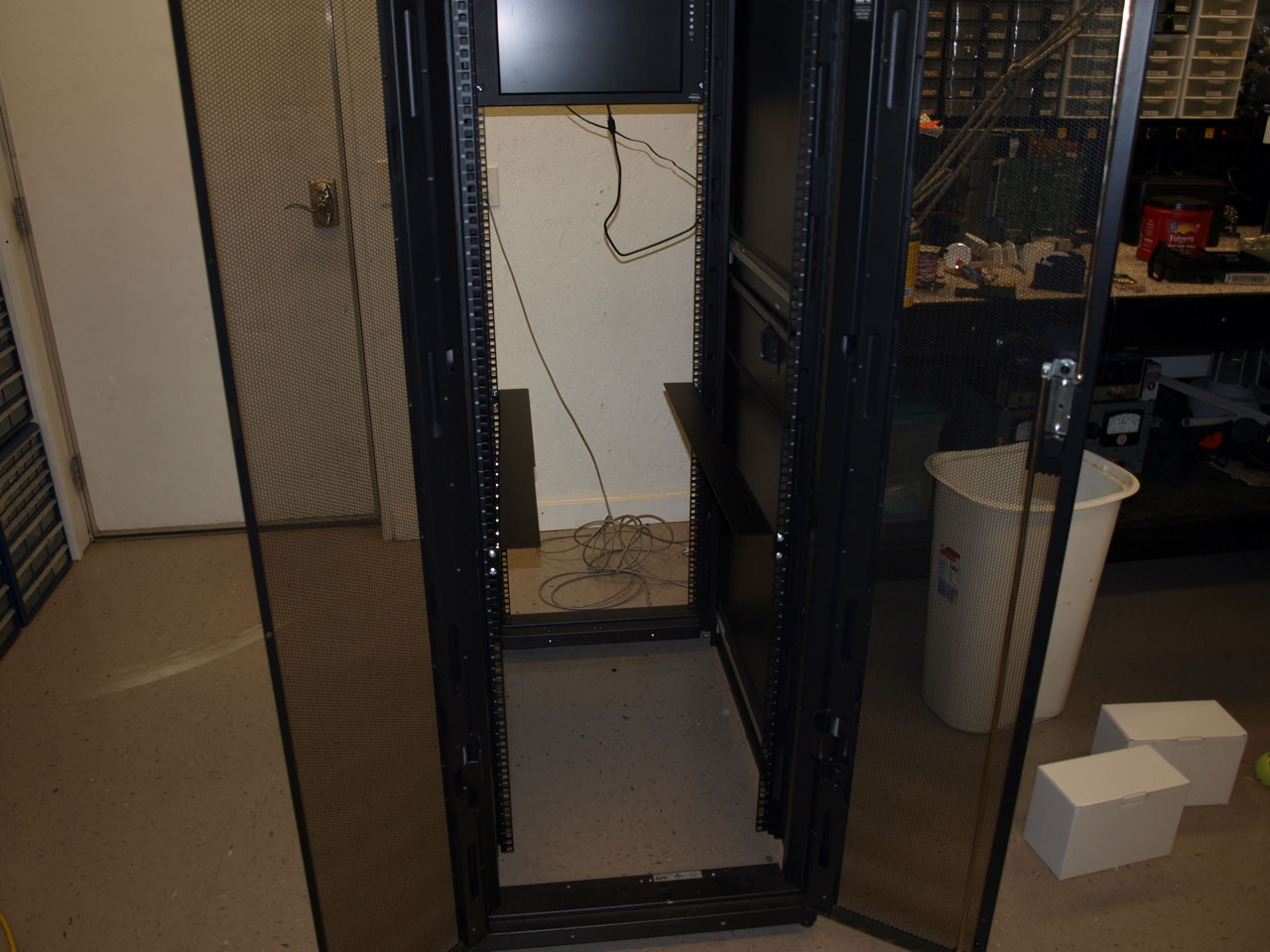

                    I made one little revision today. The rear fans were blowing inward; as earlier in the design, it was not intended to be enclosed. With the lid closed the flow isn't that great inspite of those high speed fans. Solution was to simply turn them around. Much better draw and resulting in cooler hardware.

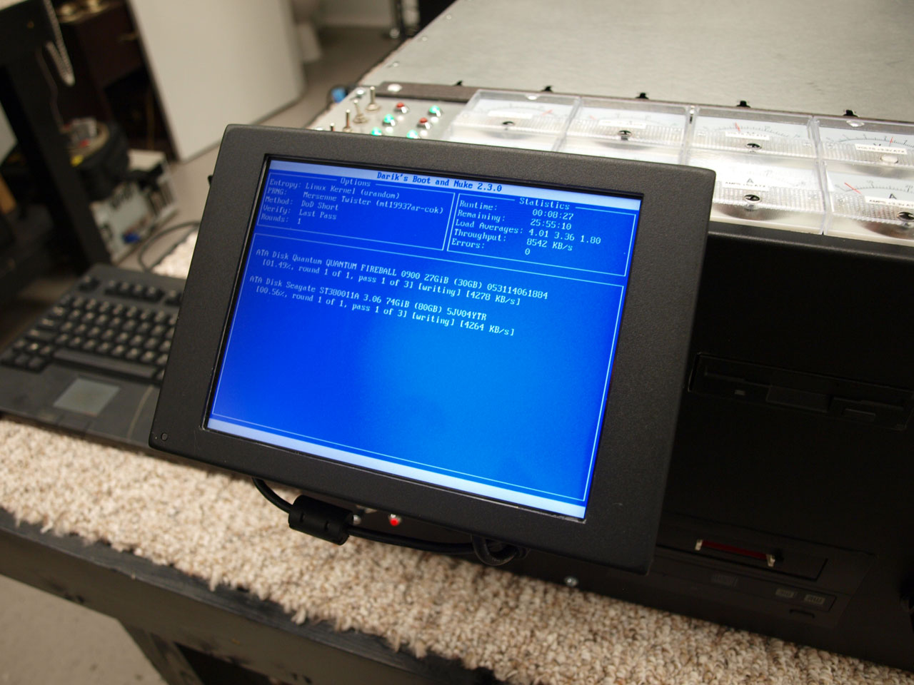

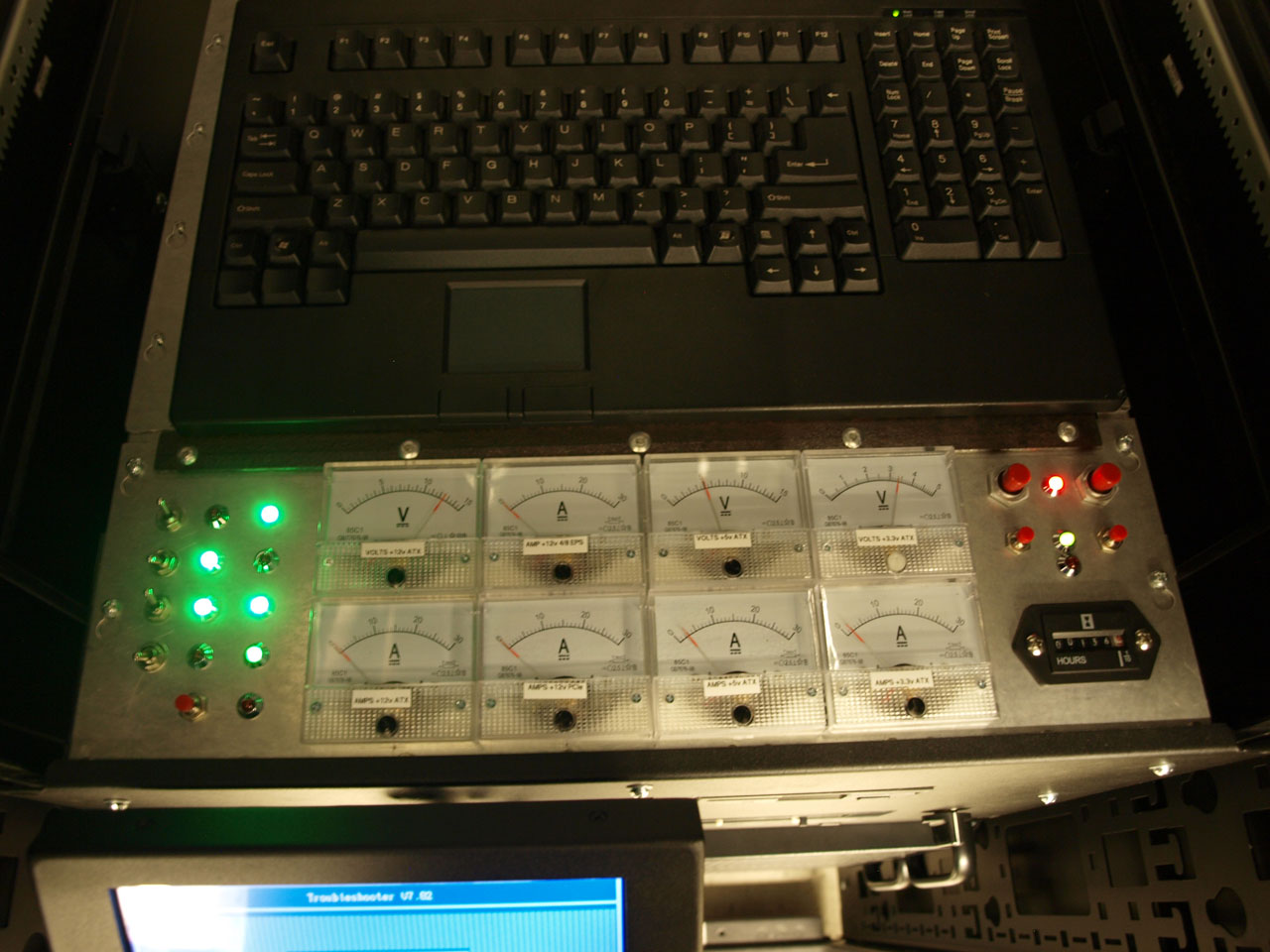

                      Testing phase of this is pretty much complete. Now for it to perform a task that's been building for a while....wiping some old IDE & SCSI drives. The 'diskwashers' do not contain IDE or SCSI interfaces; only SATA and SAS....as I rarely encounter IDE or SCSI much these days. I chose this board (370DL3 from cheap scores thread) as it needed to be tested after recapping (tested out ok). It also contains both interfaces; SCSI and IDE. A couple of IDE's got it first.
                      50-pin and 68-pin SCSI.
                      Trusty DBAN... Not the fastest IDE interface I had here to use....but it'll give the machine some good hours in valid runtime. It currently has ~45 hours on it testing random things.
                      I made cheater tags for the ammeters....as when testing, I was always glancing over at the whiteboard for what meter is what....
                      Running DBAN doesn't create a lot of draw apparently considering the load averages....when I was testing the CPU & MEMTEST, the 5V rail was bouncing between 10~15A draw. 3.3v stayed pretty consistent around 3A
                      I also added a little something inside the test bay that wasn't there before....it was originally part of the Dolby machine.....e-cookie to whoever spots it...
                        Internal USB socket? As shown in this pic, upper left corner:
                        sigpic
                        (Insert witty quote here)
                        • Topcat
                          The Boss Stooge
                          • Oct 2003
                          • 16958
                          #172
                          Re: The (now the death of) Dolby DP600 Build (BEYOND COOL BUT PIC HEAVY)
                          Observant!

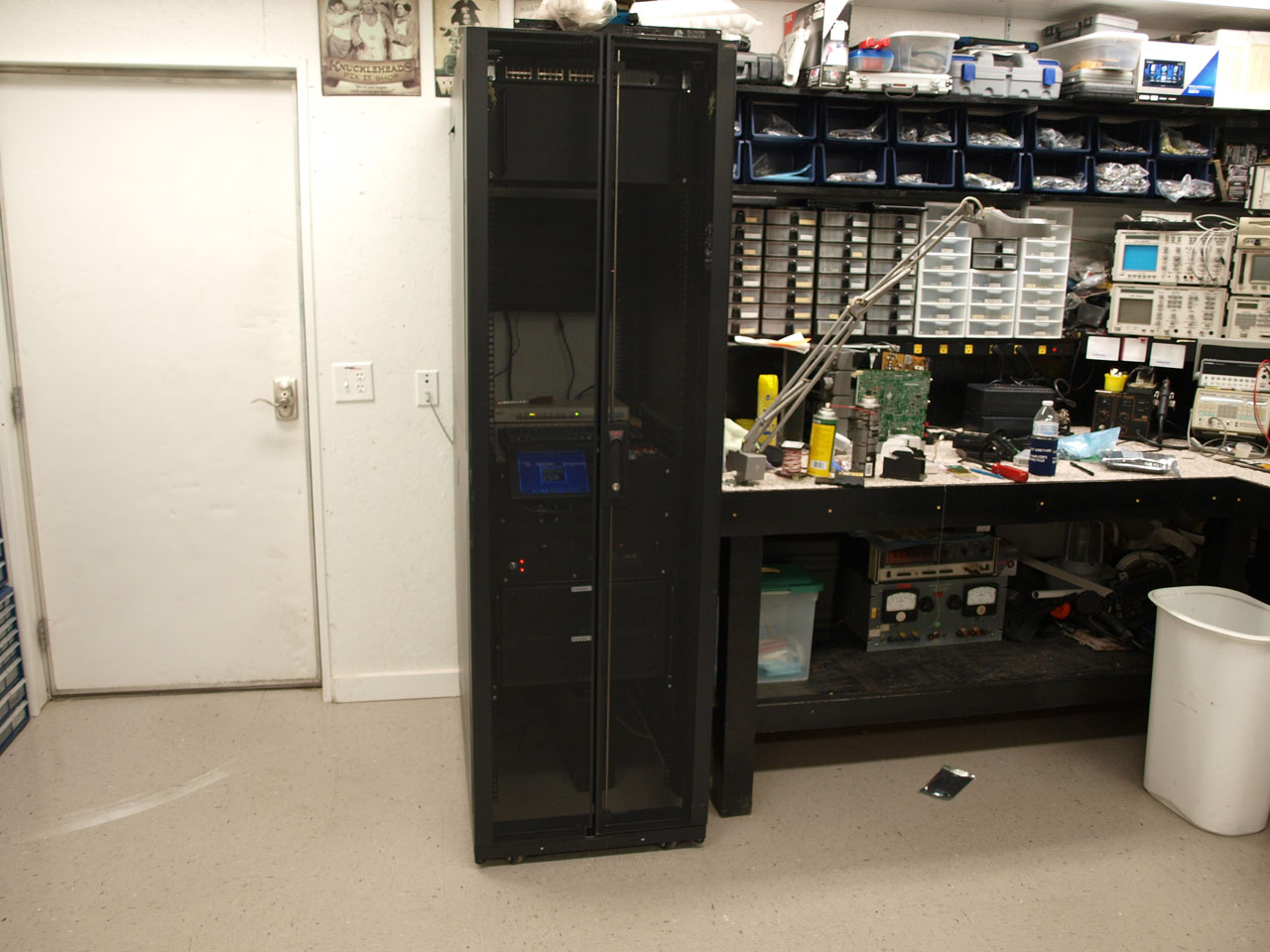

                            Part of me is wanting to correct the TPU STBY LED that doesn't turn off when the TPU is powered up....but I haven't decided....but this thing is winding down and time coming to stick it in the rack. The machine already has 112 hours on it. Been wiping IDE & SCSI HDD's.
                            When this is installed in the rack, it will free up my 'engineering island' table; clearing the path for the next big thing (unrelated to this thread)....and if you thought this one was kooky, you aint seen nothin' yet!!

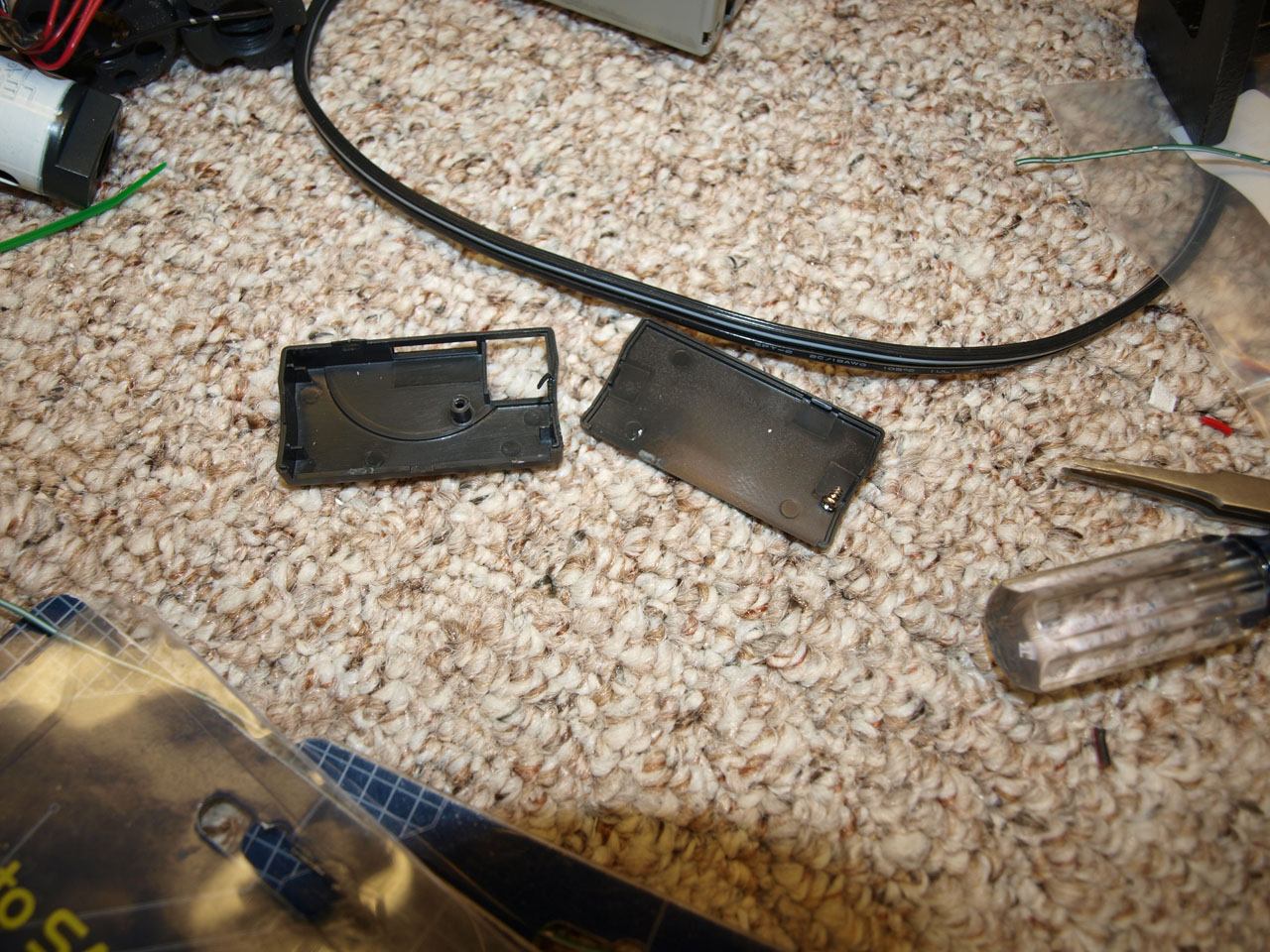

                              I can now officially call 'Pat' complete. I knew my OCD would not allow me to leave the TPU STBY bug uncorrected, maybe that's why Momaka has been boycotting the thread (disgust for me not fixing a bug ) since all this progress and no posts!! ....but I did correct it...it was going to bother me to no end....no idea why, something so trivial that didn't affect function in any way...but it's working correctly now....as the intent with that left side lamp panel; when everything is on and working correctly, there would be no red lights.
                              ...and here we go...bottom cover removed.
                              What it took to correct this in the simplest way....
                              In standby....tested using the override.
                              TPU on....and STBY lamp OFF!!!
                              Didn't even have to tie up wiring, I fed the additional wiring through the existing looms & ties.
                              Live test with a motherboard..... Wax on!
                              Wax off!
                              Yes, this project is now complete & functional. Zero bugs & glitches! I did not make the rear blockoff plate, as I want to do all the cable routing in the rack first. It's an easy thing to make and even easier to install once it's in the rack. Installing in the rack is the next step.....but I'm tickled to say that this silly thing is DONE!!! The rack installation will be a bit of a grunt job.... Heavy devices...the 'diskwashers' have to be moved....and also plans for the master controller SBC, locale for it's display, and the main power distribution cabinet (still in dev)....but every added machine in the rack will be functioning (Pat and the 2 'diskwashers' so far)....the master controls will just tie things together and add a few more functions as time goes by.

                                Now for the real fun part....installation into the rack!
                                First I have to clear a spot.....so out come the two 'diskwashers'....
                                These slides were not made for either of these cases....not sure what they were originally intended for.....but it wasn't this. The overall unit with these slides was actually a bit too wide for a standard 19" rackmount. I first removed the adjustable mount plates.
                                ...and it still didn't clear!! I had to actually remove one of the slides from the machine!
                                That allowed it to barely get past the posts and into position, resting on the rails the diskwashers once sat on.
                                Slide reinstalled and fastened to the posts. This is where another issue reared its head. This is as far out as I can extend it; as the slides hit the posts on the the outward travel. The only way to cure this is to carve about 8mm off the rack posts in the path of the slide extenders. I opted not to do this as of right now. It comes out ~16" or so, working inside the machine isn't a problem. If I chose to later, it wouldn't be all that difficult other than the disassembly....I just didn't want to modify the posts until I'm 100% sure nothing will be moved or otherwise change....this mod would obviously be irreversible....
                                It closes nice & flush.
                                Now to reinstall the diskwaskers....
                                Time to start buttoning it up.
                                ...and test it.... The KVM ties all 3 machines together to the same keyboard/mouse, but worry not....the wooden shelf it's sitting on is temporary. I still have other projects for the rack cabinet. The problem still exists if I am testing a motherboard with no PS/2 ports and KVM use. A USB can still be utilizes without issues, it would just create some degree of clutter when having to use one.....but it's manageable for now.
                                Yay, it powered back up!
                                Transfer switches working as they should.
                                Making sure all the wiring clears....no problems. Nothing pinches, snags, or otherwise causes any problems!
                                ...and done for now...
                                The overall rack tower project is still a work in progress, but this marks the completion of yet another phase of it; and probably the most complicated phase. The 'dolby' machine is now complete!! I'm sure a little fine tune & tweak will come up, but it is complete & working! Even though the 'dolby' machine is complete, I will keep all additional updates & mods for this rack project in this thread; that way everything is all in one place.
                                This post will conclude this thread for a while, I have to get back to some other things....and everything is functioning & usable! For those that doubted it would be completed or doubted it would work;
                                      https://www.badcaps.net/forum/attach...1&d=1676251795
                                      Simple, yet effective. Nice!
                                      Meter 4 = 3.3v rail
                                      https://www.badcaps.net/forum/attach...1&d=1676175957
                                      Sounds about right too, for what the board is doing. The few amps on the 3.3V rail are for the RAM and sometimes chipset(s) too - typically ~5-10 Watts for the RAM, and 5-15 for the chipset.
                                      You know what you can use this machine for - matching an old PC motherboard to the "right" PSU for most balanced voltage operation.
                                      E.g. socket A boards tend to use the 5V rail... so seeing how much one draws and then matching that with a 12V-heavier GPU, you can use even a crappy PSU with terrible voltage regulation, and still get very nicely balanced voltage out of that.

                                          Yes, I braided the mains...and added ferrite beads. I was worried that intermixing the mains (AC) in close proximity to the VGA cabling that it may cause some interference issues with the VGA transfer switches. This has not been an issue; but I can not confirm if these precautions were the reasons why not.
                                          Originally posted by momaka
                                          Sweet!
                                          I love good cabling like this. And the best part - you got it for FREE!
                                          There wasn't a lot left of that harness when I was done either!!

                                          ___________________________________________________________
                                          Oh boy, I can tell this is about to be a grunt job - lost of moving of heavy gear, isn't it?
                                          I didn't weigh this thing, but it's 60lbs easy....and awkward to handle....so yea, not a fun job.
                                          Yup, try it and see how it goes... and if it proves to be a nuisance, then modify.
                                          Sometimes, no matter how much you plan stuff, at the end you just have to start using what you built to see if anything else is needed or not needed. Sounds like it'll be alright in your case, though.
                                          I think it'll be ok....atleast for now. It would be nice if it had the full range of the slides, which would have it coming out a good 3 feet; which is why the diskwashers went under instead of above....want to keep it bottom-heavy.
                                          Ah, I think I see now - your KVM is PS/2 an so a motherboard without PS/2 makes the KVM not possible to use with that mobo?
                                          If that's the case, you'll need an active circuit that converts PS/2 signals to USB. Not sure if I've seen one, but it has to have been done and posted out on the internet somewhere.
                                          I don't think it would. PS2 KB is what triggers the port....like I said before, KVM is still an open issue in some instances with this....fortunately, most board still do have PS2 ports....but some don't.
                                          And I'm glad you've shared it with us too. IDK why, but personally, I really enjoy when someone shares the process of how they make something (doesn't necessarily have to be electronics related) and what personal touches they added to it. It's like a good story, IMO.
                                          It serves a few purposes....sometimes I'll look back on my own builds for reference material for another one I'm pondering...sometimes it's bragging rights (not many of those really, in modern terms I tend to buy 'trailing edge' tech)....but whatever the reason, if someone gets something useful from one of these threads; mission accomplished!
                                          Yeah, this is why I also prefer to use scrapped components from name-brand CRT/plasma/LCD TVs vs. buying new cheap crap online whenever possible. Some older stuff just have really good quality parts that are begging to be reused. This 300zx harness is an example of that.
                                          The ferrite collars/beads came from the sustain board harnesses from an old Plasma TV....those give off so much EMI, I knew there would be a bunch in there... I tend to fix Plasma's, I like them.....but this one had a cracked screen.
                                          Nice! Adding a separate ground only makes sense if you bought / have twisted pairs of cables (like those for the front panels in PC cases). Otherwise, it's just extra work and wiring mess to go around. So good idea there!
                                          Like the old saying goes; keep your pecker hard, your powder dry, and your grounds short...the world will turn!
