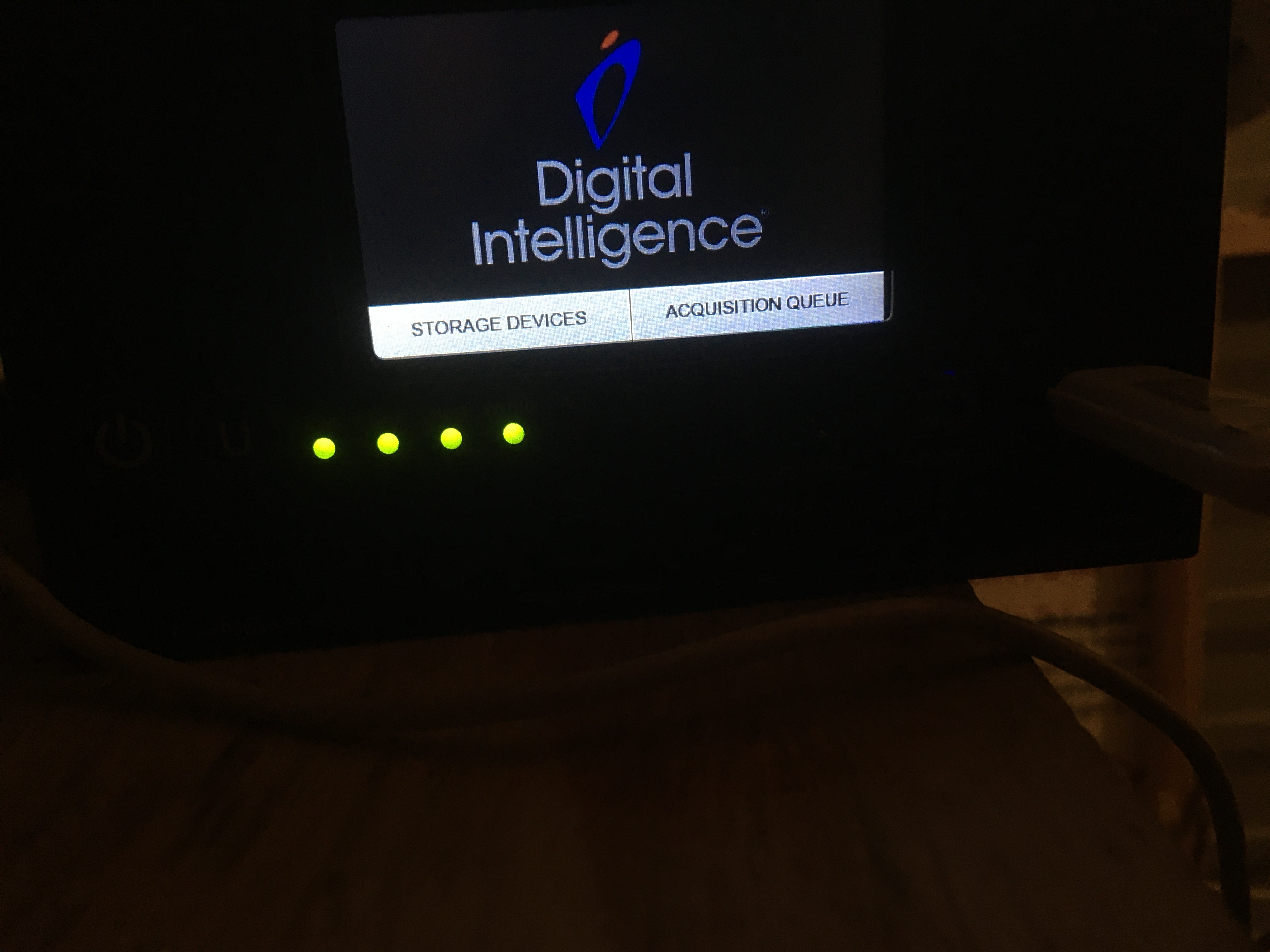

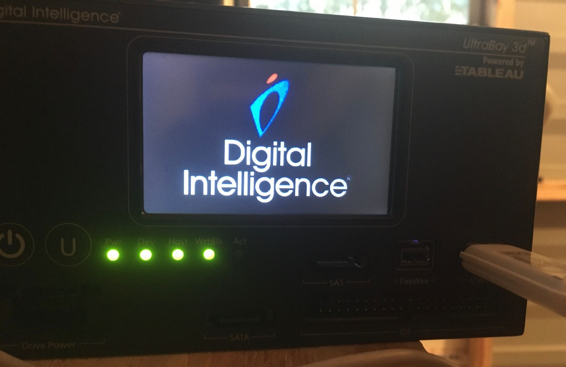

              I bought the same thing for the duplicator from Tableau interface but I only bought the the the interface module and I did get it working
              Tableau UltraBay 3D interface with the LCD screen display I have been looking for something to duplicate hard drives and USB flash drives but you I would have to put in a computer and copy it then remove put the cover back on the computer it was to much work
              The unfortunate thing about this company that makes this device is very hush hush about there product setup first of all it is not all one place second you have to create an account to get certain information about there product also another issue is that they only have information on the current version of their new product which is the UltraBay 4D which is somewhat different than the 3D version but some of it is the same
              One thing that you need to be aware of is that you have to have all the cables installed before you install the software other wise the screen will not function at all
              Now I have to makeup some power supply cables for this device because I am putting it in a HP Elite 8300 CMT computer which does not have the old version connector for hard drives so I have removed some from an older switching power supply
              I also need to modify the the 5 1/2 bay because this device takes up two spaces plus I want to have the CD drive in there as well so I still have more work to do
              I just keep doing stupid shit I managed to fry my motherboard because I did not latch down the PCI card so now I have to get another motherboard before I can continue with this project unfortunately
              It does not seem to have done anything to the Tableau UltraBay 3D interface module so it seems like I got lucky with that part

                I got another motherboard and I now have it up and running now with it being reimagined to the factory settings and the recovery partition on a HP Elite 8200 CMT with the Tableau UltraBay 3D interface duplicator with the LCD screen display and the USB controller board installed with the locking tab in place so the board does not move in the PCI slot installed in HP computer case
                Now the motherboard that got fried I going to remove the power cord connectors to the motherboard to power the CD rom drive and the hard drive to also power the Tableau UltraBay 3D interface so I use it correctly and not have it jerry rigged like I had it to test it weather or not the Tableau UltraBay 3D interface with the LCD screen display device worked or not now that I know it works it is time to do it the right way
                When I have it up and running correctly I will start a new post about this device and how I am going to be using it

                                          I will add something to this as well you do have downloaded the firmware and make sure that your system recognizes the device I personally could not get the FireWire to work correctly but could get the USB 3 cable to work but you do have to get the USB 3 PIC card from them for it to work correctly on older systems and your system needs to recognize it as well in the device manager
                                          If you have a computer that has USB 3 dose not necessarily mean that the device ( Windows 7 ) will be found I ran into this issue with an older system
                                          I also have very new computer and it has no issues with finding the device and working correctly ( Windows 11 )
                                          It will work with this USB 3 PIC card
                                          https://www.ebay.com/itm/315216805876
                                          I have bought several of them from this seller before
                                          One way to tell if you device is working correctly see if you can read a USB thumb drive or not if you can it is working correctly
                                          The issue I have is that is that I cannot use it to copy drives for some reason which I have not figured out exactly what the issue is
