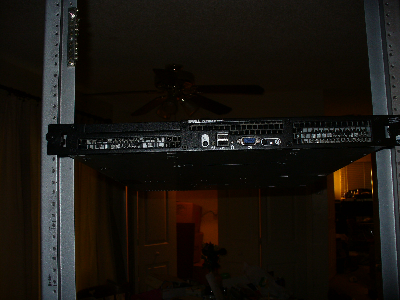

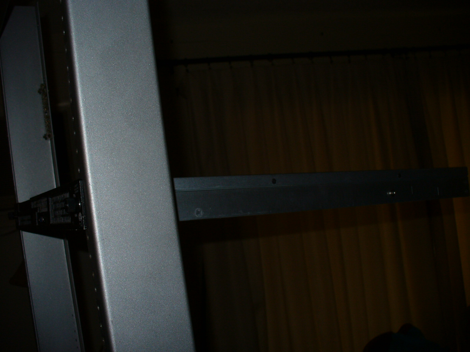

                                Brought it home tonight.
                                It's missing some screws and is a bit wobbly as a result... easily fixed at least.
                                The Dell R200 1U fits like a glove:
                                ...but will need a shelf underneath for support:
                                Still, not bad?
                                The IBM will require drilling out a location, as the rail's pins are at the right pitch but too big for the threaded holes. Or I trade/sell/ditch the IBM all together and go for a Supermicro blade (which reportedly are 2-post compatible, besides, Supermicro kicks ass!)

                                  ^ took another look, I'd need to cut 1/4" out of the back side flange of the uprights for the IBM rails to pass. Nothing an angle grinder and 20 minutes can't fix, but it is annoying. Basically I'd have to make an IBM specific slot in the rack.
                                  That said, I did score a 100LB rated 4U shelf for $30 (and offered on a 2U 55LB shelf for the Dell R200) so there is hope here.
