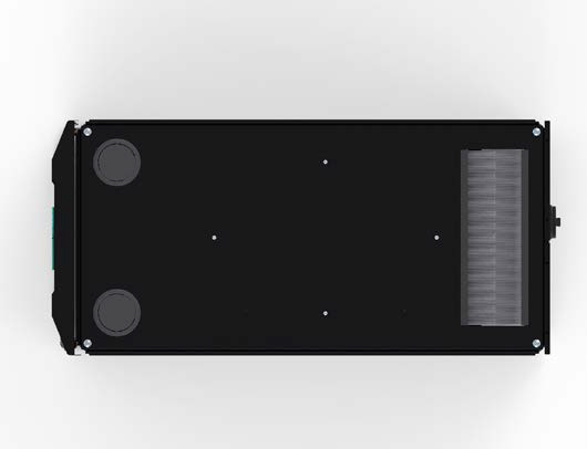

    Hello!
    I've searched the internet, skimmed through a lot of HPE PDFs, all searching for the answer to a simple question. On the top of my HPE H6J77A Advanced Series rack (36U), there are two round holes on the front top of the rack. What are those holes for?
    Here is a picture of the holes that I'm talking about. I know what the square on the back is for.
    I originally thought fans, but no, the fan kit is for the middle of the top of the rack. Then I thought maybe duct work for cooling, but that doesn't make sense with both being on the top there. I looked through the Options manual for the rack, which shows how to install all the various add-on's that go into the rack or that are available for the rack, and there's nothing on those two holes.
    Any ideas?
    **EDIT: Never mind. I found it on a technical datasheet. ROOF CABLE ACCESS FRONT LOCATION. I just have to figure out how to pop them out now. Thanks!

    Re: Identification of two round holes on top of rack.
    whats on the base?
    2 big round feet by any chance?
      maybe dust catchers .would depend on air flow .
        Originally posted by stj
        whats on the base?
        The base of the rack? It's mostly open, minus directly underneath where those circles are. There's a metal bar that goes across. On each side of the bar, there's a cutout L and two very small holes cut out.
        Those two holes at the top, according to the technical datasheet for the rack, are for running cables to the front of the rack.
        With our current setup, most of the cables are ran to the rear. We have coax that will be ran to the front and cat 5e plenum rated ethernet that will be ran to the front, for telephone.
        We're currently using a POTS type telephone system. Eventually, we'll switch to VoIP. I plan on using a CAT 6 UTP patch panel I got for the telephone. I'll daisy chain all 48 ports together. Then plug in the incoming telephone line into port 1 or something, and all the other lines will be output.
        That's the only way I could figure to wire up the phone system with what I had. I think they make IDC 66 blocks or something for telephone, but I had the CAT 6 patch panel lying around and figured I could make it work, at least until we get VoIP services.
          I'm a bit concerned about temperatures. I have sides for the rack and I will be installing them once everything's configured. They make some sort of air kit for the rack, where it seals all the gaps. I am trying to figure out a way to cool the datacenter.
          I have 5 or 6 small windows in the room. I was thinking even once we get central air next year, I'll probably have to install a few smaller ACs. Maybe 5,000 BTU. I'm going to have to look at the datasheets for all the various equipment and see if I can find out how much heat they're generating.
          Most of the equipment is HPE and they're pretty good about listing that in the datasheets somewheres. I think I can just total the heat dissipation in BTUs and whatever I end up with, just buy ACs that total that amount.
          They do make a rack that has some duct work installed on it. From what I was reading (I didn't look into it that much), it's just got something that hooks up to the cold air return.
          I see they also make racks that got built-in coolers, but they're pricey! The price for the HPE one was something like 33,000$! It looks like it's got an AC the height of the rack attached to the side. It's got some glass (maybe plexiglass, I dunno) for the door, with the regular door after that, that keeps the air from escaping.
