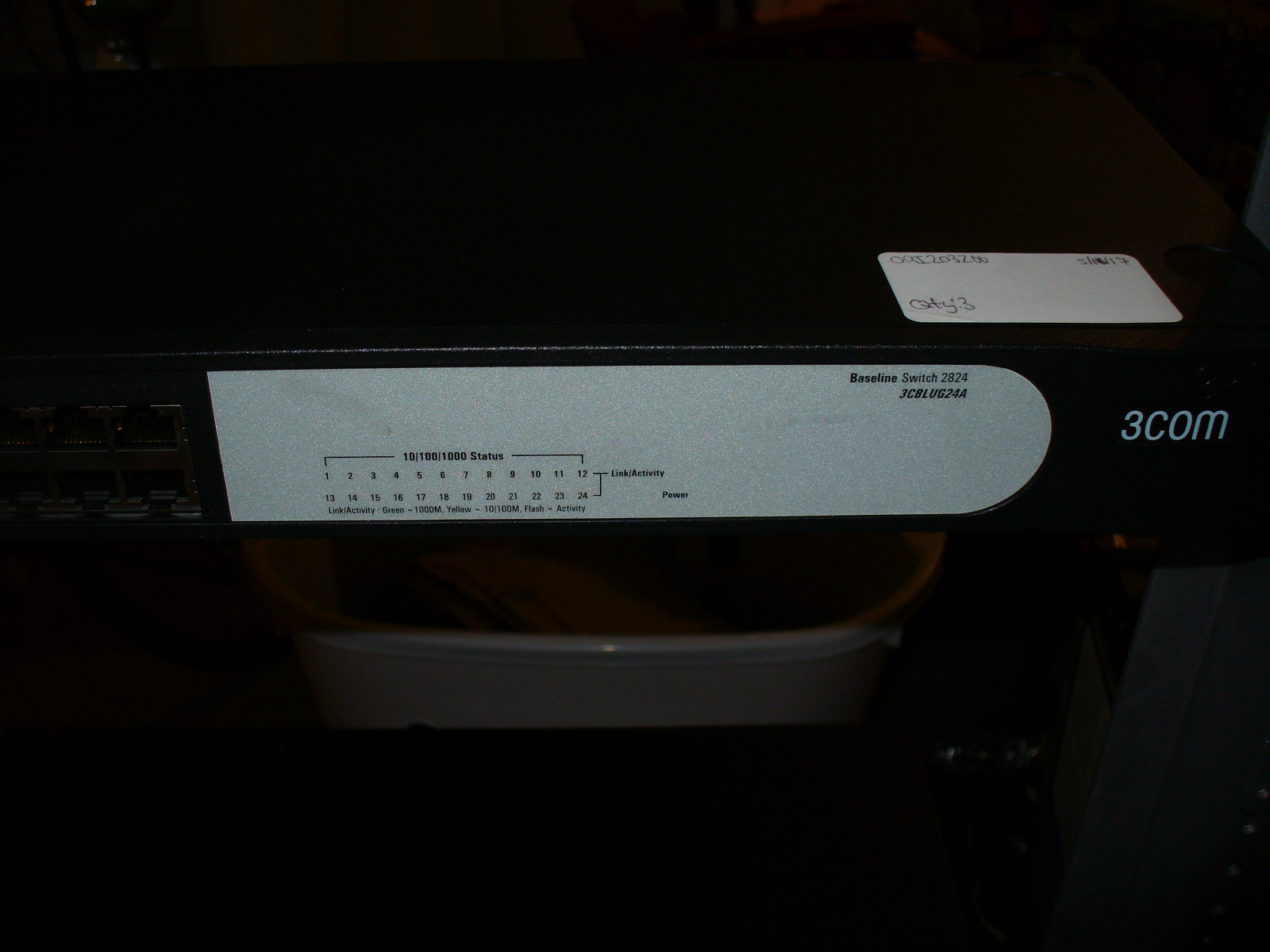

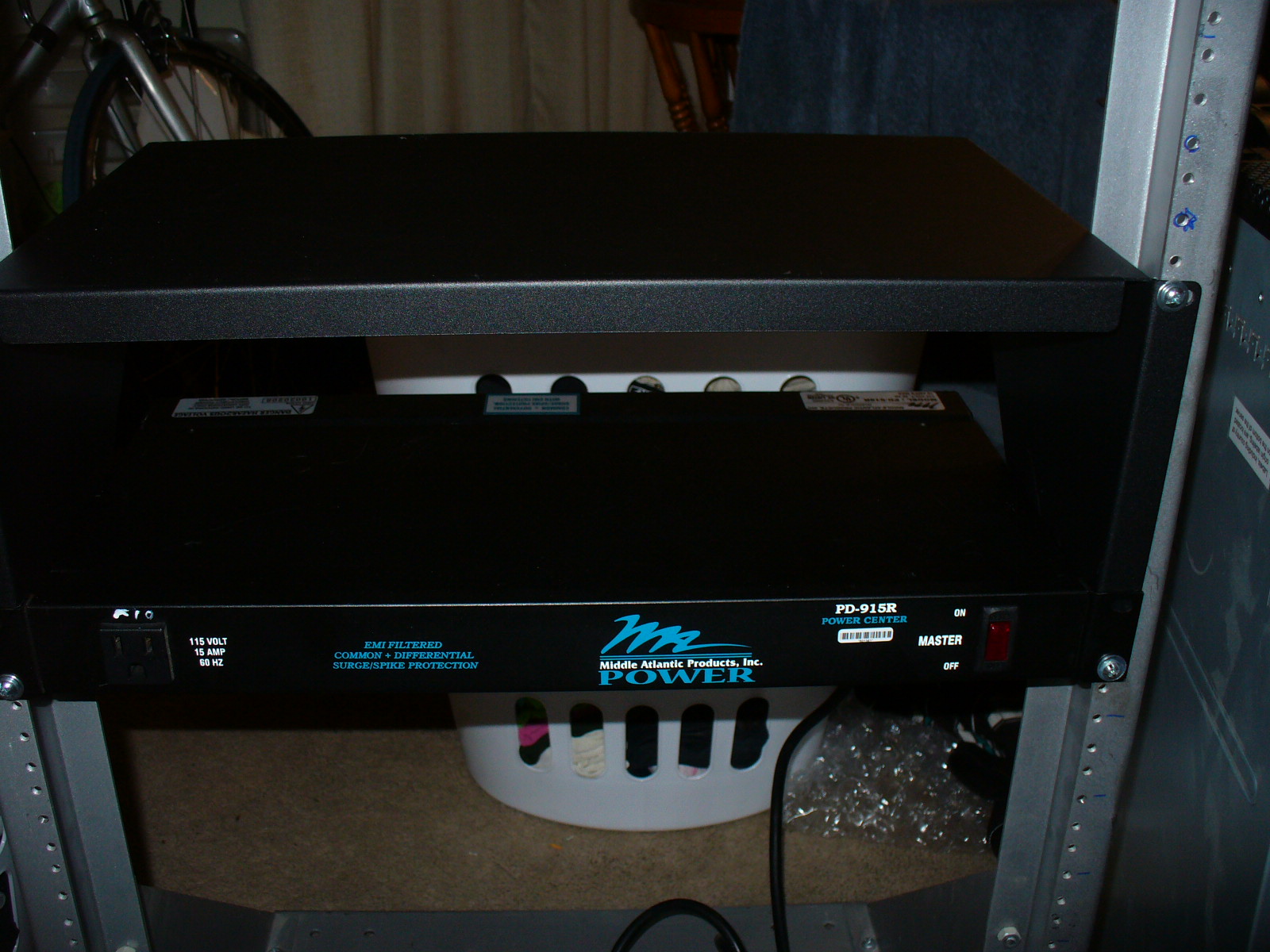

      Did some layout and building this evening. Here's the current plan:
      (from Bottom to top):
      • U1-U11: IBM Netfinity 7000, as ballast (could be come UPSs down the road???)
      • U12-U15: 10" 100lb shelf
      • U12 (interlaced with above): Power strip unit
      • U16-U17: IBM X3650 (modified section of rack)
      • U18-19: 2U shelf
      • U20: Dell R200
      • U21-U22: Patch Panel and/or Open area for LAN cables
      • U23: Gigabit Switch
      • U24+: Unused
      Who wants build pics? You do? I know you do too, so here we go:
      That's what I have so far. (yeah the Apartment is a mess right now, sorry)
      Power distribution and shelf mixed. This is partially to use the strong Power distribution case as reinforcement for the shelf (less likely to bow inward)
      24 Ports of 3Com Gigabit awsomeness.
      Looking Good?
