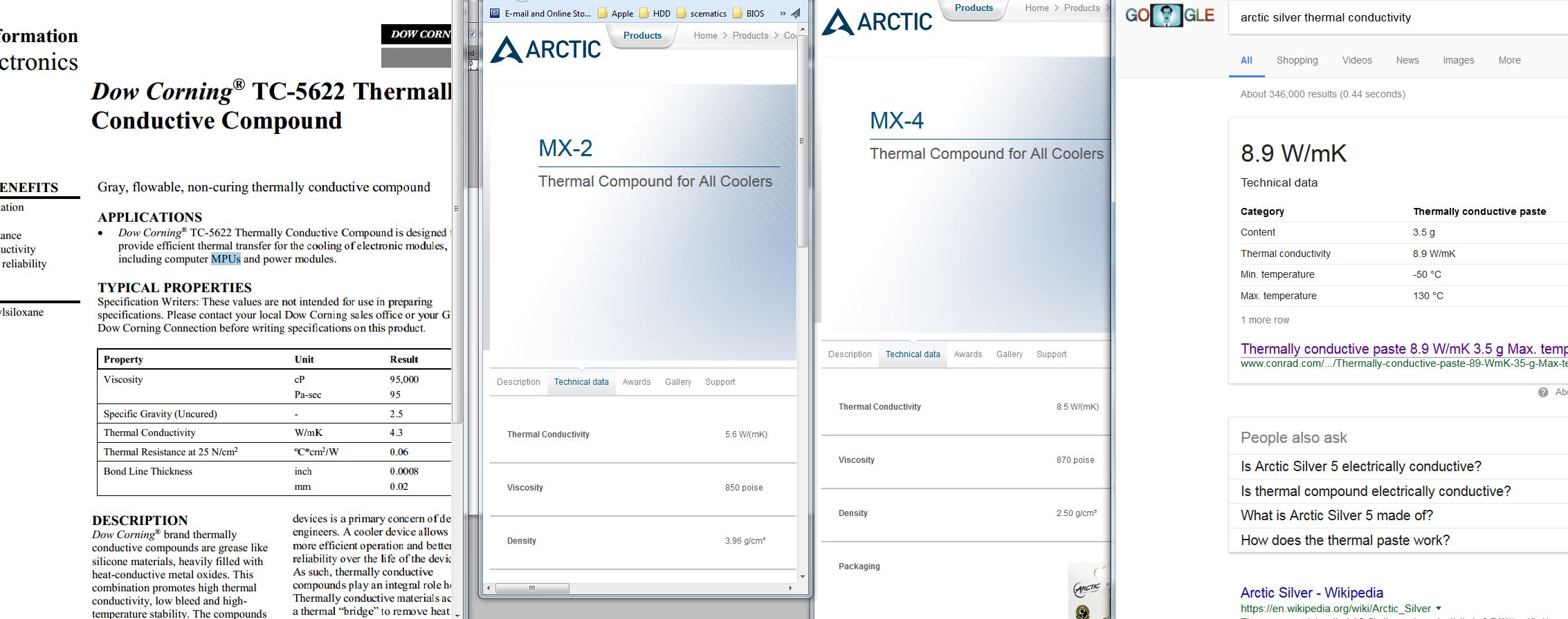

      Why not buy 20g tubes of MX-2 or MX-4. Both exceed the spec of TC-5622 and you don't need to buy such a large tub.
      Buy direct from their site so avoiding ebay fakes.
      Whilst i'm having to save up money for certain items for fixing, thermal past isn't one of them.
      MX-2 30g $19.99 65g $29.99
      MX-4 20g $18.99
      $7 shipping
      https://www.arctic.ac/us_en/
        MX-4 20g $18.99
        $7 shipping
        I heard milk can dissolve it too in certain circumstances stj.
        Okay. I originally ruled MX-# out because of the stuff that customer brought me that was supposedly MX-2. I worry about the specs though. It seems most of the companies that were selling to consumers, not businesses, fibbed a good bit about their numbers.
        But I think momaka brought it up originally (maybe someone else), after a certain point, the higher the thermal conductivity, it doesn't really matter, with CPUs at least. So if MX-2 or MX-4 is comparable to AS-5, even if it's not really as high as TC-5622, it'll work just fine. And if it's cheaper than TC-5622, that's perfect! I'm looking for something a bit cheaper than AS-5 that's equal or better than AS-5. To me, AS-5 is wonderful stuff, it's just a bit pricey, and now that we cannot buy it locally, if we have to order thermal paste online (which is now the case), I figure we should look at what's out there.
        I'll probably order both the MX-2 and the MX-4 at first, and see what one I like best. I can't stand this IC Diamond stuff. It gets real messy and it's hard to get off.
        I didn't realize Arctic made the MX-2 and MX-4. The three sets of thermal pads I bought are made by Arctic and they seem to be a lot better than what was originally in the cell phone that I needed them for.
