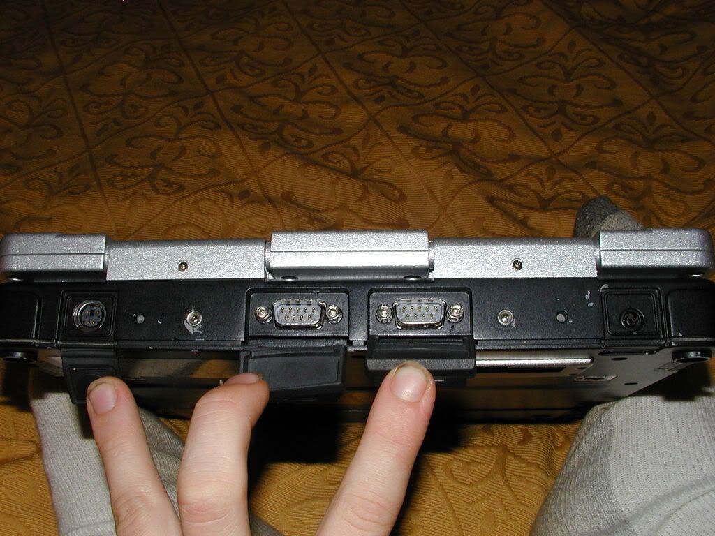

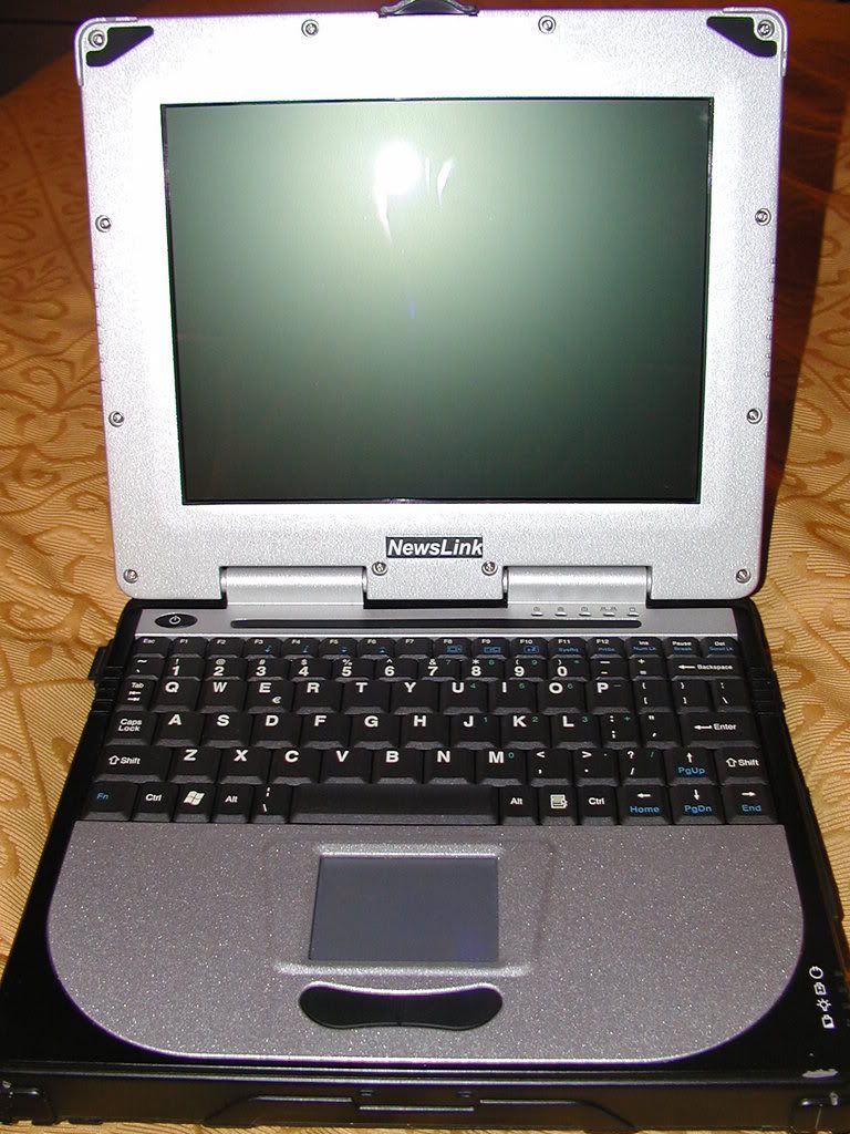

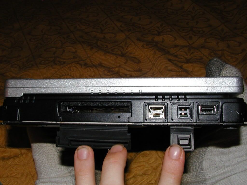

    Wow. This is one hell of a laptop setup.
    I picked it up during my little trip this weekend for $40 and it came with just the notebook. It was missing its battery, hard drive (luckily the caddy was still there), charger and two or three dust caps.
    It also has no built-in floppy or cd drive but thankfully it has a USB and PCMCIA port so I can use an external drive.
    Anyways, because this is so exotic I am having trouble finding the battery and the AC adapter.
    I have no idea of the kink of battery it needs (would one from a Toughbook work?) nor do I know much about the charger.
    Does anyone else here have any idea on where to locate these two items? Possibly even a dock?

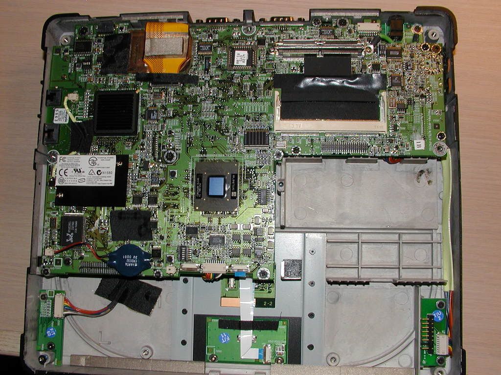

            Here is the inside.
            From what I heard, it has either a Celeron or a PIII installed and while there is no SIMM in the ram slot, there should be more on the board.
            this notebook is Getac W120 i believe
            It looks like it is.
            http://www.dealtime.com/xPF-Getac-Ge...W120-104128-10
            Hmm, it also seems like I am missing the back handle on the thing.
            EDIT: Holy crap! I think this also has a touch screen!

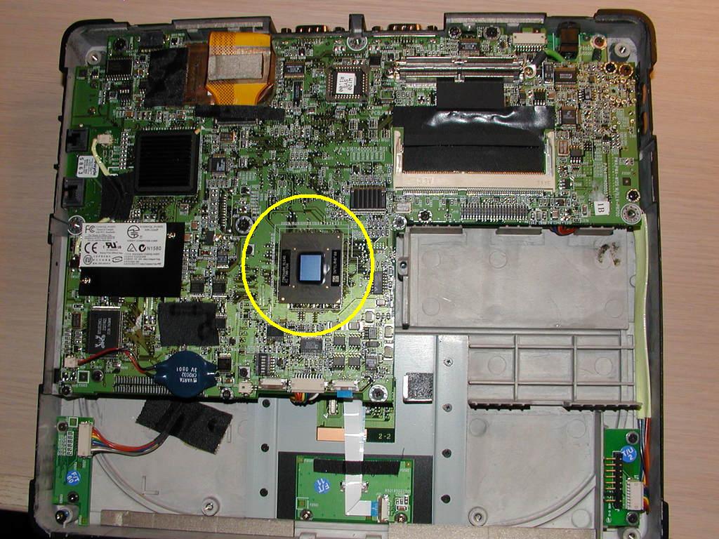

                    See circled item.
                    That's called a CPU.
                    They have numbers on them.
                    [Hint, Hint.]

                      It says 100MHz FSB
                      Probably BX or ZX chipset.
                      ZX was 'economy' BX.
                      Adapter seems to be a standard connector 19vdc.
                      Wife's old (and broken) P3 1GHz uses 19v at 3.68amps.
                      That should be plenty for yours.

                        Fine on web, and office that's about it.
                        This is mobile PIII and I have 2 notebooks based on that mobile PIII. Just put on 2000 on it, make sure you can stuff 512MB at least. 20-40GB HD.
                        See if you can lift off keyboard and might have second memory slot. BTW this is
                        144 pin SDRAM PC100 or PC133 speed (available 256MB or 512MB, don't buy 128MB ones too small). Get memory from craigslist if possible.
                        Where is the hard drive caddy? Is it standard or need odd connector?
                        XP is too much for it.

                          Chipset max module size is 256MB/slot.
                          Only one slot available from what I can tell so 256MB max.
                          [Need double sided, low density - 16 chips on module]
                          Win2K will be fine on that as long as you keep the junk off it.
                          W98 or W2k were the factory OS's.
                          Linux should do well too.

                            That screen could be a touch screen but I can't imagine why if it's meant for use in a dust and heat and banging environment.
                            There doesn't look like any provision for sound, and The screen gives me a sneaky suspicion that it's not color.
                            The thing was designed to be a communications uplink controler?
                            Could be that's it's job, two serial ports, nice.
                            Now adays I have to search to even find a serial port.
                            Everything I do needs one and the converters just don't work well for me.

                                I took the caddy and the ribbon cable out in that photo. It's back in the laptop again. Also, I was actually planning to run Windows 2000 Pro on it anyways as XP can wait for my Latitude C810 (XP seems to like docking stations a little better than 2000 strangely) Also, there is only one ram slot on the thing. To get under the keyboard you have to completely gut the thing (and there is nothing else on the other side that looks interesting so that is why everything serviceable is on the underside).
                                I'll do my best to max the thing out with ram (256Mb currently runs my server and still seems like plenty for me and Windows 2000) and I was looking for say a 20-40Gb drive for the thing as my old Armada 1700 has a mere 4Gb drive and that's not enough for me anymore (was back when I still used 98 on a regular basis though).
                                There is a speaker on the underside. Mono though.
                                You have a point. I guess it would be best to first try and power the thing on and see what it looks like.

                                  Manual shows Audio Out and MIC jack under cap on left side near power switch.
                                  Says: "Connects a Hi-Fi set."
                                  Spec section says:
                                  Integrated into Crystal codec CS4299, 20-bit stereo digital-to-analog
                                  and 18-bit stereo analog-to-digital converter, Windows Sound System
                                  compatibility and full-duplex capability.
                                  10.4-inch TFT XVGA LCD, resolution up to 1024x768, 18-bit color.
                                  8 MB (built-in on VGA chip).
                                  Integrated into ATI RAGE Mobility-M1, MotionComp capability,
                                  hardware aid for DVD playback and dual view support.
                                  VGA port via optional docking station.
