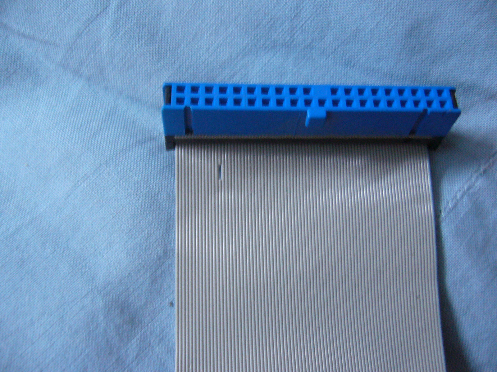

    ATA cables
    is this cable still good its an 80 conductor ATA cable,i have plenty of these with a broken wire in all at exactly the same place,by the way this is a new cable

    Re: ATA cables
    I'm not sure 100% but I think it is for "cable select" device.
    Usually you can set by a jumper HDD and CD-DVD units as master-Slave-Cable select.
    I have seen a lot of 40wire ATA cable with a open wire, but I have never seen a 80 cable.

      Re: ATA cables
      Correct,
      Set all your drives (including disc drives) as cable select (CS). The blue goes on board itself, end is primary, middle connector is slave with this (CS) system.
