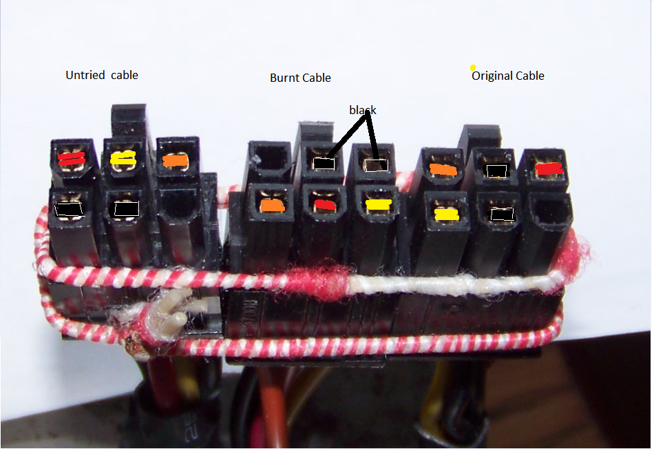

    Hi, bit of story here and a warning to anyone who doesnt know!!I know its my own fault BUT naively expected that sata connectors would be standardised. I got a freebie PC and after taking it to bits and putting it back together it was running well. Unfortunately it had only one sata cable for the power supply and I wanted to connect 3 drives, a ssd with the OS and two 2TB drives one old that was dodgy (bad sectors) and a new one that I was going to transfer the files to.

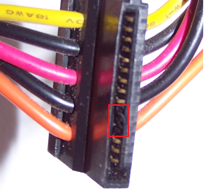

    Thought hey, I am sure I have a spare cable left over from a previous set up. Eventually found it and just plugged it in and away . Hmm whats that smell!!!! smoke!!! Rip the power cord out of the PC. As I had not secured the drives but placed them on card on the bottom of the PC I thought damn, one has moved and shorted out. Hoping its not the new one I take all the drives and cables out and find that,thankfully,it is the old drive.
    (Files on it were not that important and copied to my sons pc.)
    On closer inspection I see that it was not shorting on the frame it is ONLY the connector that has burnt, drive has a bit of charring and pins on the connector now a different colour and a bit of melted plastic from the cable connector. The drive socket cleaned up and whoopee worked ok ( back on 2 drives so used the original cable that came with the PC.)
    Transfer project still on, I connected the new drive up to the second cable which still had a unused (unburnt) sata socket and £$%&**!!! same thing happened - scorched the socket on the new drive. Again the drive still worked, after cleaning, on the original cable.

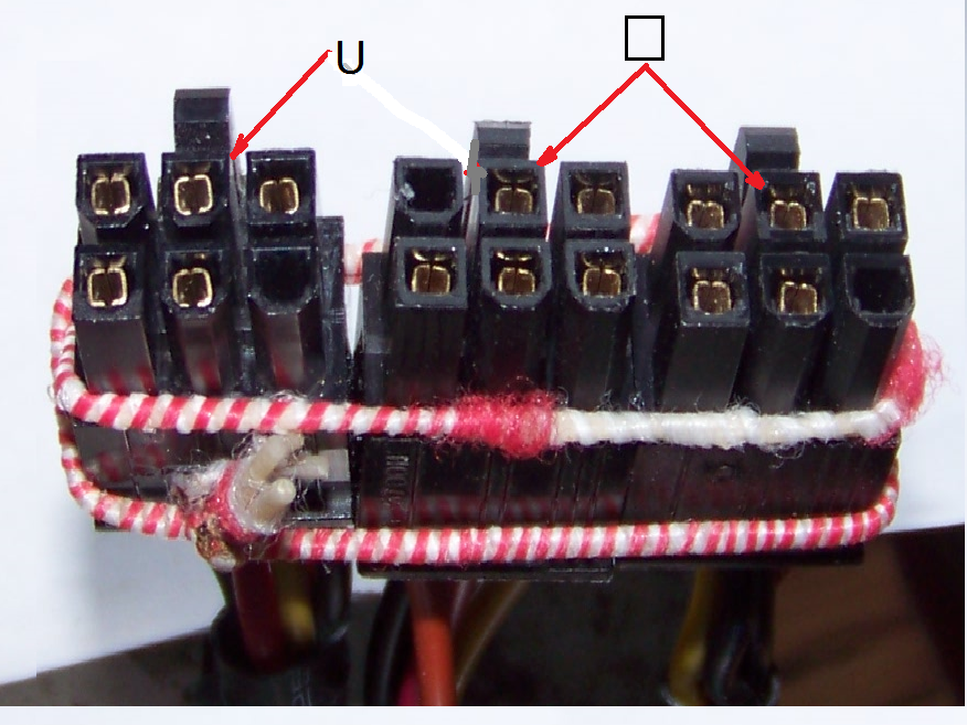

    Took some time to sink in but I removed both cables to compare and Whoa different wiring!!!
    Gave up on the project till now and having found another cable off another power supply thought I will try again. Twice bitten I have been more careful and looks like its a good job ALL3 connectors are wired differently. What is annoying all 3 plug into the power supply.
    The sockets are supposedly shaped to stop that happening? 2 are the same and one is different but even the different one has only one of the 6 "pegs" different and as it is a "U" instead of a square it still goes in. I have tried all 3 in different sockets on the power supply and they all just plug in - no resistance at all.
    Maybe I can rewire a cable in the same format as the one that works. Anyone else come across this?

    are the modular cables from different brand and model power supplies? u cant interchange modular cables from different psus like that. each psu manufacturer wires the modular panel on their psu differently to carry different voltages thru different individual wires. the U and the square sometimes makes no difference depending on how each psu manufacturer set up the individual plugs on their modular panel and cables.
    case in point, look at those 4+4 pin atx 12v psu connectors and an 8 pin eps 12v connector on a mobo. they are shaped differently but still plug in. apparently, they do it this way for 4 pin and 8 pin compatibility but that is not the point. the point is that u cant blame the psu manufacturer. they cant consider every possible scenario to make those connectors "idiot-proof" as there are too many possible combinations. some of them even use pci express 6 pin connectors for their modular cable plugs. u cant expect psu manufacturers to make their modular cables interchangeable with others. its just not a reasonable expectation. just dont interchange modular cables from different psus.
    and im quite surprised those drives still work after running wrong voltages in the wrong directions through them. my advice is that just because they work now doesnt mean they will continue to work. the drive electronics are living on borrowed time from the short circuited incorrect connection. i suggest u not put anything critical on those drives and backup the data to a fresh brand new drive on another pc.

                      Thanks for the comments folks - At least I am not alone in stumbling on this major plug and play incompatibility masterpiece. Yes 3 different makes -Zalman, Antec and an unknown (just have the cable) Naturally the pins will only pull out on the good original cable (as I dont need to pull those) and the others wont budge so its a cut and re solder job.
