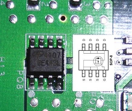

    I have been looking for BE443L when I have time but I have only found hints that it exists. (No data.)
    Can you provide a better picture of the logo?
    Maybe I can determine the manufacturer with that.

      Re: hp pavilion zd 8008ea no charge
      hi PC BONEZ
      You don't have to look for BE443L but you have to look for 4407
      I have made a search and I have found that it is equal to the AP4407M sold by WWW.PARTMINER.COM
        I was looking for 4407 too. All I could find was lists that include that number.
        I'm not sure how you determined that is the right part.
        There are a lot of similar parts and the specs aren't exactly the same between them.
        http://www.hkinventory.com/public/Of...t4=0&datecode=
        The logo may indeed be AP but I don't see an M after the number.
        I think AP4407 is the entire PN.
        AP and APEC are the same company for this part.
        Advanced Power Electronics Corporation (AP, A-POWER, APEC)
        Their site is slow enough it might be faster to walk to Taiwain to get the PDF file.
        I haven't been able to get it. Maybe you can.
        http://www.a-power.com.tw

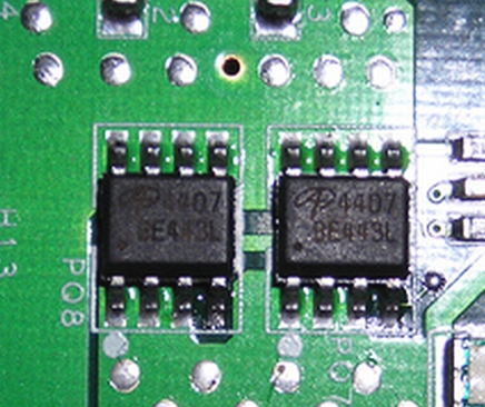

          Hope you don't mind the repost of a lager image marketta.

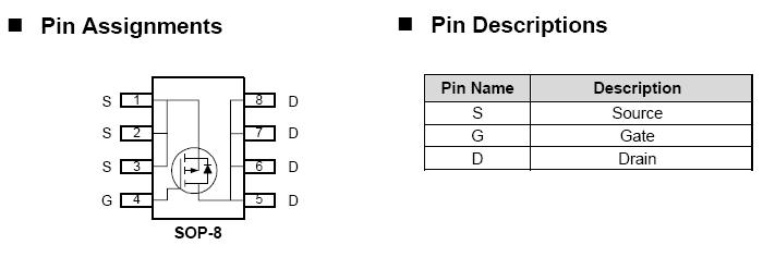

            did find this PDF HERE
            is that Anachip?
            From a post on this forum thread Here
            So seems 4407 is a common package Mosfet and I suppose if 2 are fried
            the question becomes why did they fry ?
            what other damage my have occurred and will replacing all 4 (to be safe) fix it?
            (4407 you learn something new everyday)
            (pinout matches PCB layout by the looks of it)

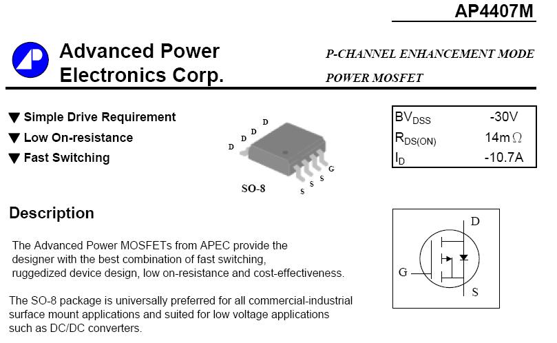

                Finally got some data sheets.
                Printed logo in the sheets is similar but not exact.
                Probably the same company,, not 100% confidence.
                Showed another AP part with 4407 to show how much difference one letter can make in a PN.
                      Handy logo site Starfury!
                      I used to know a huge one but it went *poof* about 3 years ago.
                      I was sure a bigger one existed too so that maybe the one I was thinking of but couldn't find. (haven't been logo hunting in awhile)
                      without knowing the exact pint out for circuit the photos you posted I think the "M" matches..pin out wise...they are in parallel ? pairs possibly
                      anyway for ref from PDF I found and the one Bonez posted.
                      the Anachip pdf snip
                      From the M pdf Bonez posted
                      overlay
                      that if I got it all right here
                      keep us posted on how you go...hope it works too.
