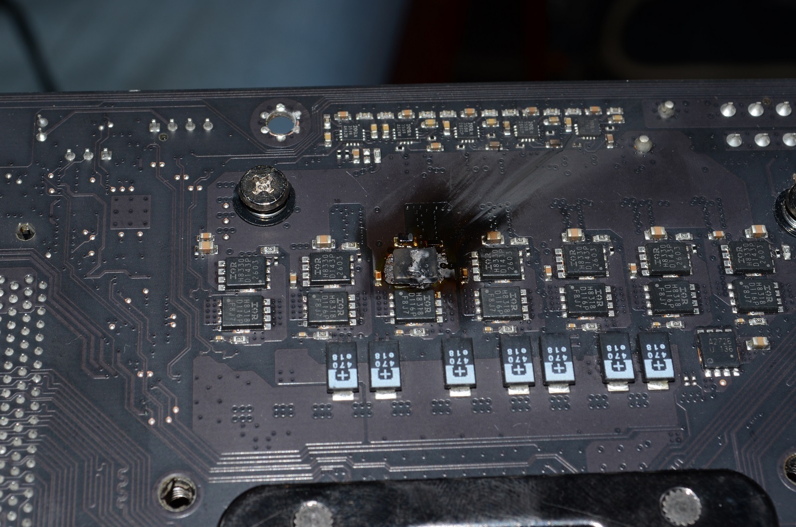

    I've got a Gigabyte X79-UD5 with burned VRMs, looks like this.
    How probable is it that the CPU survived (or not)??

    If on the high side, marginal. CPU would have been subject to +12V for at least a millisecond or so which would probably destroy it. If on the low side it might survive.

      Re: after CPU VRM burned, CPU still good?
      Well, it looks like that was the high side...
      The connector on the upper right corner is the EPS12V CPU connector, followed by a coil.
      So that burned one looks like it was on the high side...
        Those CPU PWM ICs turn the low side on if/when the output exceeds the VID value.
        Unless the low side completely opened up/burned clear and was unable to shunt the incoming supply, the CPU may actually be good.
        What error amp, especially one for a CPU regulator, is so slow and useless?
        It works much faster than that... Besides, the output caps have to follow the increasing voltage, so the change is not instantaneous. It might seem like that to us, but there's plenty of time for the error amp to back down the duty cycle, then ultimately keep the low side devices on.
        (The PWM IC drives the MOSFETs via dedicated hi/low gate drivers, but the effect is the same.)
          If the top FET is shorted, there is nothing the error loop can do. You will basically form a resistive divider with about 10mohm on each ladder. Output voltage will be briefly determined by the ratio of resistances. Most controller ICs however will rely on the body diode to commute an over-voltage event. Very few of them switch on the bottom FET during transients because it makes the control loop trickier to design.
            Originally posted by ADP3180 datasheet
            Output Crowbar
            As part of the protection for the load and output components of
            the supply, the PWM outputs will be driven low (turning on the
            low side MOSFETs) when the output voltage exceeds the upper
            Power Good threshold. This crowbar action will stop once the
            output voltage has fallen below the release threshold of approxi-
            mately 450 mV.
            Turning on the low side MOSFETs pulls down the output as the
            reverse current builds up in the inductors. If the output overvolt-
            age is due to a short of the high side MOSFET, this action will
            current limit the input supply or blow its fuse, protecting the
            microprocessor from destruction.
              As I said, this is a best case scenario. You've still got a large amount of bulk capacitance (PSU, probably at least 2200uF, plus motherboard and others) that will dump a lot of energy into the processor through the upper FET. And, you're assuming that the IRF devices (controller included) implement this function. As I said many controllers don't implement it because it complicates the control loop during transient response.
                Well, contacted Intel and they say, they're able to exchange my CPU. So it doesn't matter if the CPU is still good or not...
                  +1
                  I have an Intel DG33 that shorted it's upper MOSFET twice on me (after working for a few minutes each time). Both cases resulted in PSU buzz (i.e. short-circuit protection kicking in). After repairing those, I had a lower MOSFET short, and again the result was the same - PSU short-circuit protection kicking in. I though, man, that CPU sure must be toast now. So I decided to play with the board a little. I swapped the inductors with ones from a completely different motherboard (4-turn larger core in place of 3-turn small core), changed all high-side MOSFETs with different (but matching) ones. When I tried to turn on the motherboard, I got a nasty squeal. Then, I decided, screw it, let's see if this possibly fried CPU can damage another motherboard. So I took the CPU and tried it in another motherboard I didn't care much about. But what do you know? The CPU (Core 2 Duo E2160) was perfectly fine and functional, even after all of that BS.
                  As for my Intel mobo, I can't really say the same . All I know is, all gate drivers are fine. It just eats MOSFETs or squals or shorts out the PSU .
                  This is not my only experience with a chip that survived a shorted upper MOSFET. I also have an AGP GeForce 7600 GS that went through a bad MOSFET. Still works with my replacement 85 Amp MOSFET (vs. 13A for the original one ).
                    Yeah, got my replacement CPU from intel, was replaced and took about a week (and no cost for me).
                    The LGA2011 sys runs fine now with no real OC (well, I upped the turbo multi a little )
                                  I removed the defective MOSFET and the Board kinda works again.
                                  Do you think it's safe to use or not?
                                  • kaboom
                                    "Oh, Grouchy!"
                                    • Jan 2011
                                    • 2507
                                    That was the bad one on the high side, right? I'd x-ref a sub and replace it if that's the case. That regulator was compensated for its original complement of phases. Remove a leg and you'll suffer poor ripple and step-load response, as well as worse ripple performance overall with fewer phases. (see link)
                                    It could be enough to make your CPU cranky- a bit like a marginal O'C.
                                    I don't know what you mean by "the board kinda works." I presume this means POSTs, but not stable enough to finish booting. Or perhaps crashes once device drivers come up to speed, and start "pushing" the system.
                                    See Fig.4 on page 4- for a given duty cycle, ripple is worse as n decreases, with higher phase count giving smaller ripple-peaks.
                                    https://cdn.badcaps-static.com/pdfs/...398f5d4066.pdf
                                    If you can at least boot to a Memtest CD, replace that one MOSFET! Don't condemn the CPU or MB 'til you "feed the beast" properly.

                                        I thought I should ask here before trying to do anything else..
                                        As for the VRM thing:
                                        I kinda ripped the traces off the PCB, so soldering a replacement on it could be a little bit challenging (but not impossible).
                                        Seems like I shouldn't touch that board until I'm able to afford a scope and scope it, right?
                                        If there's any question about step-load overshoot, you might consider going into the BIOS setup and lowering VCore several steps below the default VID- again, just for testing and to check viability of the board/CPU. Since there were 12 phases, the output capacitance is rather small- no "huge" capacitors like in other boards. Do you know the TDP and Vcore of the highest-spec CPU that board could take? And if so, what's the TDP and VCore of your current CPU?
                                        Ripple/overshoot may not be a problem if you're far enough away from the maximum demand of that VRM. You're "ripple bumpiness" with varying duty cycle will not be as pronounced as the diagram I referred to earlier; you've still got 11 phases. While there will be a suckout during the missing phase's period, if your CPU doesn't pull VCore too low during this time and the loop remains stable, you just might get away with it.
                                        Remember, there were some weird ASROCK boards that dropped phases as CPU activity decreased. Those didn't work too well and could be unstable, since they were 4-phase designs that actually single-phased at times. As you can imagine (look at Fig.4 diagram for reference), they tended to be less stable at part-load, especially when those Evercons aged- more ripple for a given duty cycle, as N decreases. Supposedly, they were compensated so the loop didn't oscillate, but switching-freq ripple still made it to the CPU. Silly ASROCK!
                                        As for the board:
                                        it's this one and advertised to have 12 phases...
                                        Again, such tiny caps for VCore...
                                        Edit: Nevermind, looks like VCore caps are missing in those pix! Found a -UD3 board with the usual compliment of polies in VCore:
                                        http://www.amazon.com/GIGABYTE-GA-X7.../dp/B0064Z6YD2
                                        If your -UD5 has the same VRM as that -UD3, it'll probably be fine as long as your CPU is 11/12, maybe 10/12, the TDP of top-spec for that board. All those polies in parallel make a nice, low-z supply. Is it perfect? No, but it's what ya have to work with...
