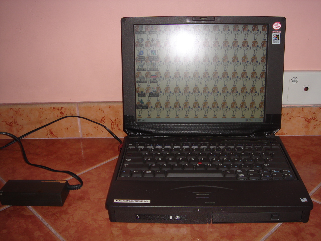

    Hello Everyone,
    I have found a Texas Instruments Travelmate 6030 series laptop under a pile of computer equipment at my friend's place.
    The laptop belonged to me before I gave it to him a few years ago.... before I even bought my trusty Dell inspiron 6400.
    It's a 1996 model laptop which i got in 2001 from the USA.
    It has an Intel Pentium 133MHz CPU, 72MB of RAM, 2MB Cirrus Logic Video, ESS 1788 Audio, 2 PC card slots, CD-ROM, 1.4Gb HDD and a 12.1 inch colour TFT LCD screen.... No USB ports though. I've got a USB 1.1 PCMCIA card somewhere.
    It's also got another 3 HDD's all 1.4GB and loaded with a different edition of Windows. Windows 95, 98 and NT 4.0 If I remember correctly.
    I feel that the Texas Instruments laptop is like one of those old vintage things that you can't find anywhere.
    I want to fix it up a little and use it with Linux or use it as a firewall. Only problem is the parts.
    I can't find spare parts for it anywhere. The screen is in perfect condition and the AC adaptor still works. The battery holds a charge of 45 minutes. But the plastic around the hinges are completely broken.... most likely because of the stiffness of the hinges. The hinge covers are also missing.
    I just wish that there was some very powerful glue that could hold the plastics and screws together.... I tried super glue and that didn't work either.
    But then again, my friend drilled though the plastic and put bolts in to hold the hinges in place.... so the plastic is practically finished.
    Does anyone know where I can find a suitable LCD housing?? Also, what version of Linux is compatible with this old vintage laptop??.

                As you can see in the image, the plastics around the hinges are all broken now. I think i'll have to get some epoxy and glue a piece of metal to the back on the weekend, then solder on a few small nuts to tighten the hinge screws onto.

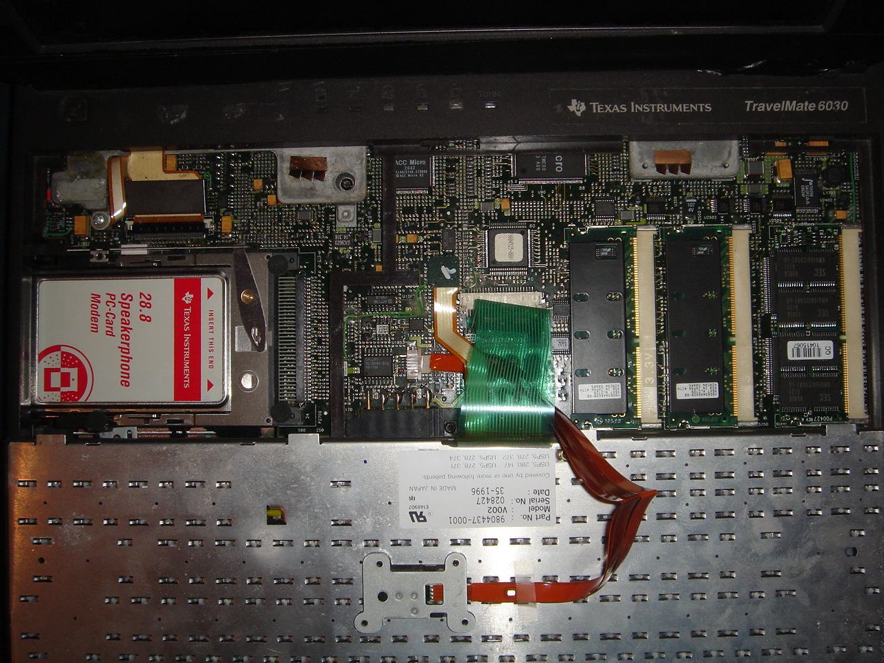

                        I took the whole laptop apart. I took a bunch of screws out holding the heatsink onto the motherboard and the chassis came loose.
                        I inspected everything and I found that the CMOS battery is leaking acid! its even turned the plastic around the battery a grey colour!.
                        Looks like I need a new battery....
                        I put it back together and everything works perfectly. Oh and the CPU is a mobile Pentium and soldered to the motherboard
                        Now I am going to look for a decent Linux OS.
