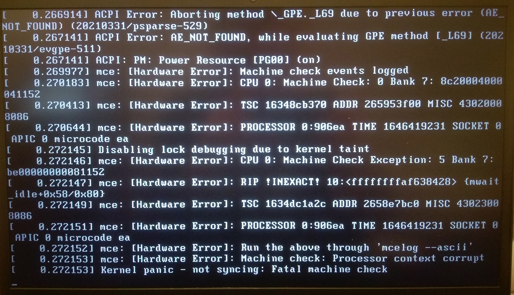

    this is a very strange Problem:
    Notebook hang instantly on Boot. BIOS is accesable.
    Windows: instant after showing "loading circle", even Windows Boot Stick hang instant (even without installed SSD/NVME )
    Linux: instantly (if Linux Boot in leagacy Mode with log messages: Machine Check exception after 0.25 sec)
    i have tried:
    - only one RAM Stick, another working RAM, both RAM channel
    - BIOS Flash to newest Version F.50, BIOS Reset
    - Memtest86 hang instant at Test 2
    - HP UEFI Diagnostic wont find any Errors
    - Error is persistent no matter conect/disconect internal Battery, Powerbrick or SSD/NVME
    - internal Voltages 12V, 5V, 3,3V, 1,2V RAM and CPU are OK
    The only Way to Boot is Linux Boot Parameter idle=poll
    If i boot with this Linux Parameter, the Machine is running rock solid.
    If i understand this parameter correctly, all internal power saving functions of the CPU are deactivated. I think that the CPU may be defective.
    The Error occured after some forced Shutdowns because the Cooling System was clogged.
    Anyone an Idea?

      Re: HP 17-cd0606ng no Windows or Linux Boot, exept idle=poll Boot-Parameter
      what does linux verbose boot show without idle=poll arg?
      try reset NVRAM as well
        Originally posted by echow2001
        what does linux verbose boot show without idle=poll arg?...
        This Message:
        I only found a description for a BIOS Reset and a EC Reset (disconect Power Supply an press Power for x Seconds), not for NVRAM Reset.
          I'm sorry, did you find a solution?
          I have the same problem, I think CPU is not good.
