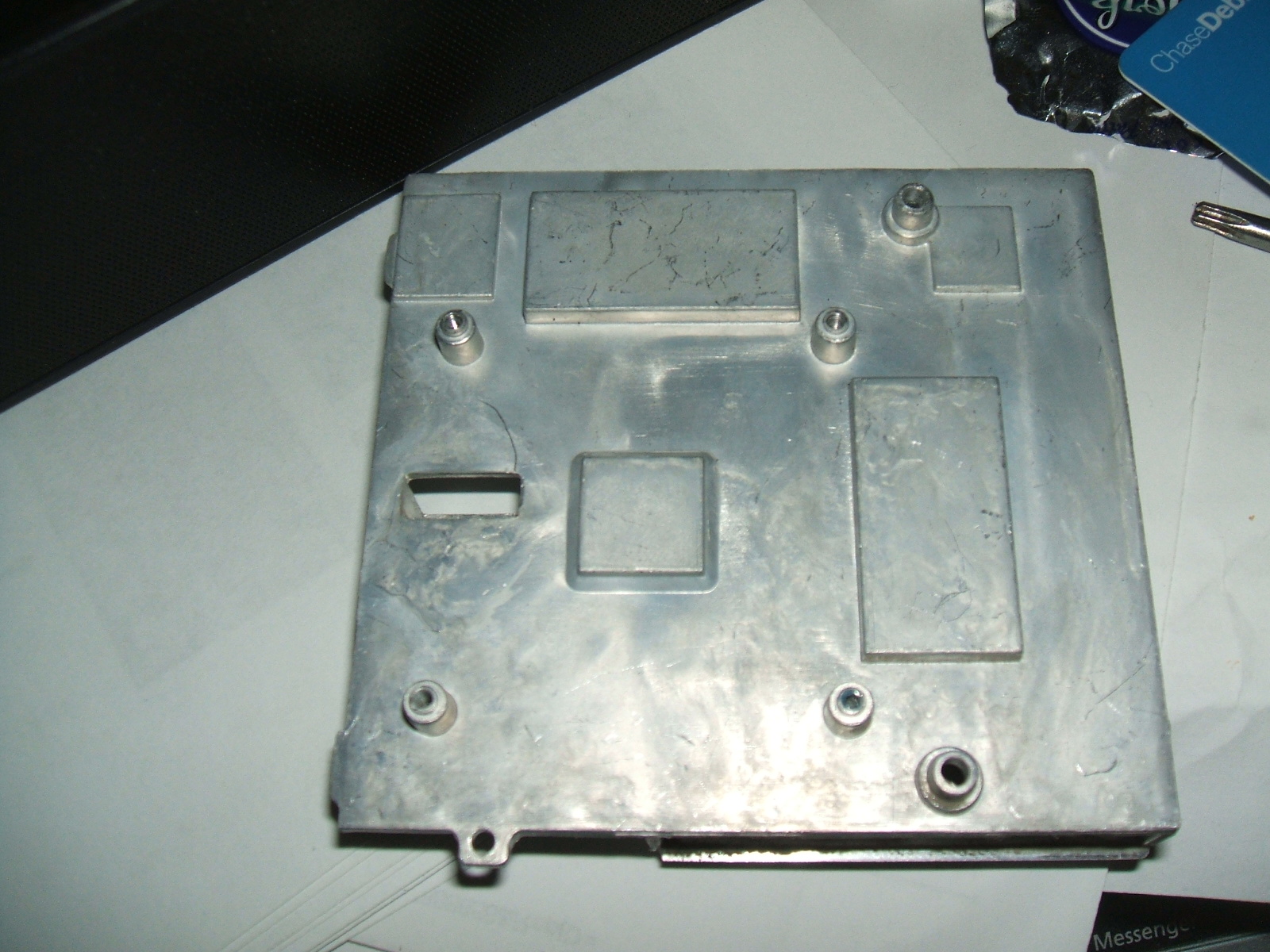

    I opened it up to find that despite that all of the GPU parts are there minus the GPU. Heatsink, fan, and all (no thermal pads, but I have some sheet stock I can cut from).

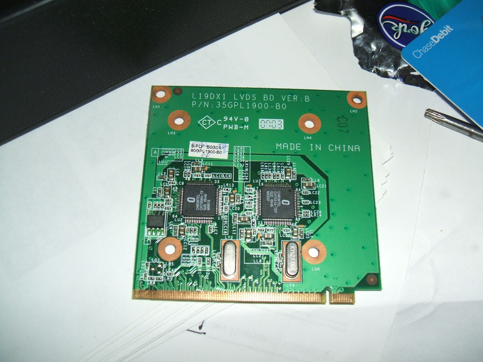

    what came out was this:
    (ignore the crap in the background, yes IK my desk is a mess)
    the chipset heatsink also had similar contacts for lower RAM chips.
    sadly these units are rare and "identical" GPU modules nearly impossible to obtain and they're pretty pricey (like $90 out of Taiwan).

    IMHO it's not bad for $30... it's a Quadro FX 770 aka a OpenGL optimized Geforce 9600. 512mb too. a far cry from the 256MB ATI x1600's it was designed for.
    It's a mod because I'll have to remove the 4 studs that used to hold the HP heatsink... nothing I can't do as they're usually press fit with a back bracket which I bet I could remove without too much trouble. I once removed some pressed studs from some socket 604 coolers (Ratdude's main rig V2) so IIRC some careful punch work will do the trick.
    Once removed, all I should have to do is cut new thermal pads and AS5 the die... and screw it on to the heatsink.
    To check before I purchased, I scaled the image to the dimensions of the dummy and HS and then compared them... the holes match up allright.
