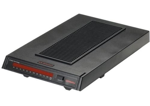

                            US Robotics Courier 56k modem is the one to get, built like a tank
                            I actually have two but I think shipping to Serbia might be expensive...

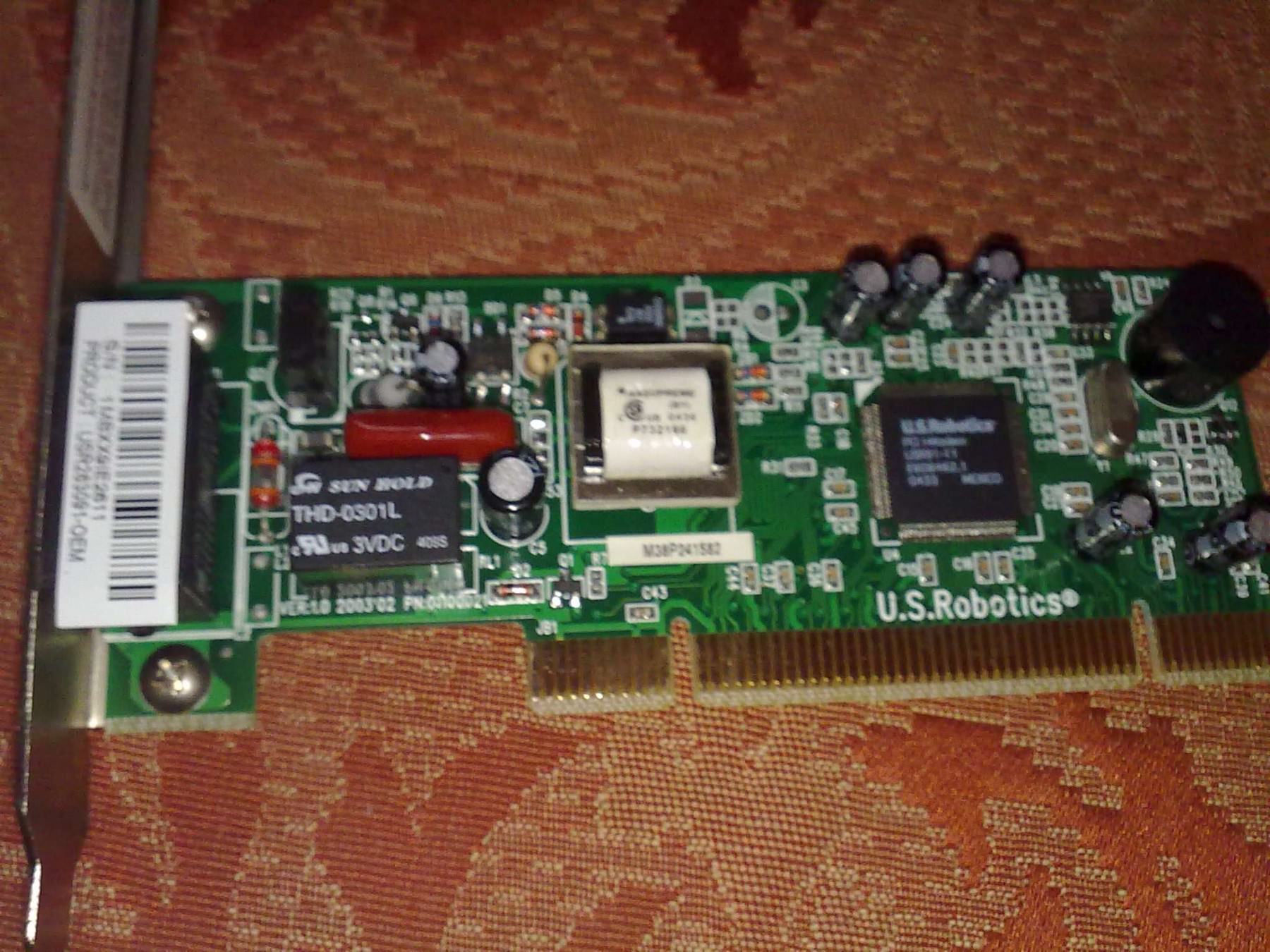

                                Thanks for the very nice advice, but I think that one would be to much for the occasion, I really need something that will occasionally be used to connect to the Dial-Up ISP for a minute or two.
                                But since you mentioned U.S. Robotics, I am able to get this one for 4$, is it still among the better ones:

                                        Well, I guess that might be the cause of malfunction. It turned out that it is the modem that has a problem. In the spirit of the forum's name, maybe a failed capacitor caused this malfunction, who knows. All the caps on this Lucent are GSC brand, though they are of too small a value to probably fail so catastrophically.
                                        Today I receiveved this used USR263091-OEM modem which was in total around 4$ with shipping included. It got installed without a problem - and it works, which is the most important thing. All Dial-Up connections now work and connect normally, speed is about 52kbps.
                                        Thank you all for the help and time, and for some great suggestions and insights - some of them did make me consider trying another modem and it turned out to be the case. Now I know I will have a back-up connection in dire situations.
