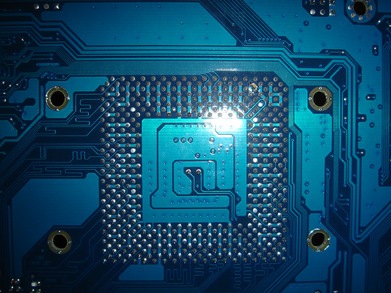

    Hello Everyone,
    I have a motherboard here with an AMD Duron 750MHz CPU pre-installed. On the PCB there are the words "V266B REV. 3.0" printed in white.
    From some information i've gathered, I think this motherboard is a Jetway V266B, the image on the internet shows a Jetway board with a green PCB, but the board I have here has a blue PCB.
    The PCB is a dark blue colour and the board has 1500uf 6.3V OST RLX caps around the CPU. On the VRM input there are 4x GSC LE 1500uf 16V caps. All the caps are in good physical condition which is strange for after 5 years of use....
    This motherboard belongs to my friend and he wants to trade it for my ever reliable Asus P3V4X motherboard.
    The only concern I have about this board is that there is an Multi-Layer Ceramic Capacitor soldered onto two pins on the CPU underside. Is this a factory fitted item on was it soldered on afterwards?? The soldering is clean with no solder blobs anywhere so I'm guessing it was fitted on in the factory.

      not unusual to see parts added to bottom of boards as a production change.
      sometimes to fix glitches found once they were sold.
      i add such parts when doing overclocking grade rebuilds or for high reliability.

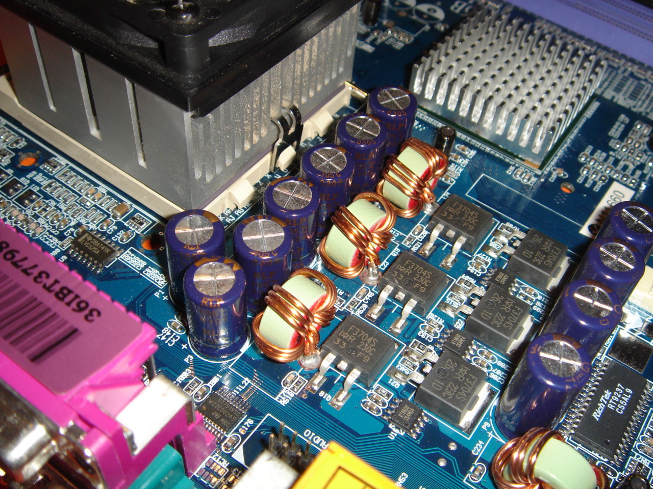

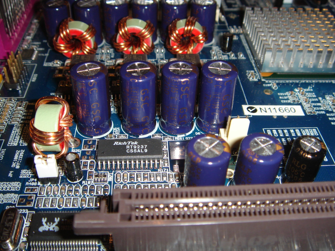

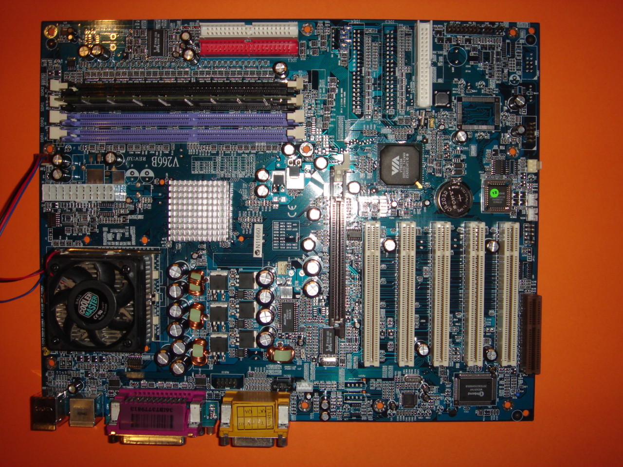

        Hello Everyone,
        I finally got around to uploading images of this motherboard. It's quite amazing to see that a whole row of GSC caps is still OK even though this board was made in 2001.
        6 years of use for GSC caps must be a record.... anyway.... there is an extra multilayer chip capacitor soldered onto the underside of the CPU socket.... Is this a factory thing or an aftermarket user add-on?? The soldering of the cap is very fine and very clean.... ao i am guessing that it was factory installed??
        The board is fine overall.... nothing wrong with it at all.... just the sight of GSC and OST caps make me wonder how long this board will hold up as for a daily use PC.
        Best thing about the board is that it can take both SDRAM and DDR RAM.... I just installed a 256MB chip of PC133 SDRAM to make it a little better performance wise.
        The only thing I have to do now is to find a new CPU. It currently has a Duron 750MHz.... I have to find one of them AMD Athlon ones that are over 1.2GHz.... Athlon XP I think they're called??
        I have no idea because this is the first AMD computer i've owned. Every other PC i've owned was an Intel based
        Does this board have a 3 phase VRM or am I counting the wrong coils??
