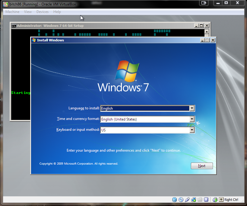

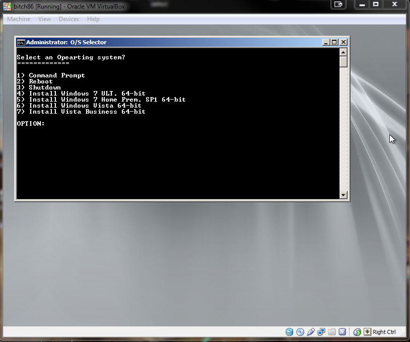

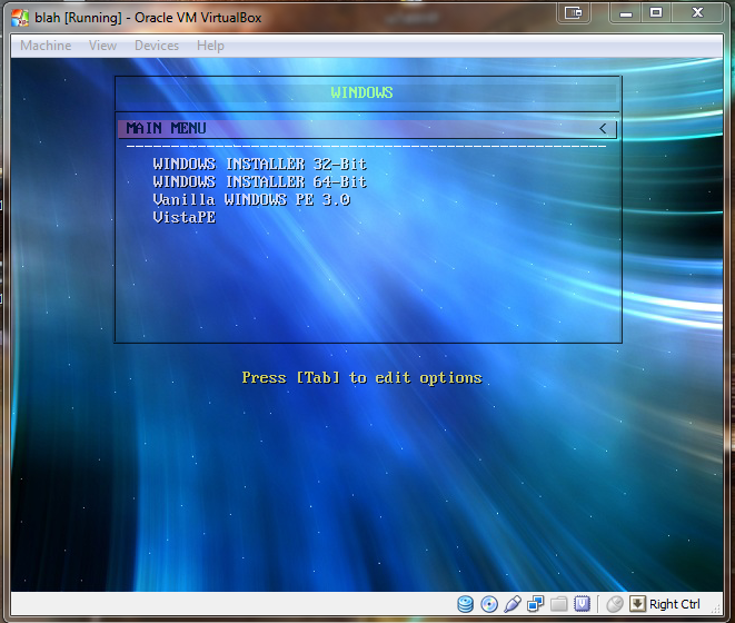

      I have a pxe boot server I built about 2/3 years ago. I got tired of losing install discs or getting to the point of scratched from over-use and wasting time burning new ones. Now practically all my tools are booted over the network and I keep a usb stick for off-site repairs.
      Essentially I built two PE boot discs from the Windows Deployment Toolkit now known as MDT. With a few batch scripts and a driver pack, one for 32 and one for 64. The batch scripts waits for the network to be available then mounts a smb share and loads additional batch scripts from the share. This allows me to change things without having to rebuild the PE every time I need add something to it.
      One of the batch script is the O/S Selector. whatever I choose, it calls for a batch script that then mounts another smb share with the windows setup files, and executes the setup.exe. Then fromt here typical windows install.
      I also got Windows XP pxe install, I have PE make a partition and format the drive and then mount the xp share, start the setup.exe and specify setup should copy the setup files to the drive. I enter in all the information I need. reboot, tell the famous blue setup to install to C: and boom done.
      The ISOs are about 150MB each, and tftp is butt fucking slow, so I use gpxelinux to grab the ISO from an http server. I keep the large files on a local webserver and linux live disc on NFS.
      It works well enough for what I do.
