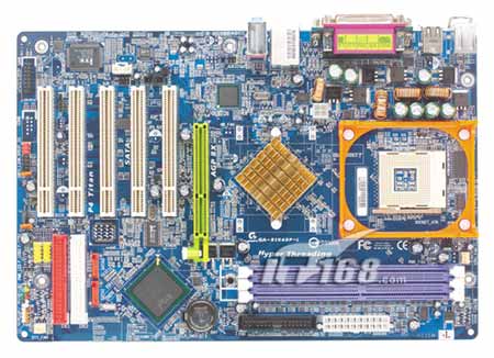

    Hello Everyone,
    I have a Gigabyte GA-8I848P-G which is inside a PC that a customer bought in recently.
    It exhibits this strange issue where I cannot get any Video signal on my monitor.... I cannot hear any beeps either which probably means that something really serious has happened. I have checked the board all over and I cannot find any burnt MOSFETS, ICs or electrical traces. The board it self has 3300uf 6.3V Nichicon HM(M) caps around the CPU (I know they are crap caps but these caps seem all OK) and there is also a bunch of G-Luxon caps scattered here and there.... they are all 1000uf 6.3V but are all in good condition, no bulge or leak etc.
    I changed the RAM, CPU, Video Card out and I got no change whatsoever.... there was still no video. I then changed out the Deer rebranded PSU and that didn't change anything at all. Next I tried to clear the CMOS by removing the battery for a while and that did nothing at all.
    I still get a blank video signal, but all the fans spin etc.
    I was quite curious after a while and decided to open up the Deer rebranded PSU and It had a bad Koshin cap and another cap that had just some awkward logo on it.... but that too was bulged and leaking.
    Right now I'm starting to notice that the southbridge gets really hot after a few minutes of bootup, in fact it even burnt me.... I'm not sure if the ICH5 southbridge is supposed to get that hot because it does get quite hot in my other PC with a Gigabyte 8IPE1000-G motherboard.... the ICH5 chip itself looks fine, no burn marks etc.
    I've fixed this same PC on numerous occasions for the same customer but it has never been this bad.
    Last time (less than a month ago) they experienced bad PS/2 ports but they were fine when I tested it out.... odd.
    I have tested the CPU, RAM and AGP Video card and they all work in my PC so it is safe to say that they are still OK.
    Right now I'm thinking that the Deer rebranded PSU caused all this nonsense but I cannot be sure.
    I am definitely going to change that Deer PSU for a high quality ThermalTake or a similar one for the customer.
    Oddly enough, the customer had told me that thier PC was working fine the day before and decided to use it the next day and the monitor kept saying "No Video Input".... I'll check with them again soon to make sure though.

    cheap psu sometimes overshoot on +5stby when the caps die.ala evilmachines.
    kills the southbridge.
    i have several imperial gx-xx series boards from emachines killed by +5stby overshoot from the bestec psu.
    one customer brought in an emachines box that melted its mouse to the mousepad and desk when its psu died.

      I have seen several of those boards dead, on back side around agp slot it is browned from heat. Not sure what is going on, but seems like a junk board.

        there's some fets between agp and ram slots

          Install a PCI video card and or test it with a Port80h diagnostic card
          It could be a million different things

              I have tried a PCI video card and I've had no luck whatsoever.... the display is still blank. I look at the MOSFETs around the CPU and they are fine because they havent meted or cracked at all.... but....
              When I look at the positions where the MOSFETs are from underneath, the PCB has turned somewhat a brownish colour on top of the blue PCB.
              From my experience, when this happens, it usually indicates that the MOSFETs were very hot at some point to make the PCB go a brownish colour.
              All I can guess now is that the Deer PSU was giving out very bad voltages to the VRM and caused the MOSFETs to overheat maybe??
              Luckily the 3Ghz P4 Prescott CPU is still working fine in my other PC with an ECS 661FX-M motherboard. It is currently running DSL Linux pretty well so that probably means the CPU is still OK. As for the motherboard I'm not even sure where to start fixing it at.... If that is even possible.
              I've inspected the 848P Northbridge and the ICH5 southbridge and it is not burnt at all but it does get quite warm, which is normal for these chipsets.

                  its not the cooling, its the demand it places on a shitty vrm

                                  Yes, the chip is internally shorted - this is usually caused by a voltage spike.
                                  It can be fixed - with hot-air soldering tool and replacement chip (and some practice).

                                    I haven't been back here for a while, but I got good news about this motherboard. The customer that bought this motherboard in, gave up on it and bought a brand new Pentium D 915 system based on the Asus P5PE-VM motherboard.... So they decided to leave this Gigabyte board behind.
                                    Even though the Gigabyte motherboard was nearly two years old and out of warranty, I actually got it repaired. Actually it was replaced with another one to be precise. I had to pay $30AUD for after service at a computer store and they sent it into RMA.
