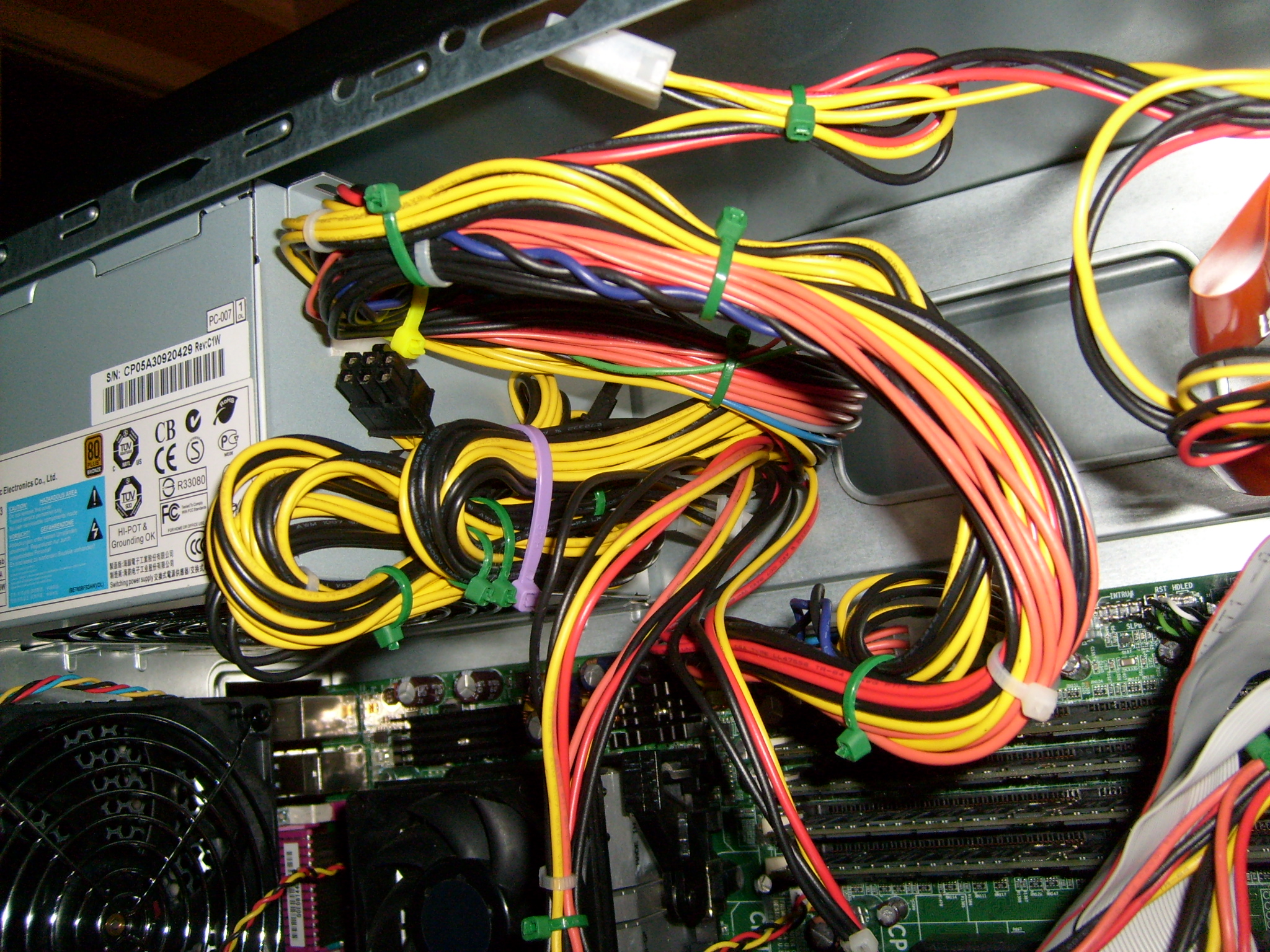

                            The PSU installed:
                            The HDD power bundle:
                            The cable management at the top:
                            I placed my zip tie buttons only on the PSU side, so the PSU can be removed w/o cutting ties.
