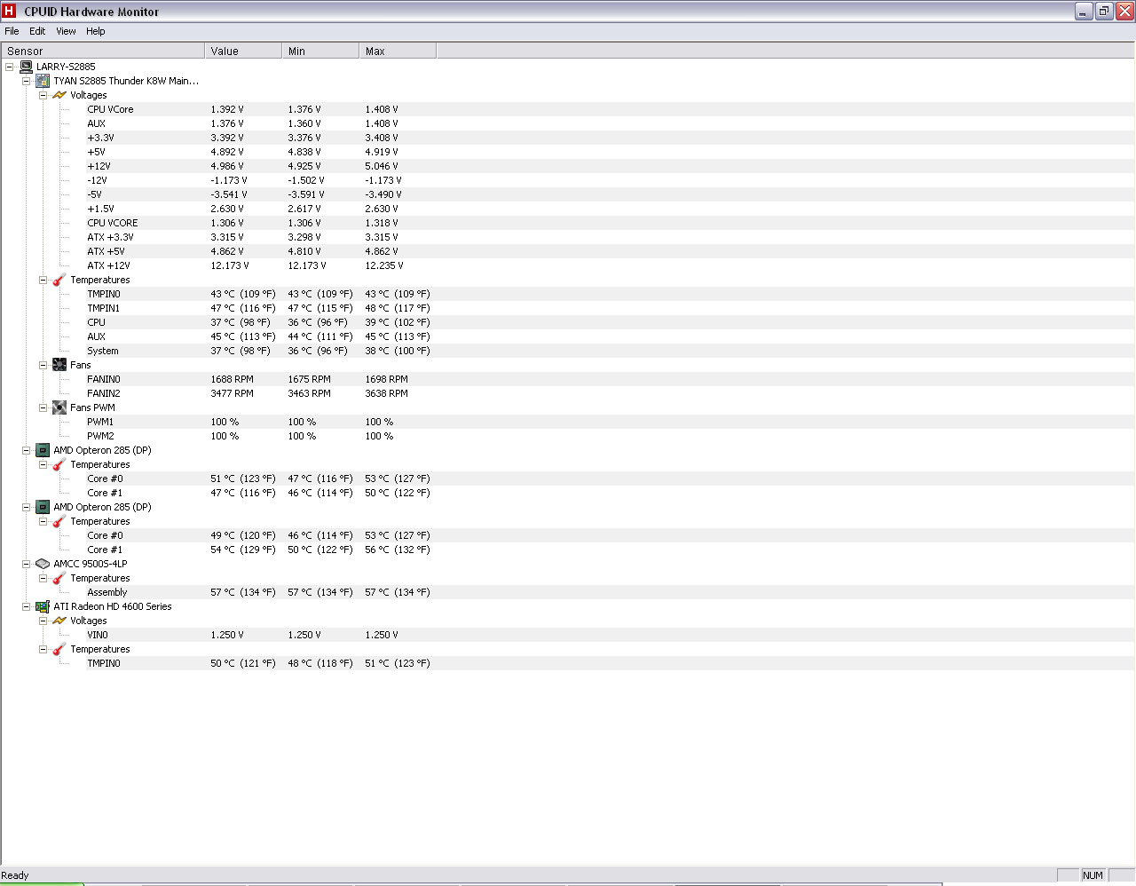

                                          Re: Ratdude's main rig V3, maybe
                                          http://valid.canardpc.com/2805965
                                          Runs great. will take pics in a bit.
                                          edit- attached my current temps and the like.
