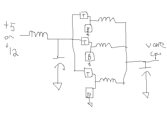

    I read a lot here about the number of phases on VRM circuits for motherboards. I'd like to know more about the differences between the different VRM circuit designs between different boards. How do I tell how many phases a particular board has? Don't some boards have multiple sets of MOSFETs but only one phase?
    I understand what the reason for multiple phases is (distributed load) but like I said, how do I know how many phases are actually on a given board? I should know this because I repair boards for a living, but I guess it's not something I've ever needed to know. But now I'm just curious, and it's always good to understand as much as possible about the things you work on. What I'd really like to see is some schematics of typical circuits.

    Well, the easiest way is to look for a set of toroid inductors (most common) that each have a set of FETs by them.. Some boards have 2 FETs per phase, some have three, which typically have two as bottom FETs, and one as the top FET, or even four FET's, with two top FETs and two bottom FETs.. There is also typically a single inductor at the input of the VRM itself, next to the input caps, that serves as an input filter for the VRM, in conjunction with the VRM input caps.. Then you have your FET/VRM phases, then the output caps, which are typically right by the CPU, and the high frequency filter caps, which are typically under the CPU in the "hole" in the center of the socket. If the board has no hole, then they'll probably be on the other side of the board.
    Most common number of phases on consumer level boards is typically three phase.. Enthusiast boards can have more, ranging from 3 to 8 phase, with phases of over 6 being less common and more likely to be found on high end boards.
    so the way the power gets to your CPU is this:
    + 5V or +12V ---> VRM input inductor---> VRM input caps -> multiple FET/inductor phases ----> VRM output caps..
    I've attached a quick sketch i did in PAint.. T is for Top fet, B is for bottom FET.

      The way it works is that the top FETs pull the inductor node up to Vcc, while the bottom FETs pull the inductor node down to ground.. The duty cycle of the FET's is controlled by a chip that connects to the gate of each FET, either directly or though an intermediate FET driver chip. The controller chip gets feedback from Vcore itself to determine the duty cycle of the FETs. For example, as CPU load inceases, the CPU sleeps less, so it pulls more current, which will require a higher duty cycle in order to keep it going.

        I see, it's basically just like the circuit in a common switching power supply.
        Was your pic showing a 3 phase or 1 phase circuit? Looks like one phase with 3 sets of FETs to me. Would higher end multi-phase VRM's have more than one output coming from the driver chip, each to it's own set of FETs?

          Err my mistake, the one input line in your pic is the +v input, not the driver line from the PWM IC.
            Yup, i didn't include the PWM IC..

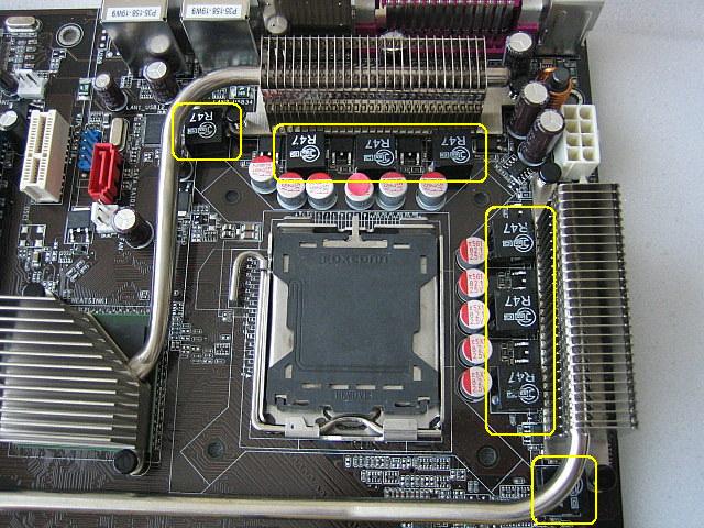

                Are these "R47" components VRM inductors and if so would this be considered an 8 phase? If this is correct how are they different from the green and copper coils of the above example?
                    Looks like 8 phase to me.. Can't see the FETs very well as they're under the cooling fins.. The input inductor is the unmarked vertical one by the 8 pin +12V connector. As for the R47 marking, i'm guessing that they're 4.7uH inductors..
