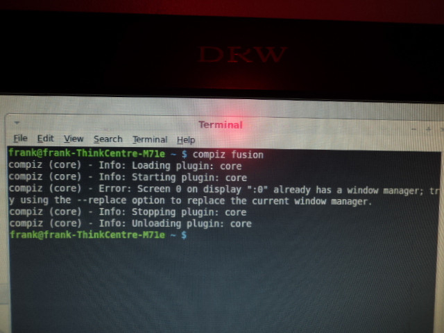

        Thanks Professor, i have this when i type ''compiz fusion'' in the terminal,
        what does this means? Thanks.

              Re: rotating screen on linux mint?
              http://community.linuxmint.com/tutorial/view/1148
              To make it easier on ya installing the packages...
              Code:
               sudo apt-get install compiz-gnome compizconfig-settings-manager fusion-icon compiz-plugins-extra libdecoration0-dev
              Install, enable and have fun!

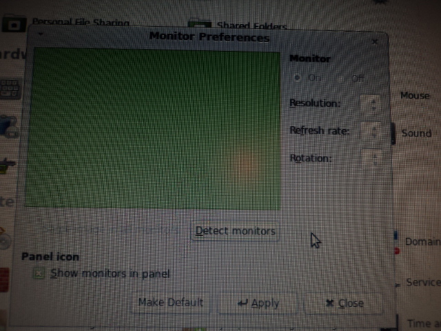

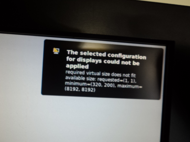

                    • ivtec
                      • Dec 2008
                      • 1967
                      Hi Professor;how can i load the driver for Intel in the linux,also can you be more specific on the enable cube sorry if I'm not that much savvy,
                      me again i get this on the screen when i try to aply on the monitor preferences, see atach.

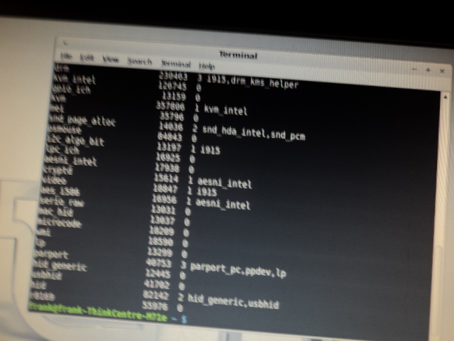

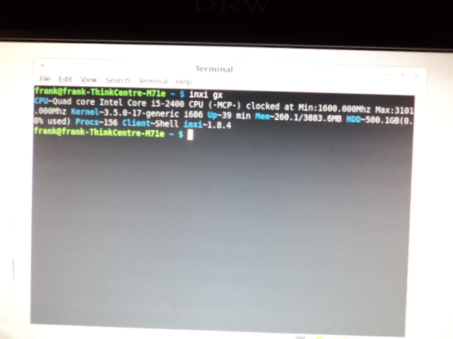

                        Run these in term and post back what you get.
                        Code:
                        inxi -Gx
                        Code:
                        lshw -C video
                        Code:
                        lsmod
                        I found another guide a bit older but worth looking at.
                        It should be under settings from the system menu called "additional drivers" or "restricted drivers" you can run a search from the menu to find it.
                        Then for compiz, you'll want to look for CCSM *CompizConfig Settings Manager* It too should be under settings or system control panel. This is where you select the options for compiz like rotating cube, wavy windows and so on.
                        I think you can run compizconfig in term for quicker access but I'm not sure.
                        Are you using dual monitors?
                        If not the it sounds like your xorg.conf is fubar.
                        Go to the display settings and reset your resolution then follow by restart.
                        if it doesn't work, post your xorg.conf from /etc/X11/xorg.conf
                        • ivtec
                          • Dec 2008
                          • 1967
                          [QUOTE=Mad_Professor;309648]Run these in term and post back what you get.
                          Code:
                          inxi -Gx
                          Code:
                          lshw -C video
                          Code:
                          lsmod

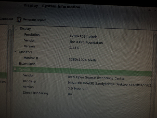

                            This one is from Display, System information

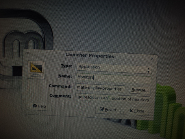

                            • ivtec
                              • Dec 2008
                              • 1967
                              Hi Professor It´s me again on video i was able to launch Properties,
                              i i can wright configurations on each box can you advise what can i write
                              TYPE
                              NAME
                              COMMAND
                              COMMENT

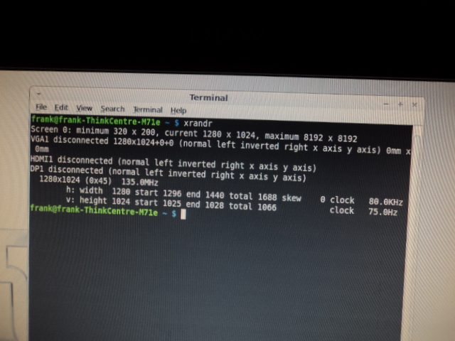

                                • ivtec
                                  • Dec 2008
                                  • 1967
                                  Hi guys it's me again,i have same problem again i type Xrandr and get the same as in the pic that i posted bifore,although the screen did not change and stayed where i wanted it, but can't control nothing as before,i had it but something is changing it,i guess if it changes i have to do what i did before change monitors and go back,it's kind of weird i don't know if it's the monitor or the linux software.
                                  https://www.badcaps.net/forum/attach...1&d=1359776823

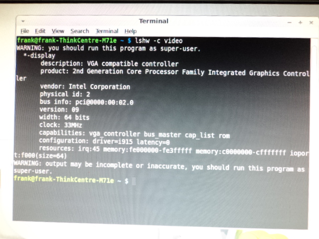

                                  • Time2Retire
                                    • Aug 2012
                                    • 256
                                    In the future, instead of taking a picture of your screen, copy and paste the text to the post. If you want to output the results of a command directly to a text file, do this:
                                    Code:
                                    lshw -C video > lshw-C-video.txt
                                    The file will be in your home folder. The .txt is just so Windows can recognize the file, and open it.
