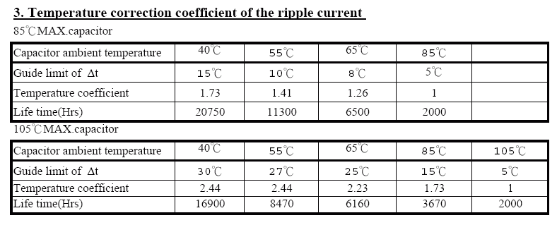

    Noome can tell you how lon a unknown cap will survie. There are caps with 1000h till some with 100 000h of live. You should at least tell the voltage, the series and capacitance. Than someone can give you a rough number. If you give the ambient temperature inside the psu too, there are some exact formulas to calculate the lifespann of the cap. Any way, considering that it is probably the lowest usuable lifspann caps i can immagine from a good brand i think it is at least 2000h 105°c rated. If ambbient temp in PSU is abouth 45°c it should be good beyond 1280000h or abouth 14 years of 24/7 use. So i guess they should surpase the warrantly easily. But remeber, any 10°c higher ambient temp in the psu will half the lifespann.....tus if caps are getting hot, the usuable live can easily drop beyond a year, no mather of good or bad brand.

          There are life estimation formula of the aluminum electrolytic capacitors. If you care to do the math, this is document that might interest you:
          in quote:
          The life of the aluminum electrolytic capacitor is influenced by an ambient temperature, a ripple current, and an applied voltage. Especially, the ambient temperature and the ripple current are the main factors that causes wear-out failure. Applied voltage does not influence life time too much if an applied voltage to the aluminum electrolytic capacitor is below0.9x the rated voltage.but can be a factor of sudden failure.
          This is applyed to panasonic's high voltage capacitor (from 160V to 550V):
          I was expecting a 2x lifespann if temp decrease every 10C, but there is a "multiplier" coeficient.
          Maybe for lower voltage capacitor, there is another different calculation..
