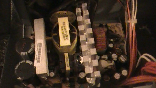

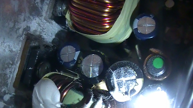

    So, the power supply in my main rig (Dell OptiPlex GX620) has been working fine. But, it makes weird buzzing and squealing noises. I opened it up and found a bulged OST cap on the secondary side. Could this be the problem?

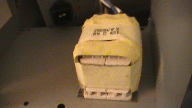

    The insides look kinda shabby to me. Small heat sinks and interestingly, another transformer mounted on the cover. Let me know what you think.
    Possibly. On my friend's Antec 350 power supply, it was a small startup cap 22uF 50V if I remember correctly. These smaller 6mm caps never usually bulge though.

      Could be the bulged cap, although OSTs are known for failing without showing any physical signs so if you have one bad cap you may have others that aren't showing it, so it would probably be best to replace all caps from suspect brands.
        Okay, I guess I can try that. I just have to get ahold of the caps.
