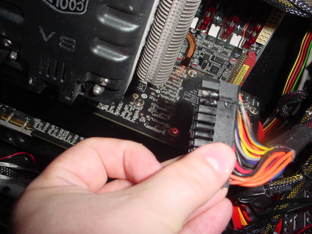

    soooo. my gaming box is dying. I've been pushing this i7 920 (D0) hard, 4.1ghz. Two BFG factory OC'd GTX 285's, and a corsair 850W power supply. I was running it hiiigh voltage, 80-82C under full load (D0 version of the 920 runs this hot, and will only run @ 4ghz under higher voltages)
    so earlier this week, it started doing this thing, where it would TURN OFF...then turn back on 3 seconds later. And some games started to lock up. Now I tried to play a multitude of games to narrow the problem and I narrowed the problem down with STALKER (chernobyl). A few seconds of gameplay the audio started to beep and buzz and boop in random speakers. Realizing I put an Audigy 2 between two high clocked and VERY HOT video card. I cooked this card. I thought--awesome problem solved.
    next night, after I put it into sleep mode, went to subway, came back and it was off. I hit the power button and it came on for 2 seconds and turned off.
    Freaking out I tried switching shit out, not much to switch out, took one video card out, same thing. Disconnected the ATX power connector and reconnected it and....turned on! wow how awesome. Hmm, maybe somethig is loose, so i looked on it aaaaand...one pin had a black burn spot around it, and the pin on the connector from the power supply had hardened, burned plastic, and the wires are darkened. WHAT THE FUCK. This motherboard was $300 and power supply $300. Was I running it too high?
    here is the pinout
    http://www.smpspowersupply.com/connector_atx_pinout.GIF

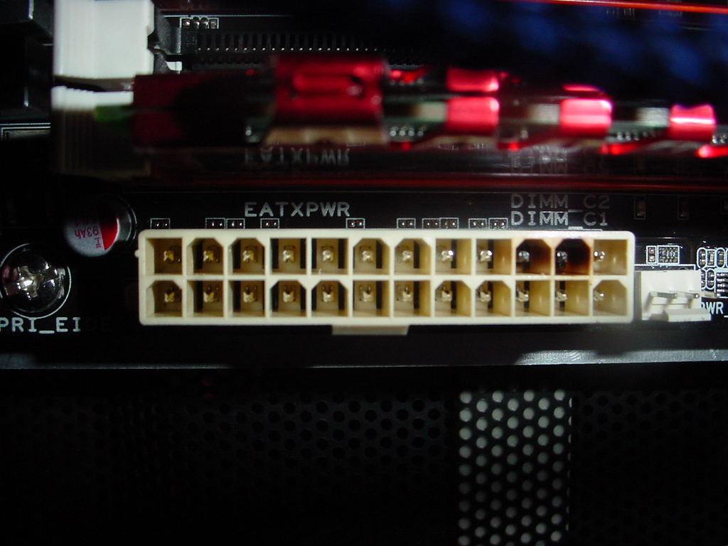

    its on one the extra 4 of the eps, the +12v1
    I took a pick and cleaned it up, the cmos was reset, set that back.
    today I plugged it back in, and it did not post. I took the power connector off and the 12v1 next to it was starting to get black

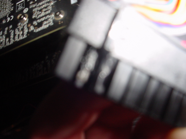

        Probably the motherboard. After all, it does look like an ASUS
        The two burned pins are the +12V ones, so the board's been drawing too much current from that rail

          The second pic is shitty but I would say your mobo has been sucking a lot of extra current from your PSU through those pins - the burnt condition of the male pins/female sockets will create more resistance to the current flow so things will almost certainly only get worse. Your mobo and PSU are more than likely still OK.
          If it was me I would replace the loom/socket from the PSU and the corresponding PCB plug on the mobo.

            The problem is the connector the pins that are black are arcing I would bridge the connections end of problem.

                  Ok... so it's clear those are 12V wires.
                  The problem you have is most likely caused by the fact that you have two video cards installed in your computer.
                  Video cards are supposed to draw up to 75 watts from the PCI-Express slot and whatever extra they need from the 6-pin connectors (75w each max) or 8-pin connectors (150w each max).
                  Each of your video cards draw up to 190 watts so technically, 150w come from the 6pin connectors and 40 watts from the motherboard. In reality I suspect more power is drawn from the PCI-Express connector so I suspect those 2 wires from the ATX connector were simply overloaded.

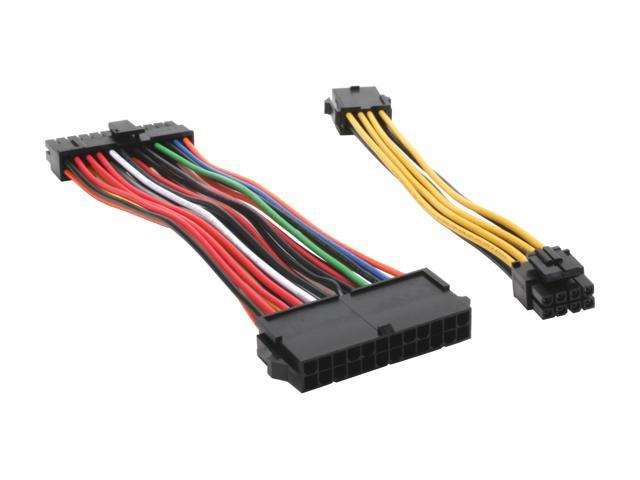

                  What I would do now would be to clean the contacts on the motherboard connector and use one of these :
                  http://www.newegg.com/Product/Produc...82E16812162006
                  This particular extender takes the 24 pin ATX and at the other end there's 20+4 so you still have 2 yellow wires there.
                  There are cheaper models that have 20 pin input and ouput 24 pin by connecting both yellow wires to a single cable - this is bad but it's fixable for example by taking the yellow wire from a HDD power connector for example and connecting it to the second 12v power wire in the connector. But even so, usually the wires in such 20 pin to 24 pin adapter are thin, and if your current power cable started to melt, those adapters will melt even faster.
                  The Silverstone cable above looks like it had decent gauge and has the wires separate from the start.
