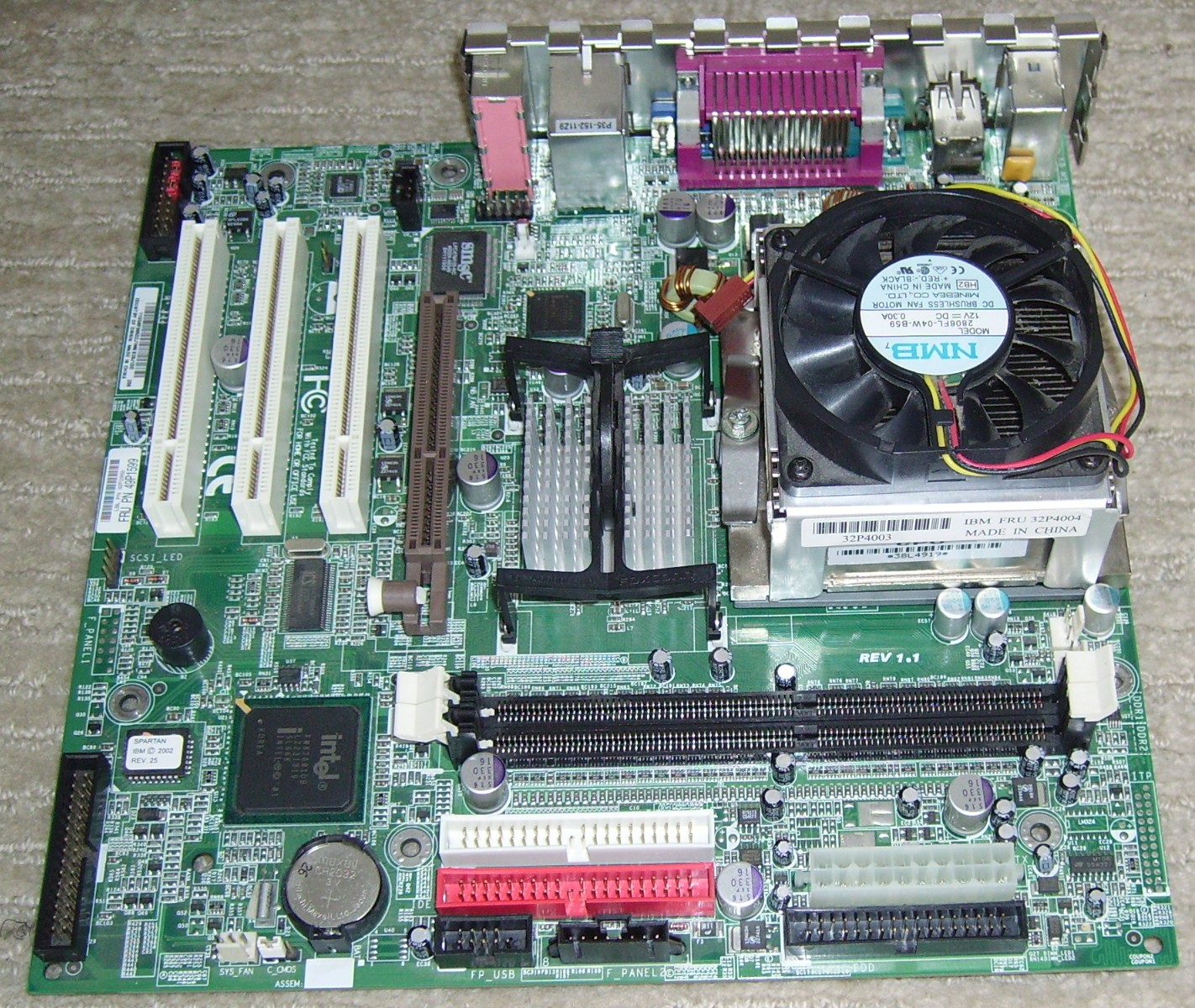

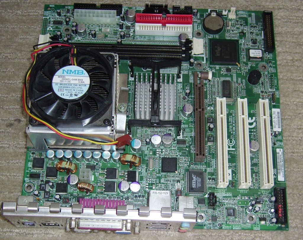

    It may be nearly obsolete, but at least it's indestructable It's a P4 2.66GHz s478.
    When I first got it, it had 330uF 25v GSCs as the small caps scattered throughout it (and remarkably, only was was bloated) with some rubycons on the VRM.
    I decided that 25v was overkill, since you don't get higher than 12v on a motherboard, but then I thought hey, it I'm gonna use 330uF 16v caps, why not go poly, and that I did.
    I used 330uF 16v sanyo SEP polys to replace the GSCs. There was one 680uF 6.3v cap there, but it had a blank spot right next to it (which was in parallel with it), so I just filled up the blank spot.
    The CPU VRM high got 470uF 16V Sanyo SEPC and the CPU VRM low got 820uF 2.5v chemi-con PSA.
    There were 3 1500uF 6.3v ruby MBZs on the other side of the CPU socket (between it and the DIMM slots). According to my DMM, they were only getting 0.6v, so I decided to use the same Chemi-con PSAs as I did on the CPU VRM low side.
    EDIT: there was 1 3300uF 6.3v MBZ near the northbridge. It got replaced with a 1500uF 6.3v Chemi-con PSC
    Ahh, I love looking at a motherboard and seeing nothing but polies. Thanks Topcat!!

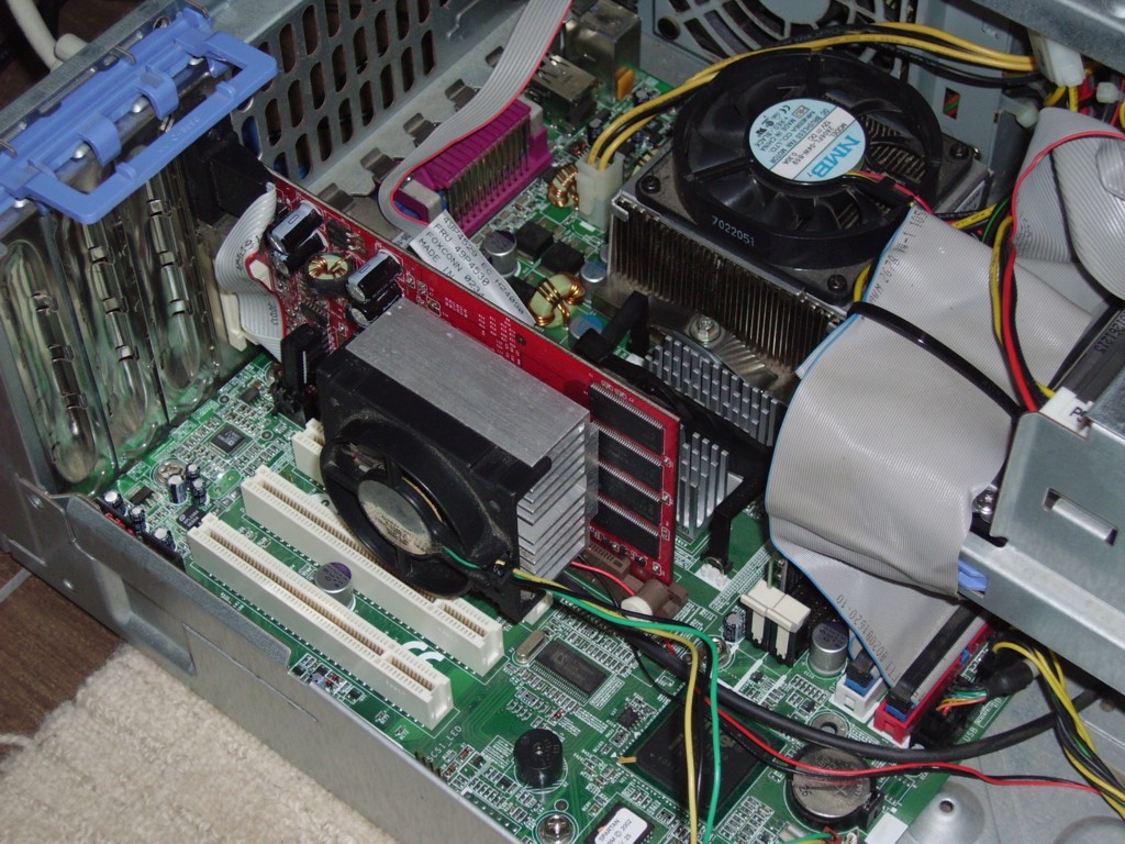

    Back in the case (and yes, that is a pentium 3 stock cooler on the graphics card. I stuck it there with some Arctic silver epoxy after the original fan failed)

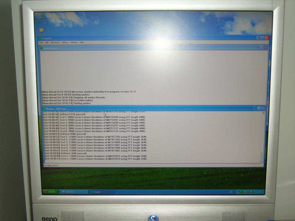

    Stress-testing away. It's been going strong for about 24 hours as I type this.
