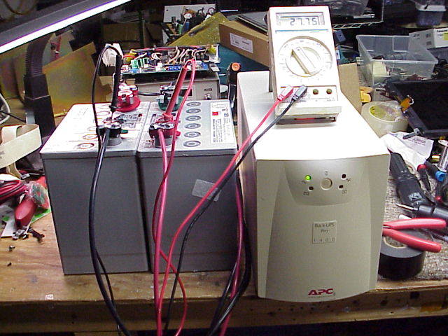

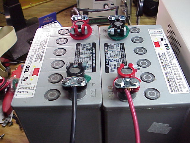

                      i am sure you can do this.
                      most apc units do well even with bigger batts.
                      i have a 2000 with 4 8d agm on it.
                      even with the 22nf in the pic iots good for several hours if you kill monitors and such on the server.

                          Just be careful, some UPS units charging modules are not too kind about hooking up to many batteries, it can become overloaded by having to work longer than it was designed for...
                          Best to use a UPS that supports adding external batteries...

                            I've only read about ppl doing this and charging would not be an issue with heat build up,imho. When a stock battery starts failing, it would be taking a charge constantly because it could not gain full voltage to resist the charging voltage. I would guess charging current at no more than 1.5A and probably less, even as low as 0.5A.
                            I see the problem of heat gain during prolonged battery run time. Adding heat sinks and a fan to a UPS that doesn't have these inplace would keep the thermal switch from shutting the unit down.
                            I do realize the high end APC units do have fans.
