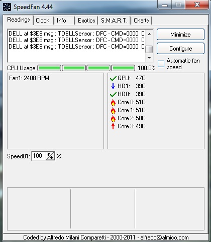

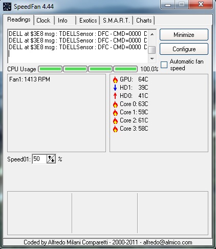

                          Here's a screencap of speedfan with my fanspeed set at 50% (the dell default). Processor is a Q9650, and it's running F@H
                          And here it is at 100%, after the temps stabilized (about 20 minutes)
