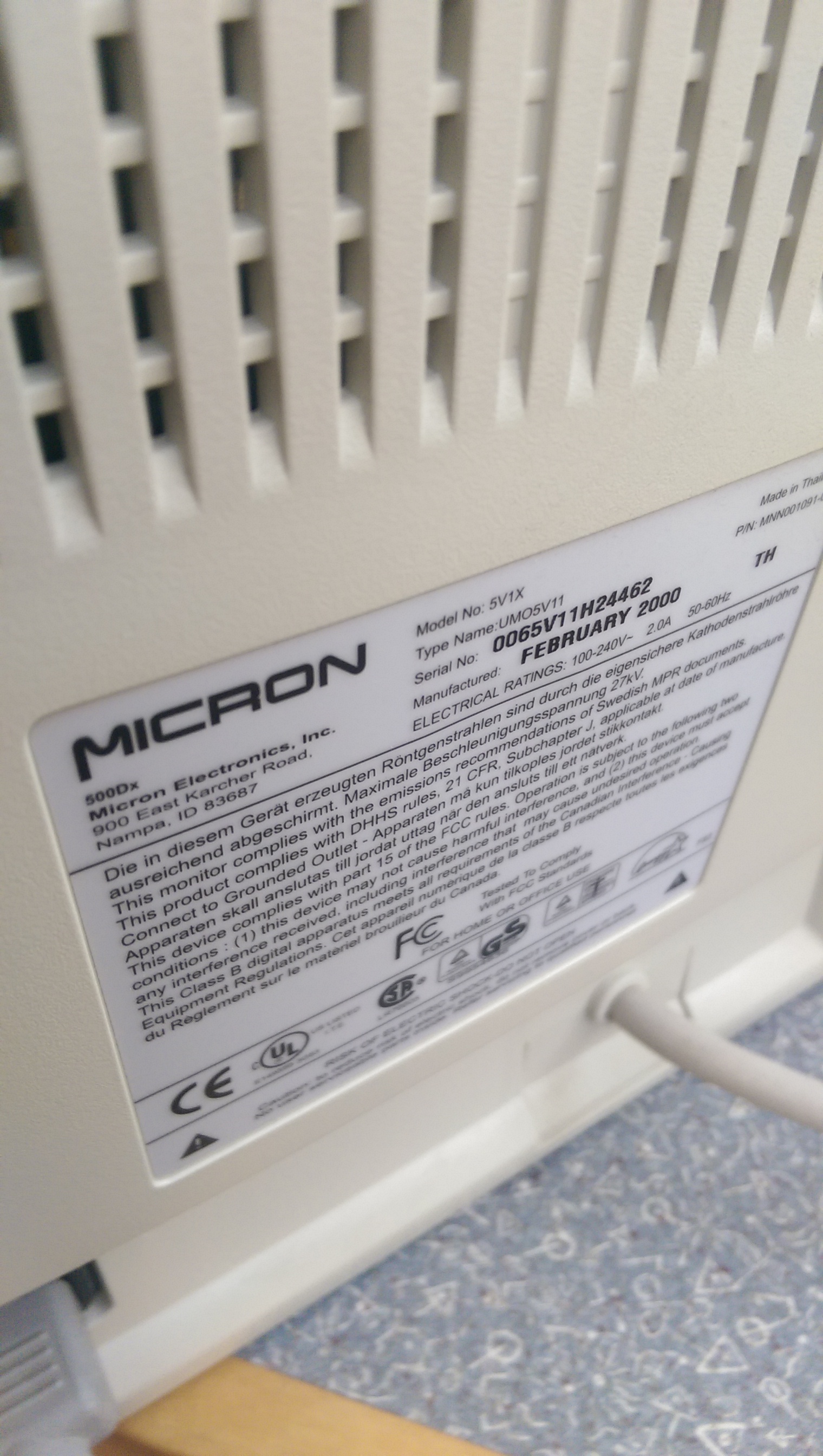

                                        I spotted this thing in the music store the other day. I of course went straight to the back of it and was really surprised. a Micron CRT?! Never knew they ventured in that area. Maybe it's rebranded? There is almost zero information on it. I gladly accepted the weird looks for admiring this old thing in the store
                                          Just to make sure... you're not confusing that with Macron (the PSU brand), are you?
                                          I'm not too surprised to see a Micron CRT. They also had cases, keyboards, mice, and probably some other hardware with their brand on them. Not sure who made it for them, but they were usually decent quality as far as I remember. When I was in middle school, all of our classrooms were equipped with Pentium 3 Macron PCs, Macron CRT monitors, and Macron keyboards.
