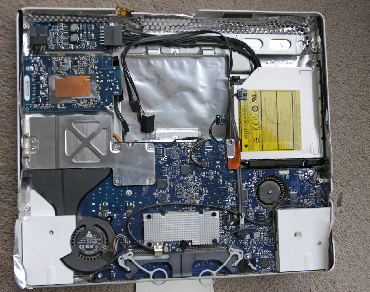

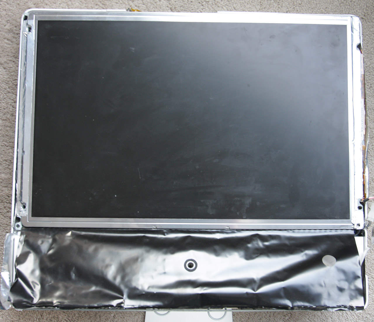

        Re: iMac iSight PITA.
        OK here's some mediocre pics
        36 Monitors, 3 TVs, 4 Laptops, 1 motherboard, 1 Printer, 1 iMac, 2 hard drive docks and one IP Phone repaired so far....

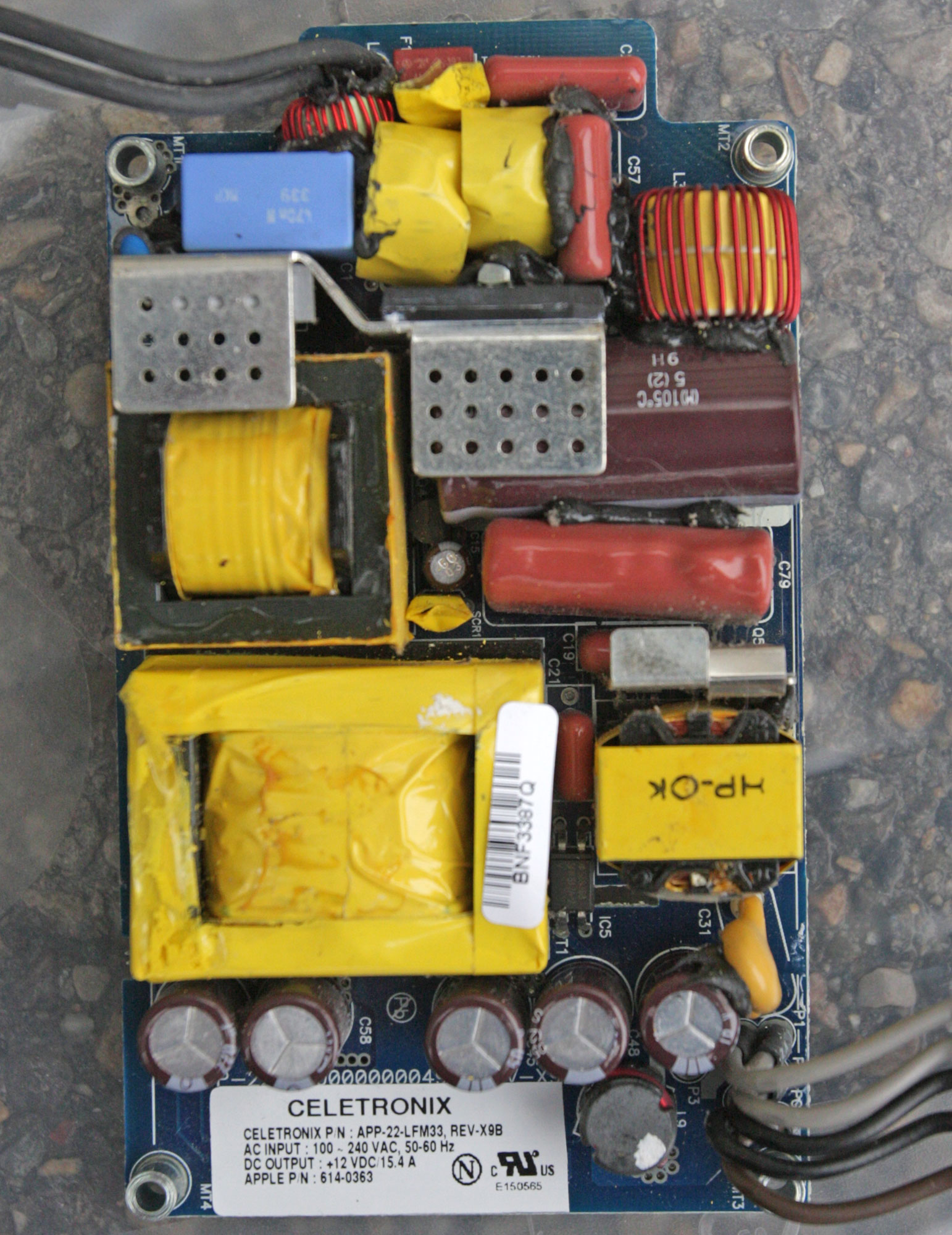

          Celetronix! RUN AWAY! RUN AWAY!
          Is there a standby voltage?
          What are the output transistor numbers?
          Measure across output on each rail to ground. If low or shorted, it's the same deal as the G5 Celetronix PSU, and you've found your problem.
          Toast
          veritas odium parit
          • smason
            • 1652
            Yeah I had a shiver run up my spine whan I saw the label. Haven't done any measurement yet. Will get to it some time next wee, betweenk monitor repairs.

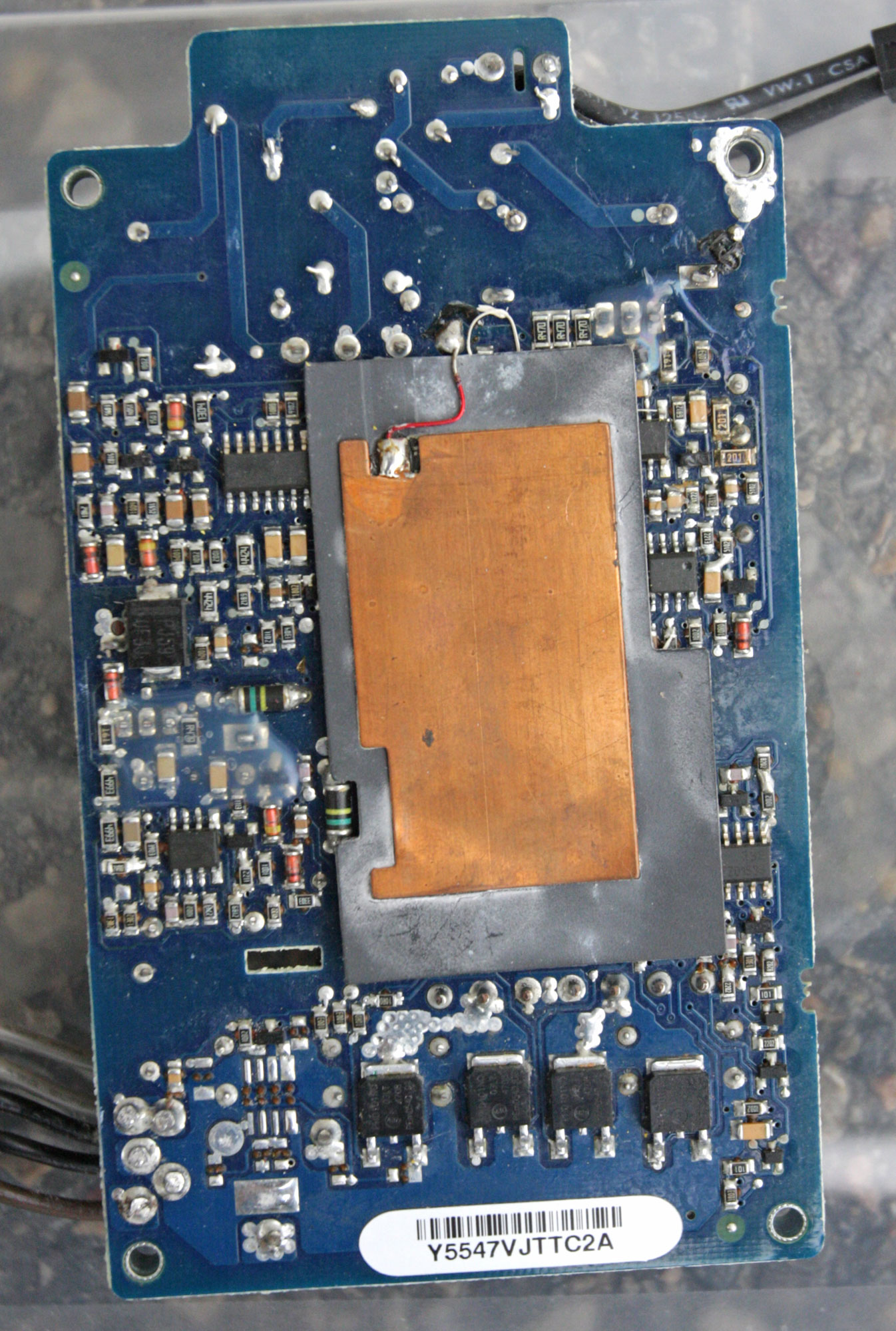

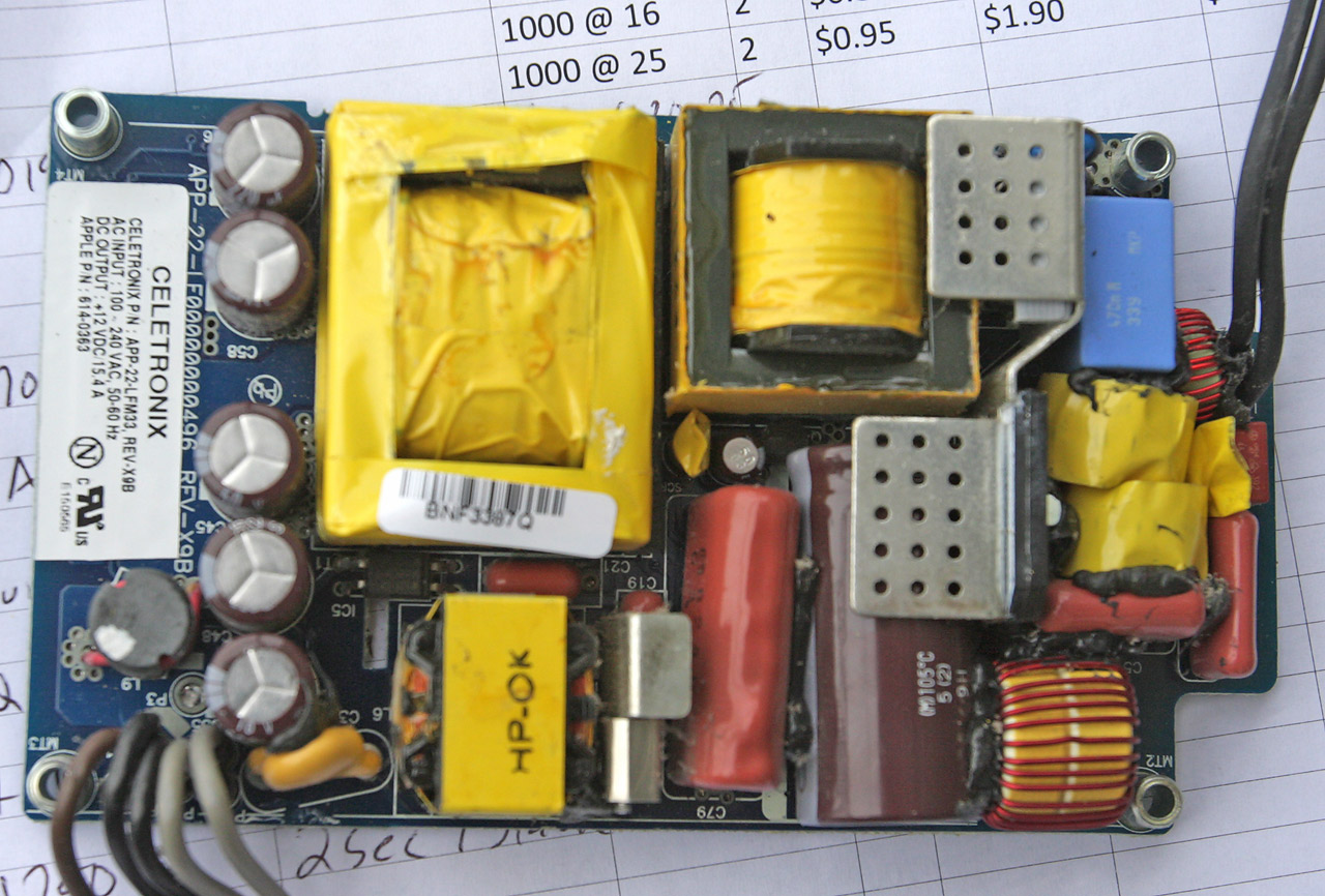

                  OK, time to finally take a close look at this Celetronix supply.
                  Initial disconnected tests, nothing shorted, outputs are all pretty high resistance to ground, and each other. Caps in-circuit test very low esr (probably in parallel) and capacitance is up around 1500uf.
                  Will apply AC and a load and measure outputs after dinner.
                  Not sure about the copper plate on the solder side, heatsink or rf shield? Either way seems to be glued on. Will need it off to test/replace the startup cap.
                  A few photos till I get some measurements:
                  • Toasty
                    • Jul 2007
                    • 4171

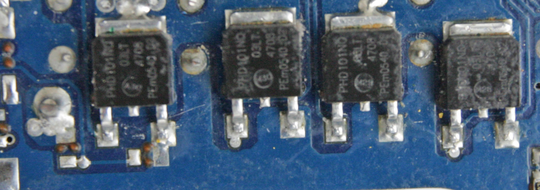

                    lol
                    Same outputs as the G5 PSU. PHD101NQ03LT
                    Please make sure the load is applied before power up. I think that's one of the causes of failures in the G5's after output replacements.
                    Toast
                    veritas odium parit
                    • smason
                      • 1652
                      Ok, wired a 1157 across the output, and connected power.
                      Ticking sound, no voltage on the grey wires (where load is connected) pulsing 12ish volts on the brown wire.
                      Guess it's time to peel that plate off and see what's under there that could be shorted.

                                    • smason
                                      • 1652
                                      For fun I put my semiconductor tester on the FETs. It said they were shorted D to S but I don't think so. Pulled 2 of them (man they're a bitch to desolder) and they test fine.
