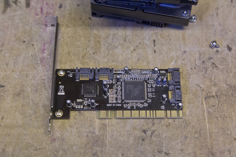

    Silicon image Sil3114 bios update
    Does anybody have update for these? It does not support over 500GB HD's.
    AM29F010 memory chip.
    I found some but those didn't work.

    Re: Silicon image Sil3114 bios update
    That's a really old chipset. I remember those back in the XP days....and when transitioning to 7, driver support was also very sketchy. I don't recall diddling with the firmwares for these. Is there something specific you need this controller for?
      It was in my backup-computer. Needed to build a new one. Probably e-waste then.
        bound to be a card out there with LBA48 bios on it.
          have u checked the vogons forums? they have a number of threads there with firmwares for the sil3112 and sil3114 pci raid cards. VOGONS Vintage Driver Library - Silicon Image SiI3114 file collection 101.49 MiB
