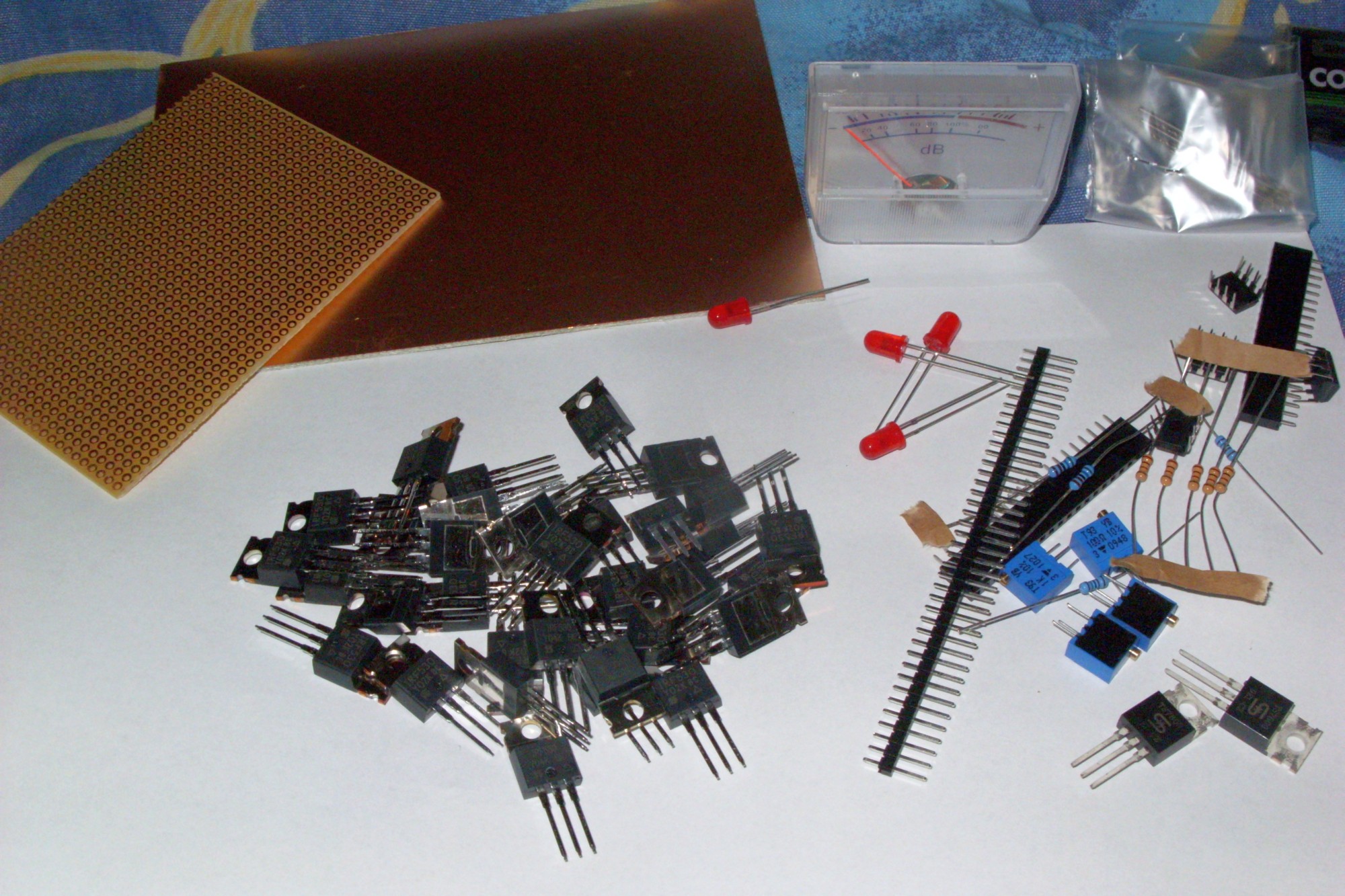

                                Heads up, here comes the first batch of parts. And btw, i found $3 meters. They will obviously need new scales but that isn't a problem. They happen to also be the right sensitivity for my ESR meter and are large enough to read comfortably (though not as large as i'd like, but oh well).
                                They only had one in stock, which will go into my ESR meter, but i placed an order for eight more. Looks like we will have analog ripple meters after all.
                                Also i ditched the idea of powering the electronics of the tester from the 5vsb rail, because this would make me unable to meter ripple on 5vsb, which is quite important. I remembered i had a small 12-0-12 mains transformer, it will do nicely if a little high, so more heat to burn for the 7809 regulator, but at the amount of cooling this thing will have, it won't be a problem. Oh yeah and i bought two 7809s. 3A oughta be more than enough for running 8 fans and a few opamps.
