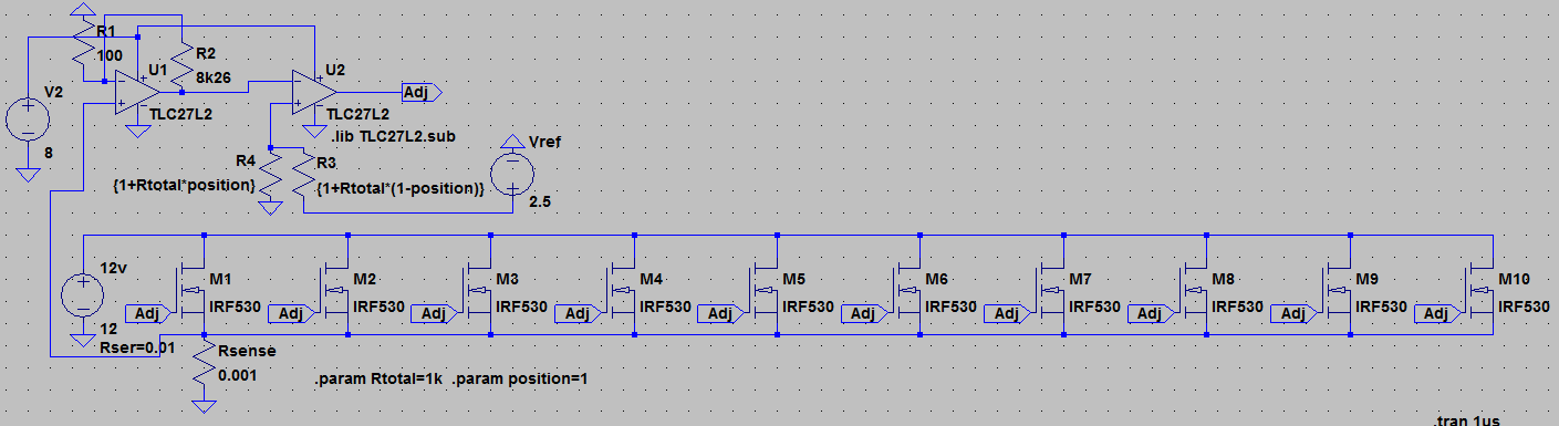

              More like $10 each here. So cost wise it was cheaper to do it all with semiconductors, even if it involved a significantly higher effort (designing the circuit to drive and meter them).
              However in the long run this will be offset by the value, the circuit is very versatile, and will be able to test any type of power supply not just computer PSUs. If i need to test PSUs with more than 100v output i can simply buy higher voltage transistors on demand, since each of the 4 rails will have an independent monitoring circuit i can just upgrade them in groups of 4, 6 or 10, not all 30 at once.

                      Well my good meter only goes to 10A as well (the 20A one isn't that accurate), but since all PSU testing is done in 1A increments that wouldn't be a problem. At most, it'll be 1A off which on 12v that means 12W, on the other rails even less. Not a big deal in my book. So the calibration of the load tester itself won't be a problem. The ripple meters will be a bit more difficult to set up though, but you can simply use one of those USB oscilloscopes instead. Disadvantage - you would have to move the probes for each rail.
                      Originally posted by shovenose
                      um, ok...but i have given up trying to figure out all your complicated mosfet stuff and i may (if i do end up making any kind of psu tester), go the resistor route
                      Well y'know, if ya don't try ya have no chance to succeed. When the PCB layouts will be posted i'm quite sure they'll shed more light on everything. In the meantime here's the schematic of the 12v load tester. The others are the same just with less MOSFETs and different R2 values. Btw, R2 is a resistor in series with a trimpot hence the funky value. R3/R4 simulate the 1k potentiometer.

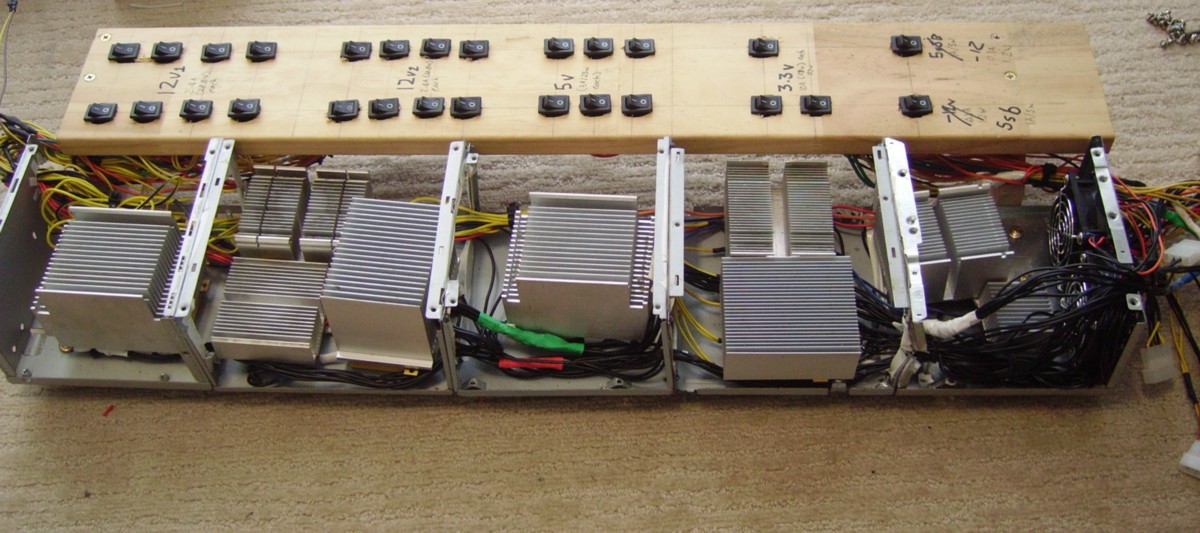

                                  Nearly finished building mine. I ran out of heatshrink tubing, though. I should be getting some more tomorrow. What do you think would be a good way of testing it to be sure it's pulling as much as I think it is? I'm thinking just load a gutless wonder to 350 watts. If it's still working 10 minutes later then there's a problem, but if it explodes, then it's a pass.
                                  • c_hegge
                                    • Sep 2009
                                    • 5219
                                    #77
                                    Re: DIY PSU load tester
                                    FINISHED!
                                    Got it all going and it seems to be working great. I loaded this unit to 277 watts. After a few minutes I got exactly what I expected, the PSU exploded, so it looks like it's doing its job.

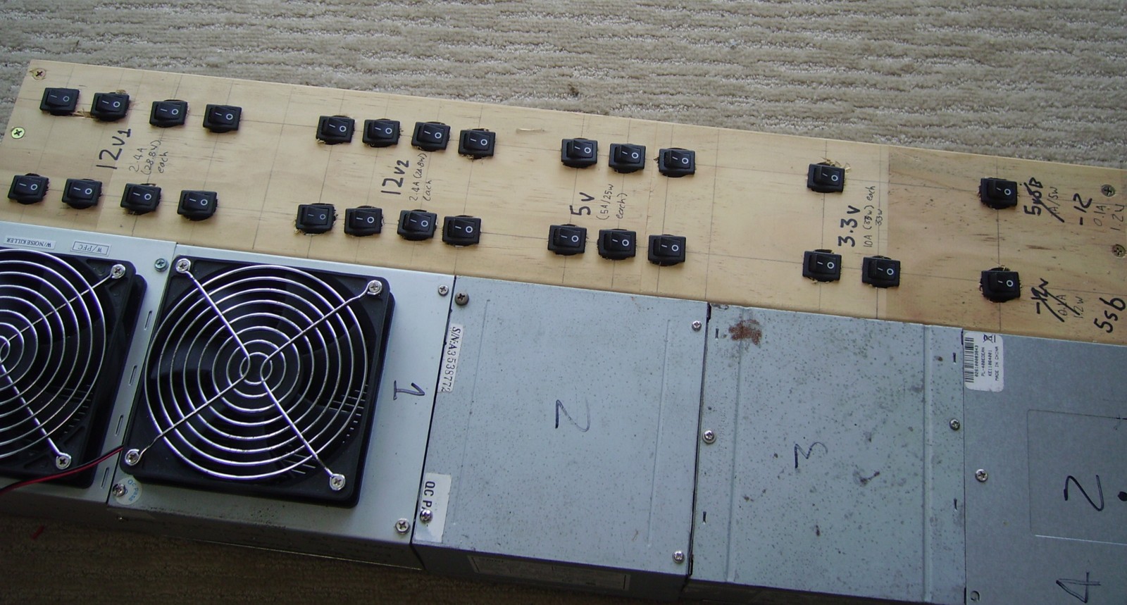

                                        #79
                                        Well done! We need some photos now
                                        • c_hegge
                                          • Sep 2009
                                          • 5219
                                          #80
                                          Here. It looks horrible, I know, but it works.
