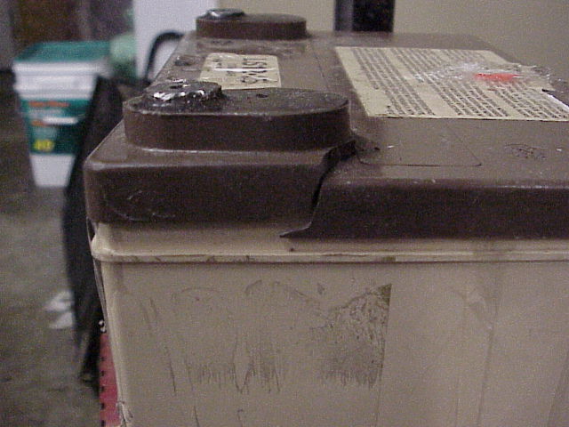

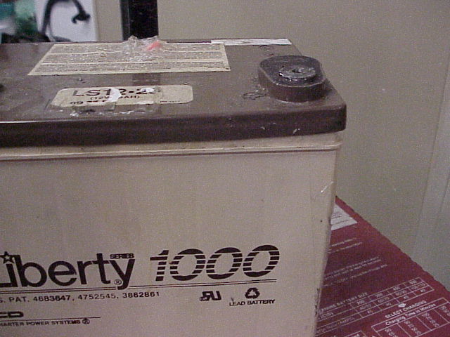

    this is a bad case of positive plate growth.
    Re: in a ups near you?
    This battery was most likely to have not been charged within 3 months.
    I am also aware of a malpractice with lead-acid batteries in new UPS units in stores, which are not charged every 3 months (especially in second-hand ones). This can lead to the battery becoming sulphated, which renders the battery useless, and more expensive for the consumer.
