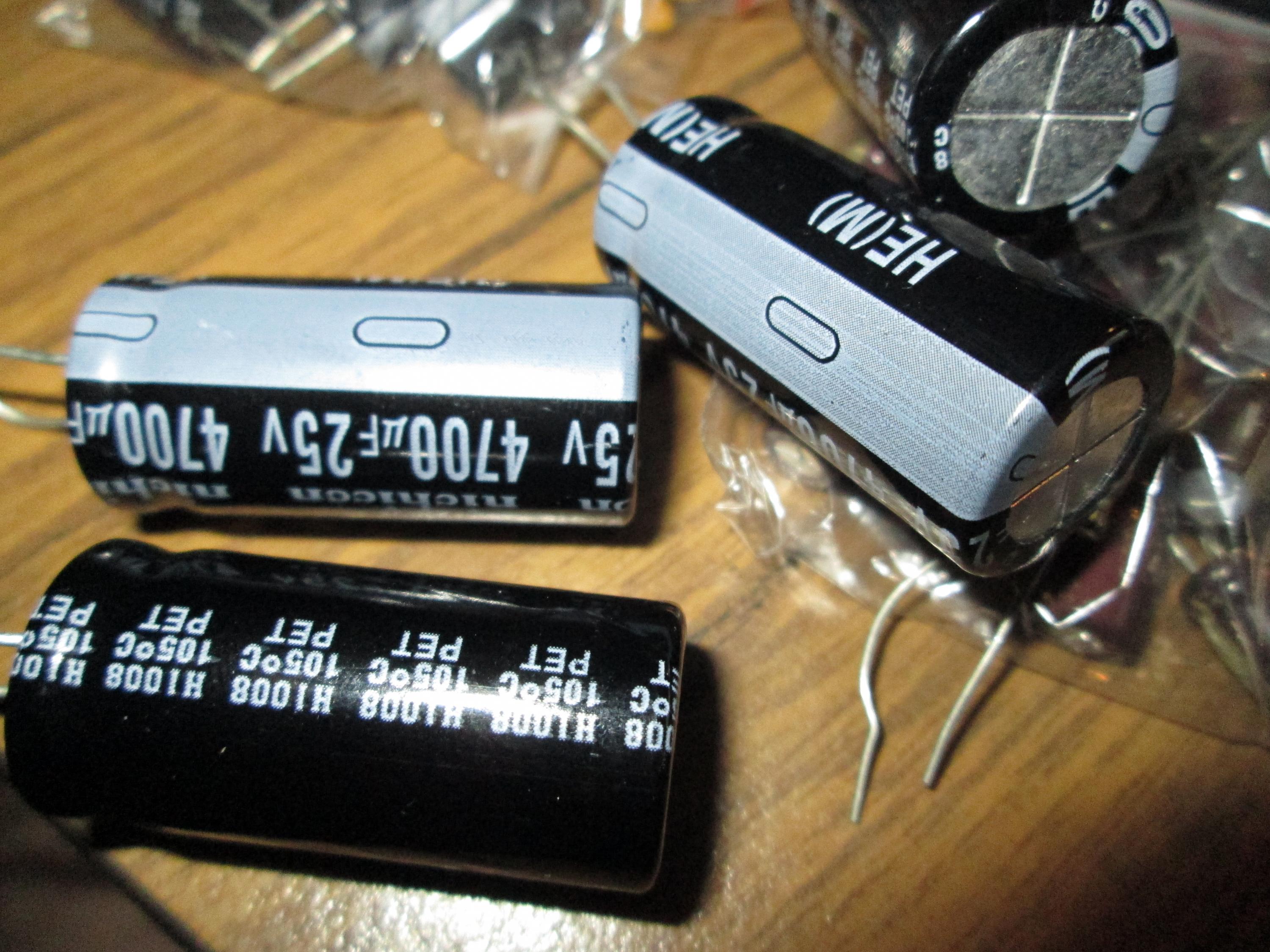

    Would It be fake Nichicon MUSE capacitor?
    Is there a way to indentify whether it is fake Nichicon MUSE capacitor or genuine one?
  • ChaosLegionnaire
    HC Overclocker
    • Jul 2012
    • 3266
    • Singapore
    Re: purchasing caps from aliexpress

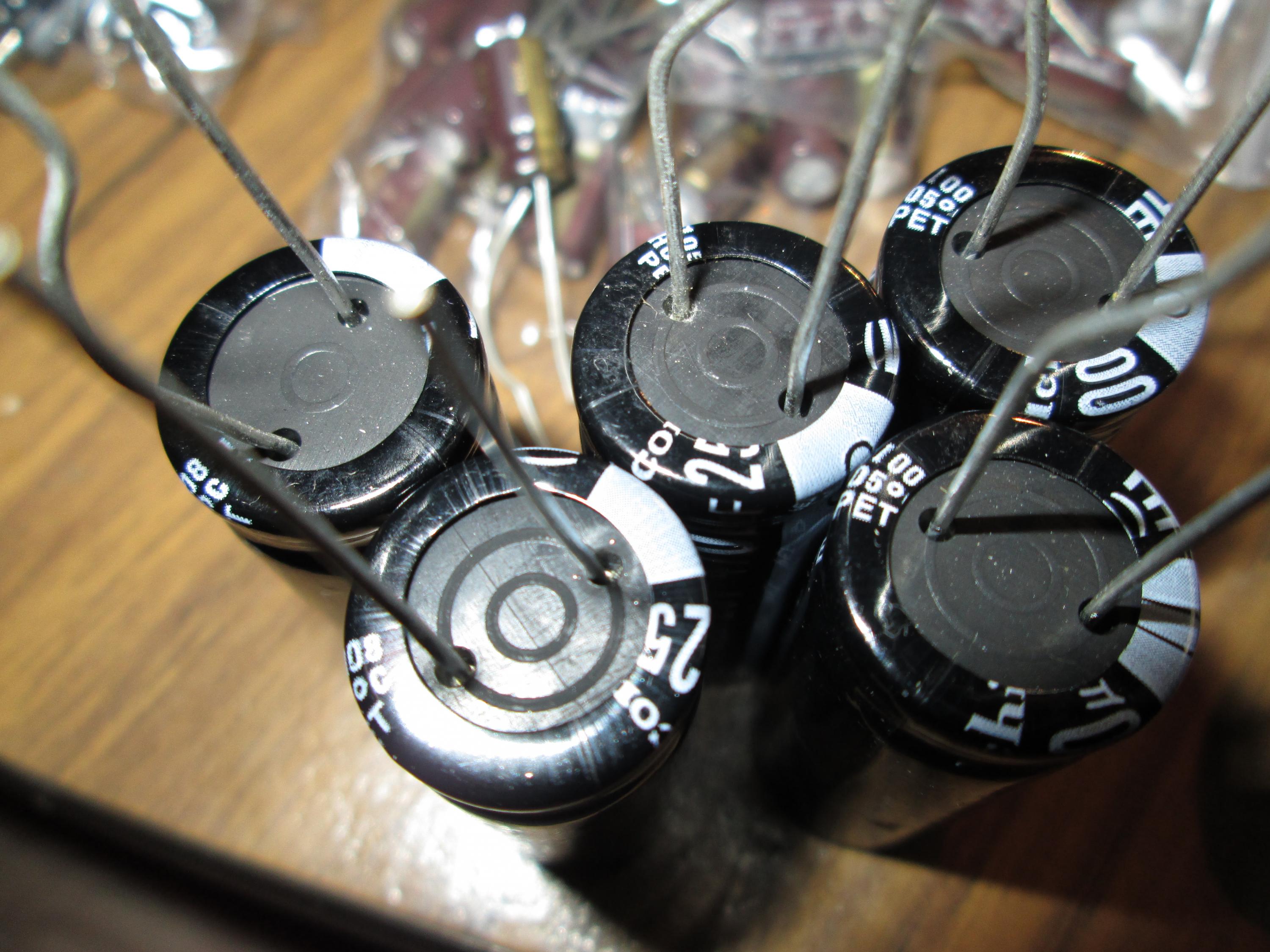

    the most often used way is to look at the bung underneath the cap. fakes often use a bull's eye or concentric circle bung. jap cap manufacturers prefer using a chain link fence chain shaped bung for their caps instead.
    other ways to test are with an esr meter and looking at the esr and capacitance specs but that is not a reliable method as most budget/cheap esr lcr meters often dont display or measure the esr accurately or correctly.
    also, brand new caps even junk ones often also measure in spec, esr and capacitance wise. its only after running for awhile that the specs of the junk cap will degrade much faster than the japanese ones.
    so looking at the feedback of the listing from the russian and other eastern european buyers, it might be genuine but it could also be factory rejects that dont meet the rigorous min specs or requirements for being sold to customers/clients of the manufacturer.
    they could also be fakes as certain can sizes or capacitance and voltage combinations arent found in the official datasheets of nichicon muse capacitors but custom sizes from a custom order could also be possible.
        I wouldn't say that those readings are evidence themselves, however, when I look at distributor sites, the capacitors always have "Fine Gold" printed on them instead of "FG" (Although oddly enough, "Fine Gold" is printed on the capacitors in review photos). Overall, this listing is tripping my BS detectors.

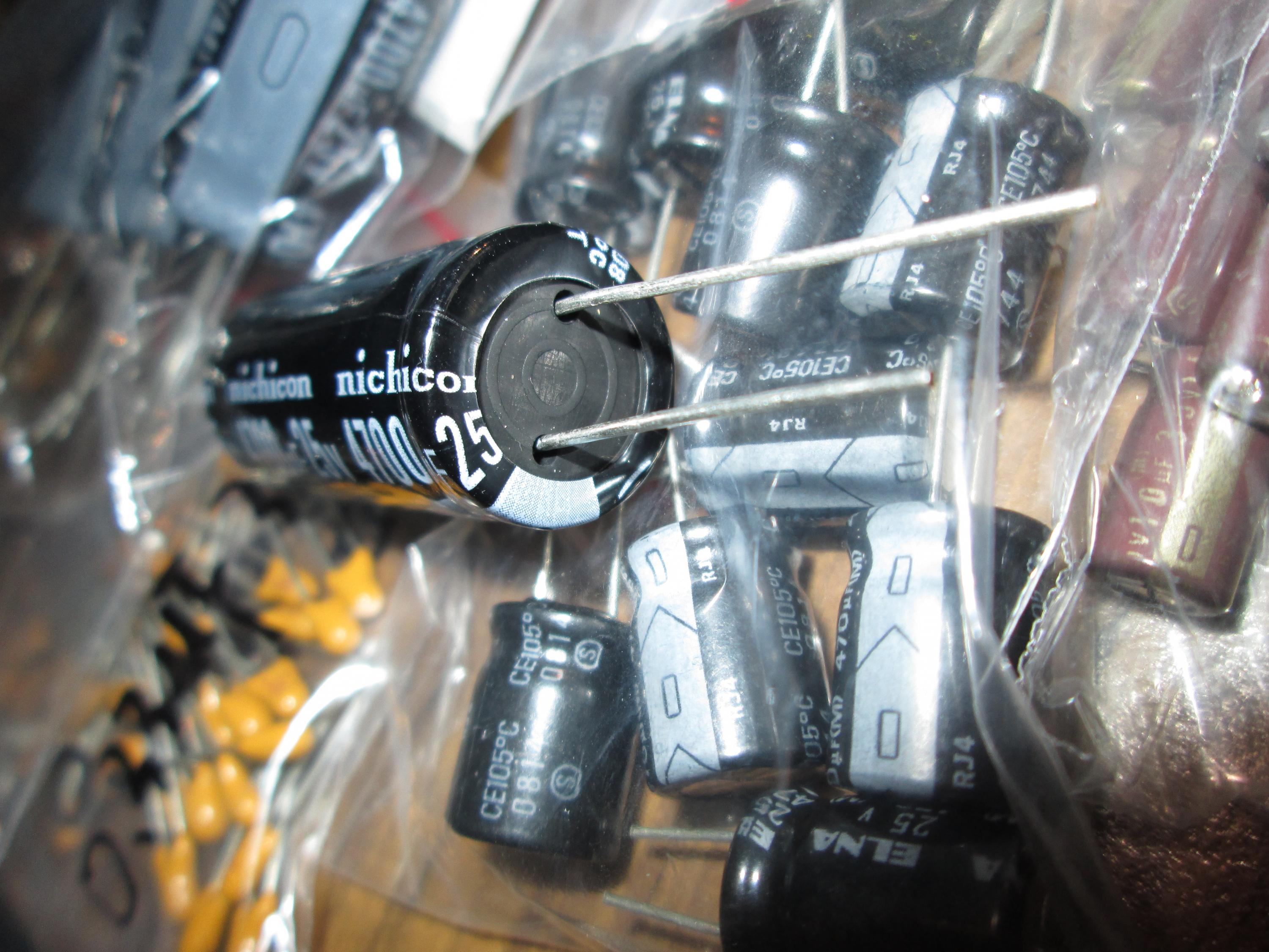

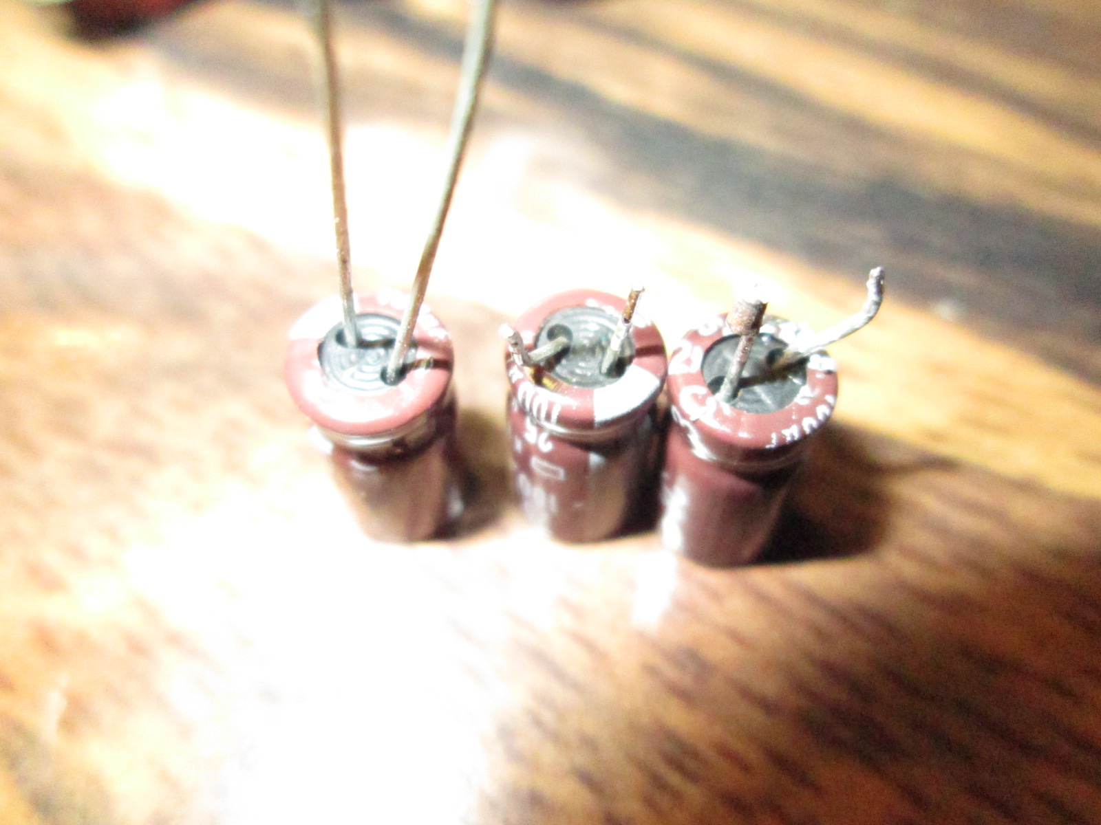

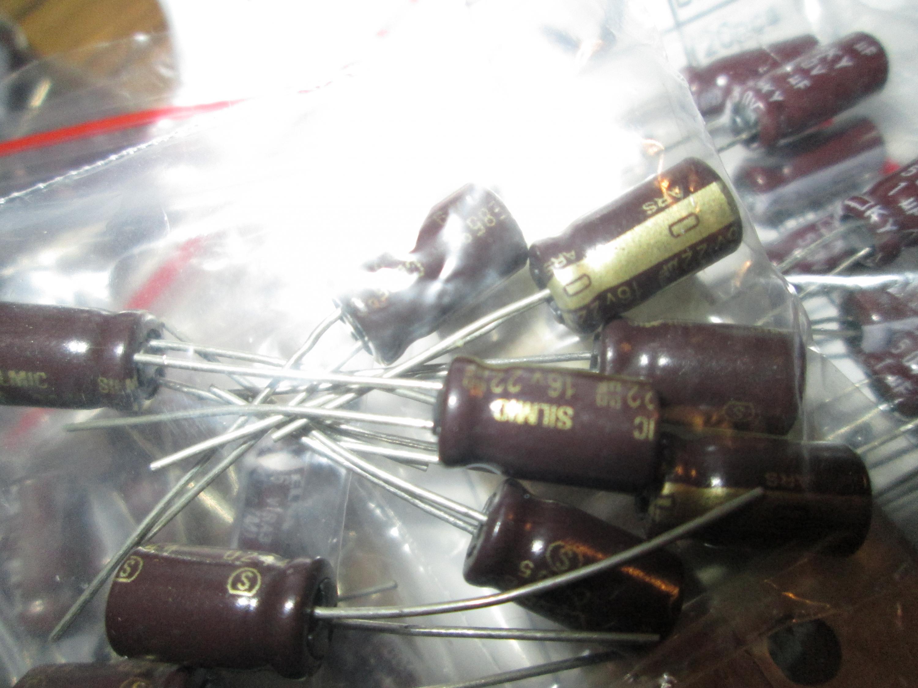

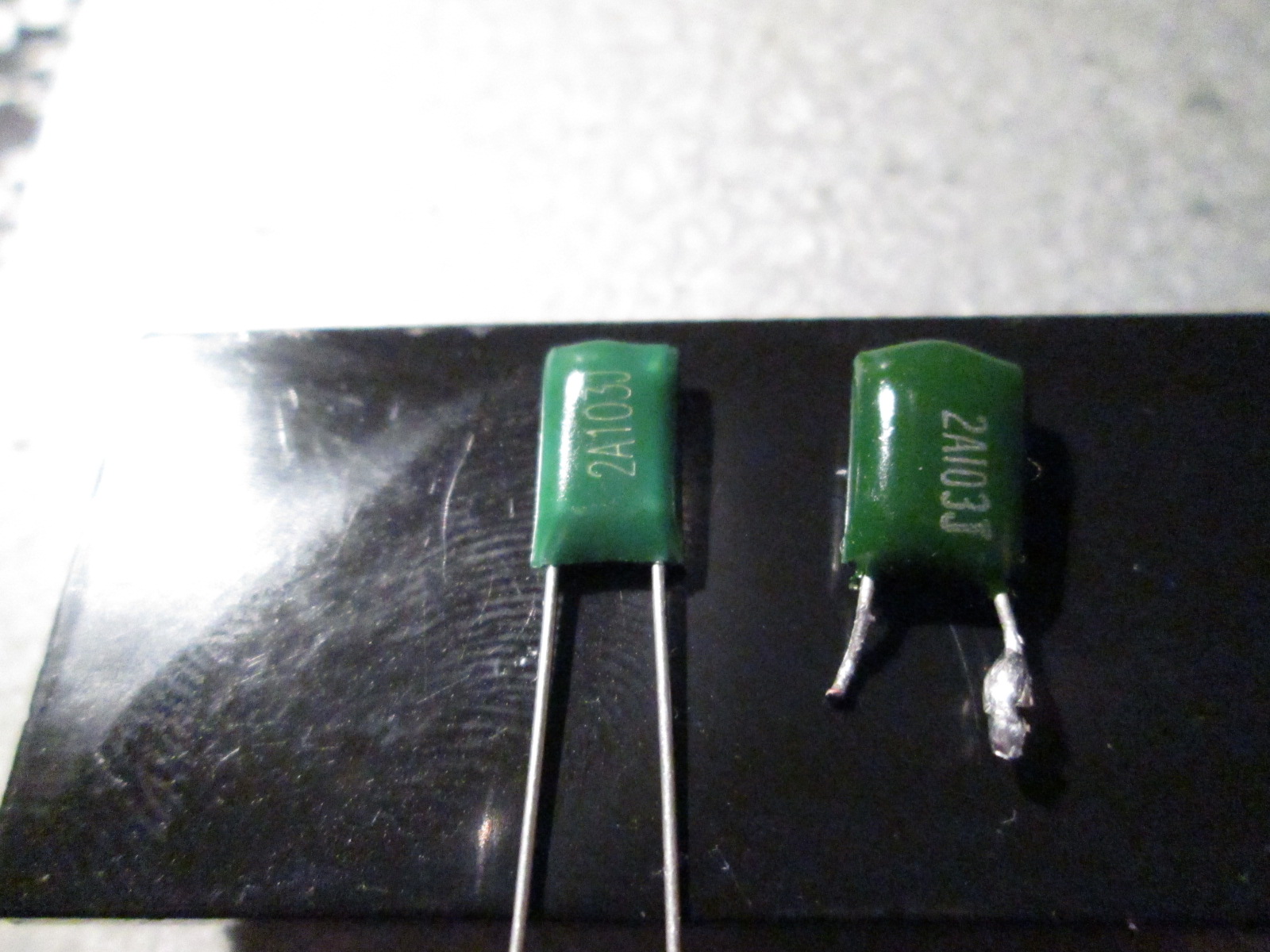

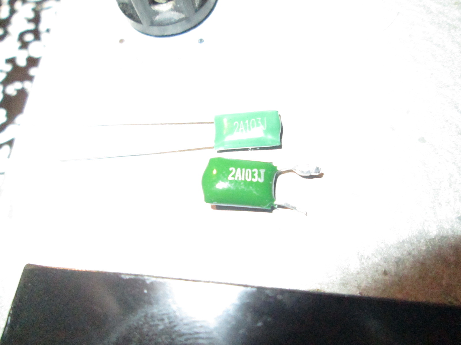

          I bought from this seller several years back.
          I needed those green mylar too which the coating was very poor.
          the nichicon and united chemicon I got were fake, the silmic caps I got were date code 2003 and leaking green crud. That was 2016 and I learned my lesson: never buy caps unless its from digikey or mouser.
          And I learned that lesson on this very site, which I am thankful. I had to go back and tear them all out.
          Its just not worth it
