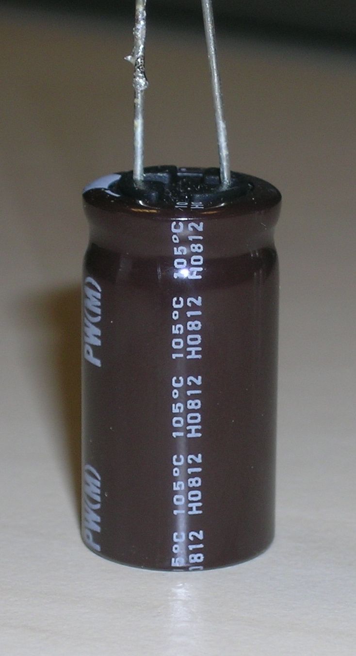

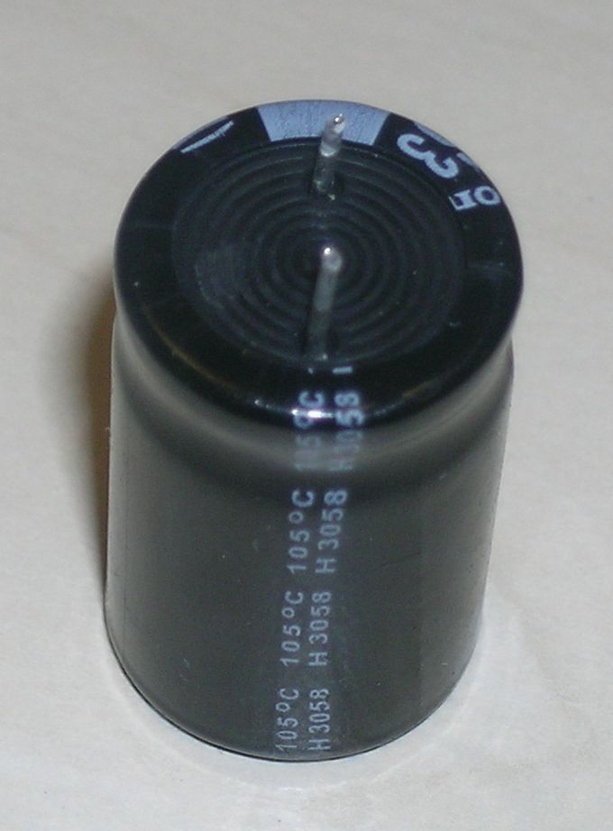

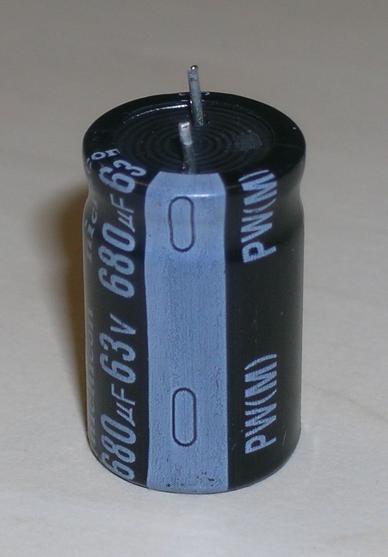

    Hi guys,
    I'm currently using two types of Nichicon capacitors in one of my projects, both of the PW(M) series.
    One is the 680 uF 63V version, the other one is the 1000 uF 63V version.
    I'm seeing quite some difference between the both: the 680 uF one has a black sleeve, a flat bottom and an odd date code (3058). The 1000 uF one has a dark brown sleeve, a bottom with a standoff implemented and a date code that makes sense (0812 - week 12 of 2008).
    So I'm guessing the 680 uF are fakes ?
    Thanks for your opinions !

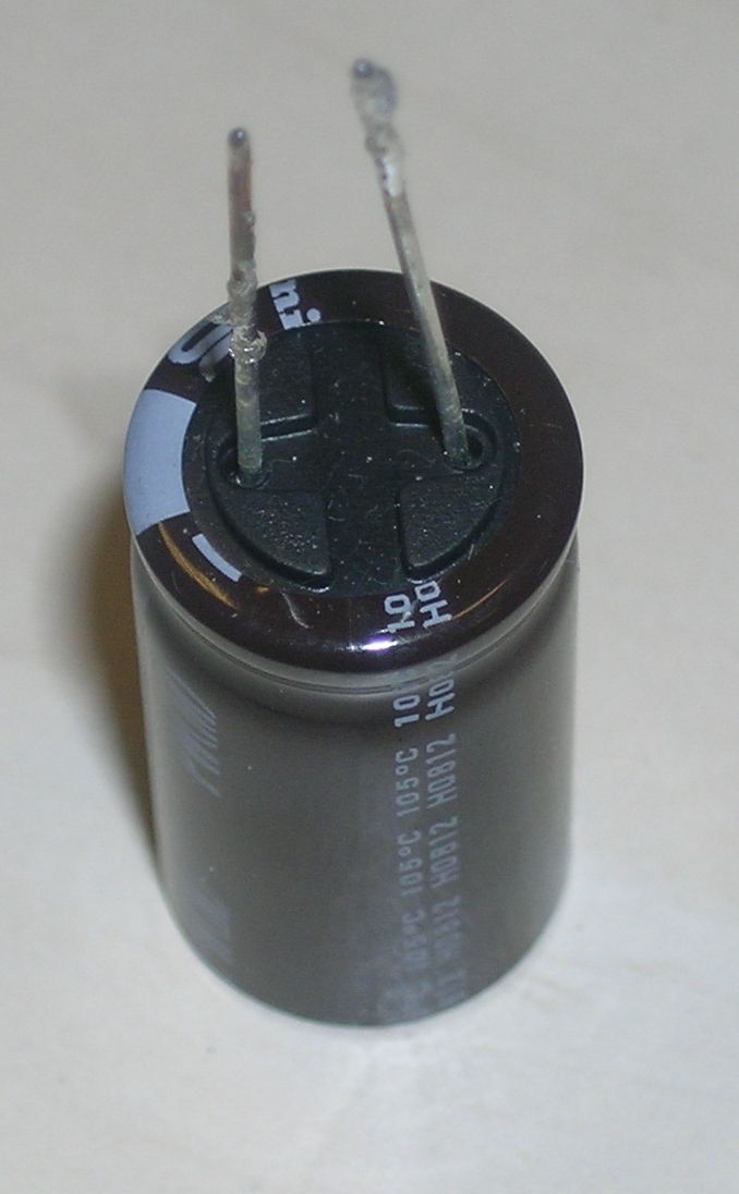

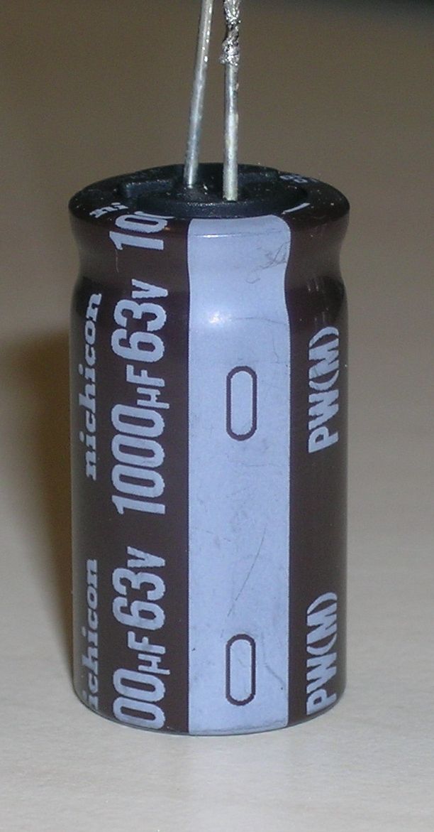

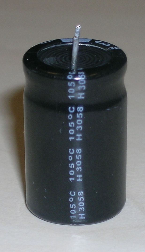

      Here are some pictures.
      The first three are the suspected fake ones. The last three seem to be OK.

        The 63V 680uF are definitely fakes, you can tell right away by looking at the bung. The other ones look legit.

          lol at that fake cap with the cheapo circle bung.
          according to the datecode, it's either 70years old or from the future (2030)
          plus... week 58..?

                    I can't stop laughing at that 3058 date code.

                          anyway, the code 3058 seems to be a common fake code, iirc some probable ebay fakes mentioned elsewhere had that EXACT same code... i bet the fakes are from the same counterfeit factory...

                            lets just say this.. wrong date code means made it through many bad quality control checks meaning you dont want them anyways because that just proves that the quality control sucks.. most, if not all caps made in japan would not let anything remotely this bad through.. China would.. China dont care.. so bad date code definitely means fakes if they are a Japanese brand..
