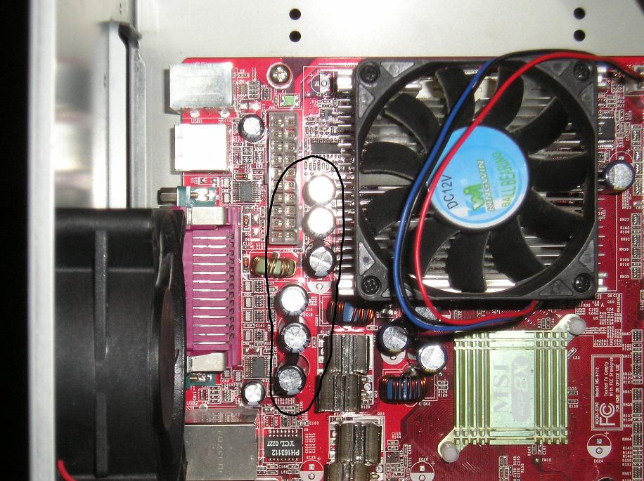

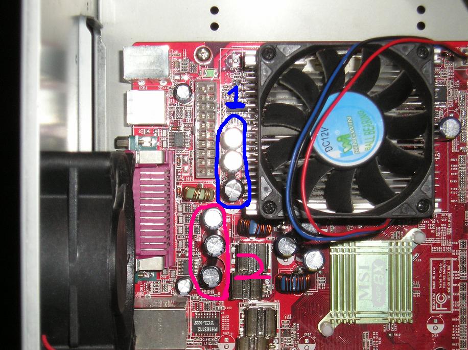

    I am recapping my MSI KT4V MS-6712 Ver: 1.0. I have recapped the board but in my haste I think I mixed up the six capacitors by the CPU socket. If I read the board right it's the following numbers EC15, EC18, EC22, and EC80, EC92, EC113. Can anyone send me the correct capacitance for these? Thanks for your help

    in most cases the caps closest to the cpu will be for vcore and wiil likely be the highest capacitance at a low voltage like 6.3 or 4v
    however the one close to the atx might be a supply bypass for +5 or +12

      Thanks for the quick reply, so if I understand this the caps circled in blue should be 6.3v 2200uf and the ones in red should be 16v 1500uf?? Thanks again

        that would be my guess.
        a quick and dirty test would be to check for a very low resistance from +12(yellow)to + of the caps in red.
        they are likely on the vrm imput from +12
