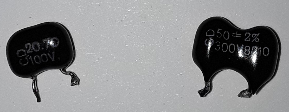

Please help identify a capacitor
  • jpyerry
    • Jan 2013
    • 94
    Please help identify a capacitor
    I really hate to post a newbie question, but I need help identifying a capacitor. I have attached a photograph containing two capacitors, I am almost certain they are mica capacitors. I have searched for how to read the codes on the capacitors and I just cannot seem to figure out what they mean. I also tried measuring the capacitance with my multimeter to try to narrow down the possibilities to give me a clue as to how to read the values, unfortunately my meter gives me wildly inconsistent numbers every time I try to test the capacitance, so no help there.
    If anybody can tell me how to read the codes on these, it would be greatly appreciated.
    Thank you very much.
  • R_J
    • Jun 2012
    • 9607
    Re: Please help identify a capacitor
    The look like cornell dubilier mica capacitors 20pf/100v and 50pf2%/300v
    You need a capacitor meter to read the capacity.
    Last edited by R_J; 10-20-2020, 09:20 AM.
    • jpyerry
      • Jan 2013
      • 94
      Re: Please help identify a capacitor
      I appreciate your help.
      So, the ".7" after the twenty doesn't mean anything? I wasn't sure if it was a multiplier or some sort of tolerance specification I wasn't aware as this is the first time I have actually seen mica capacitors and it was really throwing me off.
      • R_J
        • Jun 2012
        • 9607
        Re: Please help identify a capacitor
        Never mind
        Last edited by R_J; 11-27-2020, 04:47 PM.
        • MORETTIGIAN
          Capacitor detached from PCB – RTX 2070 Super Founders Edition
          by MORETTIGIAN
          Title:
          Capacitor detached from PCB – RTX 2070 Super Founders Edition
          Description:
          During maintenance on an RTX 2070 SUPER Founders Edition, I found a capacitor lying on my desk after reassembly.
          I did not notice it detaching, so I am unsure of its original location on the PCB.
          Procedure performed:
          - Removed backplate
          - Cleaned heatsink and PCB with isopropyl alcohol + soft ESD brush
          - Reapplied thermal compound
          - Reassembled card
          Observed behavior after reassembly:
          - GPU powers on and operates normally under...
          09-18-2025, 12:14 PM
        • Sparklingx
          SMD ceramic capacitor capacitance & voltage
          by Sparklingx
          what is the easiest way to measure the capacitance of SMD ceramic capacitors and its rated voltage?...
          09-12-2024, 01:04 AM
        • BlackBurn
          Help to identify a laptop mainboard SMD capacitor LA-9982P
          by BlackBurn
          I have an Dell Inspiron 15 3537 laptop mainboard (LA-9982P Rev. 3.0 (A02)) with a blown SMD capacitor as shown in the attached images. However, there is no printed specifications near the capacitor or a codename for the capacitor to identify the specification of the capacitor to replace it. I wonder how to identify the capacitor since the mainboard schematics are also useless as the capacitors are not named on the board. Any help would be highly appreciated.
          Thank You. Stay Safe.
          Chamara...
          11-27-2020, 08:30 AM
        • Agent24
          Dick Smith Q-1760 linear power supply filter capacitor question
          by Agent24
          I have acquired a used Dick Smith Q-1760 power supply - although the OEM is Manson Industrial
          It has at least one problem.
          The voltage control potentiometer VR2, 50K is faulty - going high resistance / open circuit in the CCW end and leading to the output voltage jumping around.
          I have already ordered a replacement potentiometer, so that's not an issue.
          Now, I want to replace all three electrolytics on the PCB as they are CapXon and I don't trust them so much, I will replace them with something better while I've got the thing apart anyway.
          All are CapXon...
          10-21-2025, 05:39 PM
        • chth96
          If I replace with inferior capacitor, Is it No harm to other IC components at all?
          by chth96
          I replaced some capacitor which is located on optical pickup pcb which is shown in the table below(PCB #2).Because it have been out of order.
          Now,It works very well,But I just have found that all caps (6svpc100my and other part number as well) ,which is shown in the table below, has ultra-high ripple current spec.
          It is not able to obtain any capacitor which can be a substitute for this ultra-high ripple current nichicon capacitor.
          So I replaced it with samxon and rubycon's general capacitor(GP,YXA series).
          I know that these capacitor will not last as long as nichicon capacitor...
          12-22-2023, 04:34 AM
