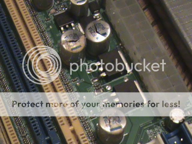

    Hello. I recently had 5 6.3v caps blow on my motherboard its an EVGA board and i am going to recap them myself. I just need to know what do I order? Going to order them from this site but just not familiar with any values other than they are 6.3 v? Thanks for any help.
    Re: New DIY recapper
    heres a pic of 2 of the caps ( pic sucks but best I can do atm sorry)
    You can see the 2 under the red light are cracked and the 1 on the left is leaking out. Juts trying to figure out exactly what to order to replace them. AllI know is they are 6.3V.

      Looks like Sacon FZ. Is there a "FZ" marking in the first line on the top of the capacitors?
      If yes, those are known to be problematic - would be a good idea to replace all that have the FZ marking all the way down to (and including) 470uF.
      As far as cap replacements (brand and series), you can get Rubycon MBZ or MCZ here. There's also Panasonic FM at Digikey and Nichicon HM/HN/HZ at Mouser.
      You need to provide the uF rating of the caps, though. The aforementioned FZ caps usually have it written above the voltage. If you're unsure, just write down all the info and numbers you see on the cap.

        they caps say
        FZ5A
        1500
        6.3V
        is 1500 the uF? What would you recomend to replace them if so?
          The 1500 is indeed the uF. Replace them with new 1500uF caps from a reliable manufacturer. Also, don't just replace the busted ones. Replace ALL Sacon FZ on the motherboard. Even if they are good now they will almost definately fail soon. Also, it is common for caps to fail with no visible signs. Any one of the series that momaka mentioned should be fine for replacments.

            Thanks for the replies. I ordered enough Rubycon caps to replace all the FZ caps on the mobo. Strangely all the caps that blew were all 6.3v FZ caps. When they blew I remember being at my computer and hearing a loud POP noise. At the time I had no idea what it was. For about 3 weeks time I would hear a loud POP on occasion. I finally narrowed the sound down to my PC and got a flashlight to look inside and saw the caps with the tops blown.

                                    I got my caps today in the mail and went ahead to try out my hand at recapping about 2 hours ago. The iron I ordered stayed hot long enough to tin the tip then died to I had to dig out my dads old 1970s era iron and use it.Aftrer removing the mobo and the RAM gfx card I noticed on the gfx card there was a blown cap as well. So I replaced it too. It was an Evercon 1500uF 6.3V I replaced all the Sacon 6.3Vs and 2 Sacon 1500uF 10V. But I DID IT!!! After cleaning the case out and reinstalling everything I hooked it up and it works great! Below are a few before and after pics ( remember this is my 1st time doing this)
