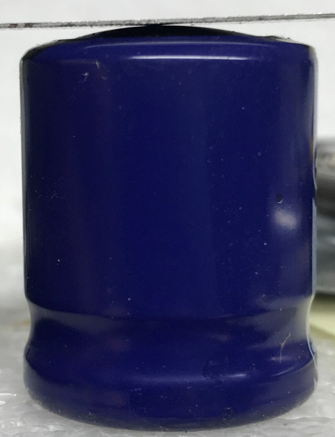

    I recently picked up a an old Apple //c color monitor from 1985. I noticed the color controls were quite touchy, so I opened it up to see how hard it would be to get the pots out to clean them. And I saw a cap that looked like the top was bulging pretty good.
    So out the logic board came, and now I'm looking to recap the whole thing just to be safe. Unfortunately, Apple didn't believe in board level repairs, so schematics are non existent. I had to go through and inventory it manually, and have no idea where in the circuit any of these really are to even guess what type I should replace them with.

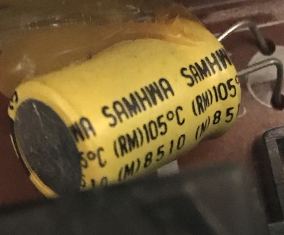

    There was also a yellow sleeved Samhwa RM series cap. I think that means its a special "low leakage", cap correct? I think the main modern replacement for that is the Nichicon KL series?

    Here is the cap that triggered all this. Pretty sure my ruler should be sitting flat on top of this. Its a snap in cap with a plastic top. Not sure how much more before this thing was going to crack open. Unless this is just how Samhwa made their caps. But I doubt that.

      I've only worked on one other CRT before, and it did have a schematic and parts list. It had a cap on the deflection board that was also yellow jacketed (but at least it was a brand name cap), and was called out as being low leakage on the parts list. Can't be a coincidence this board has one too. But I could be wrong. I don't know how CRTs are designed. I just know how to discharge them and replace components in them.

        well given what was available then, try using a rubycon YXF

            In general, I always try to look for a good balance of ripple and lifespan. For the higher voltage caps, I went with a mix of UCY, UCS and UPW. I did use a Nichicon KL low leakage to replace that yellow sleeved one. I didn't want to take the chance that it was just a fluke the sleeve was yellow. Worst case, I don't think a KL would have a negative impact. All I know is it looks like it was directly connected to the flyback.
