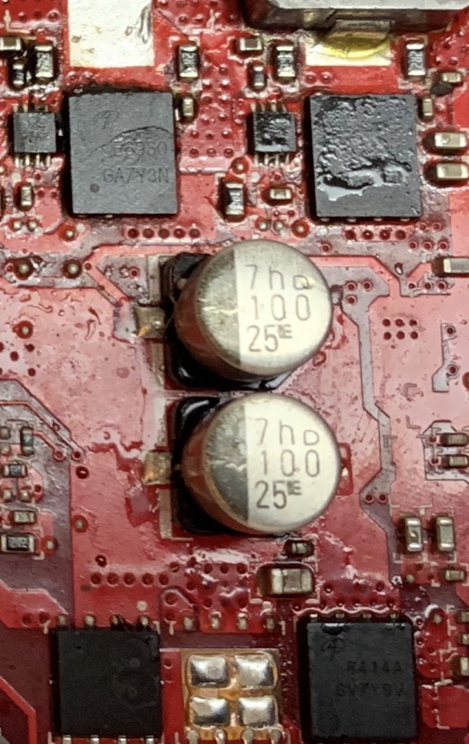

    Just had these capacitors blow. Can anyone send a link to where i can buy these specifically? I just want to be positive i get the right ones. Thanks in advance!

    Looks to me that these are 25 uF / 25 Volts - they are smd capacitors
    There are many good brands : like Panasonic , Nichicon , Elna ,
    You can find them on Mouser , Digikey , and other places

      More like 100uf 25V .Looks like a laptop motherboard,the schematic,if available would tell you for certain what they are.

        Yea I determined that they’re 100uf 25v. There are no schematics available, unfortunately. However i just bought some that are 100uf, 25v, and are a similar size on mouser. Hopefully they’re close enough to work

          so was it you that baked them? i see all that flux!!

            Yep :p i was attempting to remove the MOSFET you see next to it, but my hot air station couldn’t do it fast enough. I even had some kapton tape on the caps. End result: blown cap and still bad mosfet on the board
