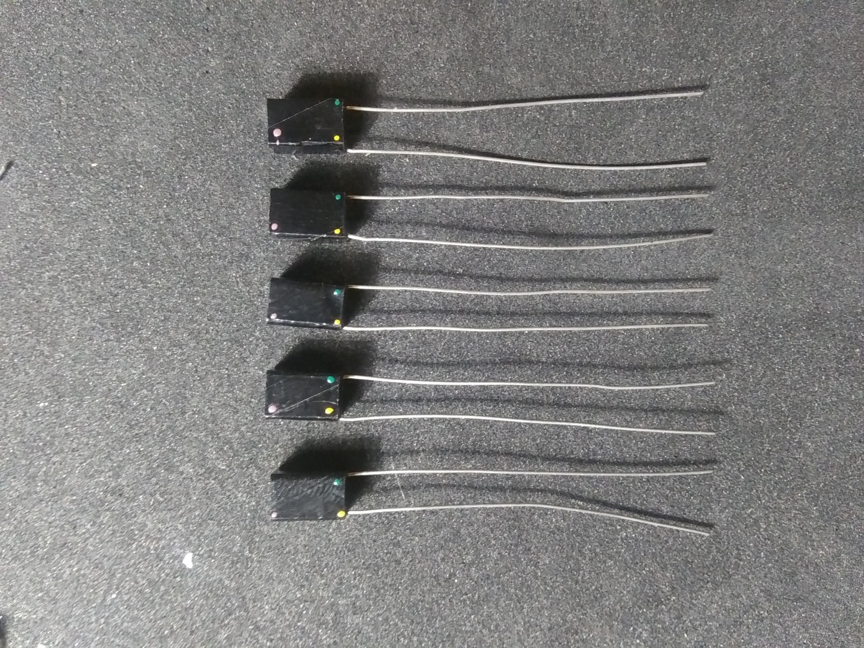

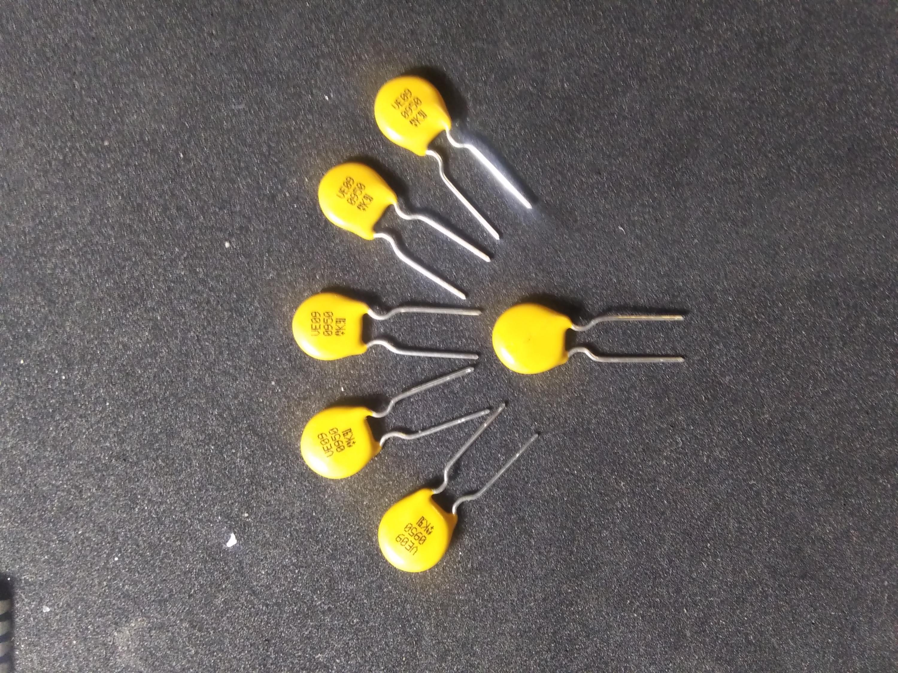

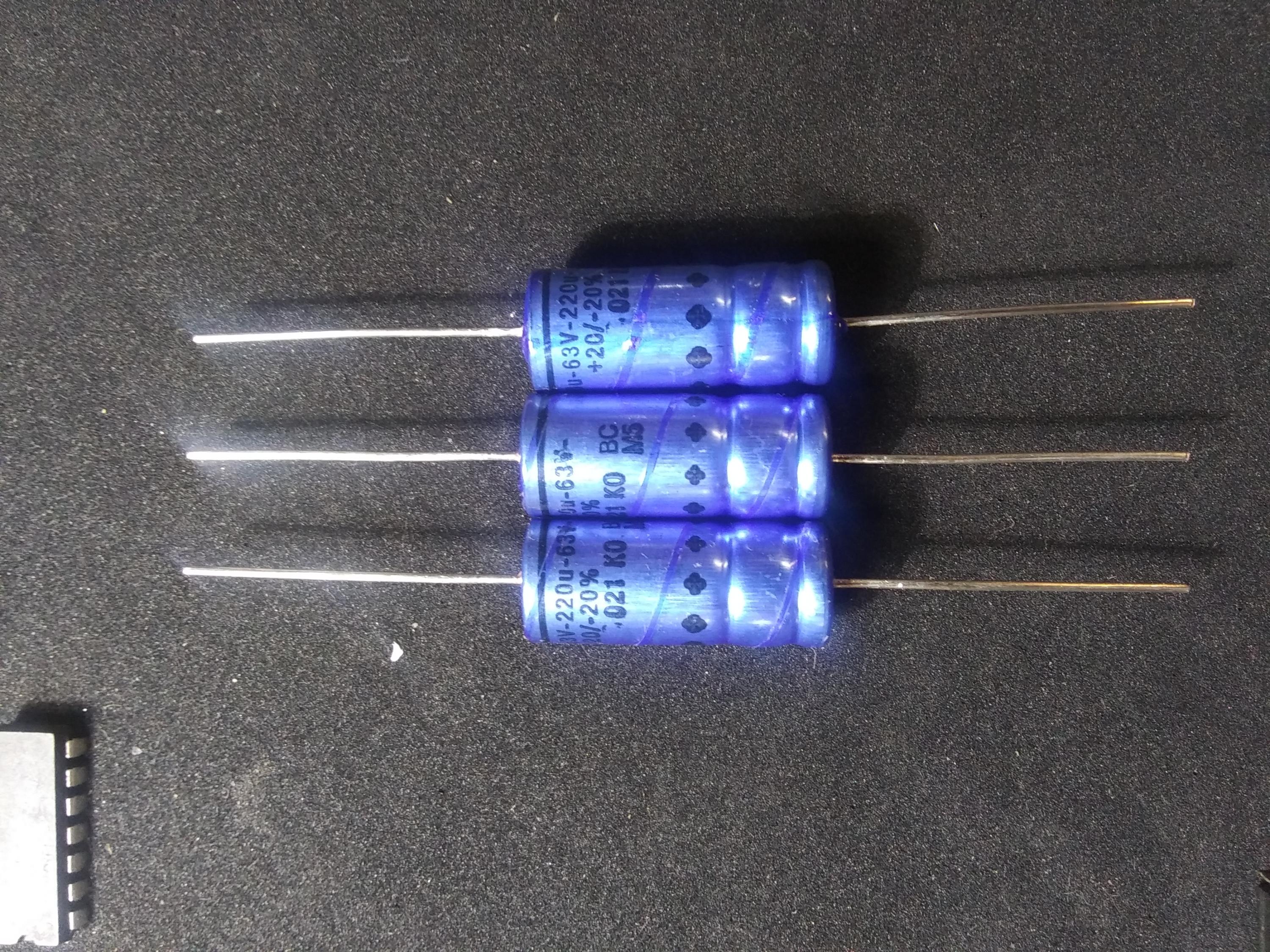

    Hi there guys and gals. Just bought a huge lot of electeonic parts online and while I dont usually buy N.O.S. electrolytic caps, I have around 500 of the blue and yellow caps. About 40 of rhe black box. They came with no paperwork and was hopeing some of you fine folks could help me identify them. Blue electro is 220u@63v. MLCC type measured 270pF. The black box type measures 5uF but the marks say 475 (4u7). Any help would be greatly appreciated. Trying to figure out the manufacturer along with the voltage rating.

    The yellow discs may be Metal Oxide Varistors (MOVs). The markings are unlike what would be typical for ceramic capacitors.

      PeteS is correct, The VE09 0950 are AVX 95 volt ac Zinc Oxide varistors

        blue electrolytics are made by BC,
        i think they are now a subsuduary of Vishay.

          I've not seen anything like those black boxes with the colored dots, and I've been interested in electronics since high school, Nixon's first term as President.
          I'm going to guess those MOVs R_J identified are intended for telephone line surge protection.
          Axial lead electrolytic caps (first picture) are usually general purpose or maybe non-polarized.

            I have some similar blue capacitors like the first picture with the Philips name on them.
            I too have never seen those square black devices, (cap?) anywhere.
              • 31289
              Re: Capacitor(s) Identification
              the black ones look like some pre-ww2 stuff from "mr carlson's lab"
              they are probably mica or foil.
                  I've seen older military style mica caps that look like this:
                  But not in about 50 years.

                          • Chillums
                            • Jun 2019
                            • 4
                            Anybody here have any use for these caps. Think I have around 50 of them. What do you think they are worth? Still have not had any luck finding info on these.
