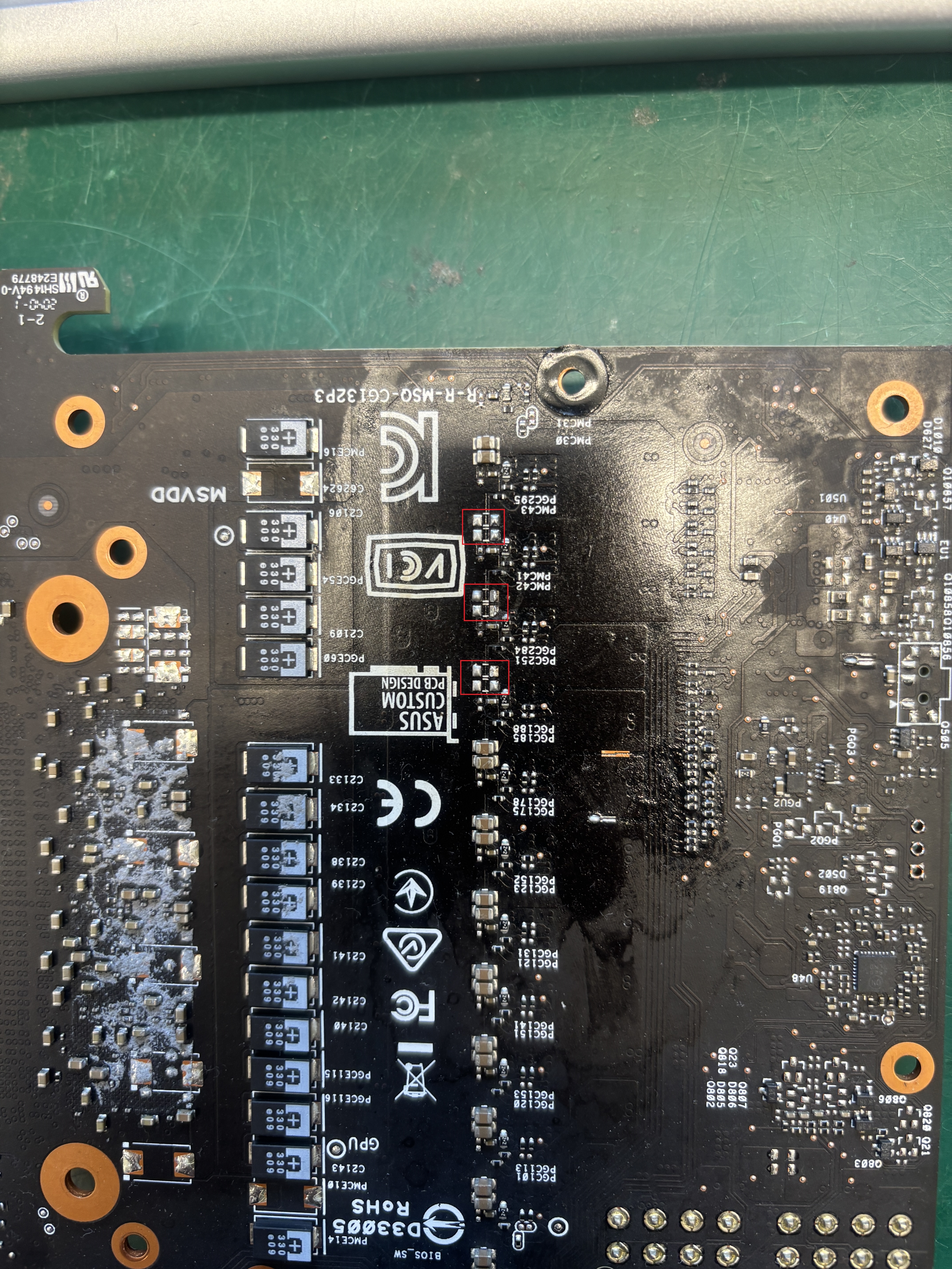

    Hi
    I have a card that is missing capacitors, in the places marked in red.
    Does anyone know their value?
    Thanks in advance for your help​

    Something like 10uF or 22uF with 4V or higher will do.
      4V? this is 12V supply rail to DrMoses

        I think it's on the low-side of the DR-MOS. But it can be proved. Boardview, Schematics, or just a simple measurement with a meter.
          lack of skill. that many tantal capacitors are on low side

            I installed 10uf 16v and its working properly.
            Solved
