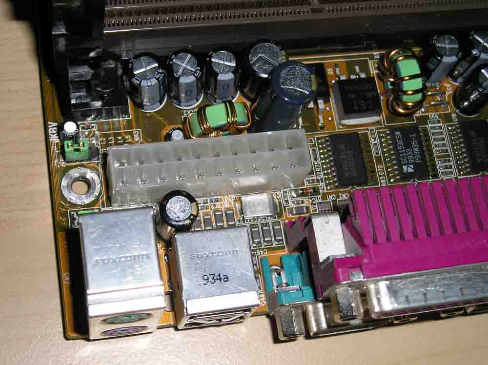

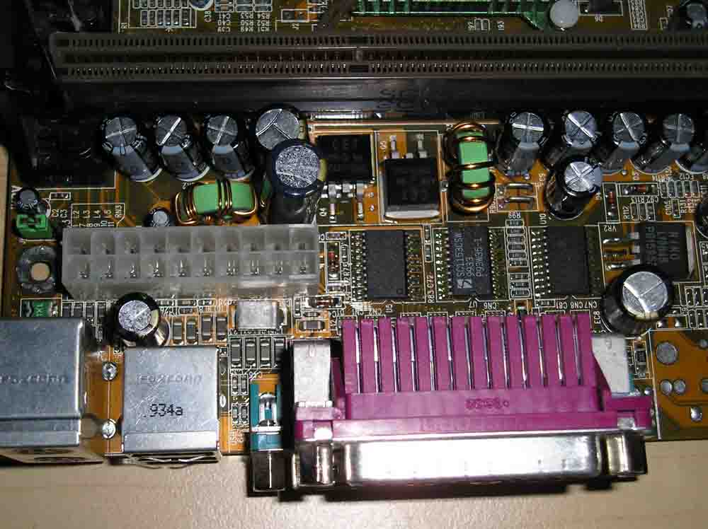

    I finished soldering the new caps in and now when i attempt to power it up, the same thing happens, I can smell a slight electrical burning smell, coming from the area right in between the caps, its actually the same smell that was orignially eminating from the area. It seems to be either coming from these black things or the coil. There is no sign of anything burnt on the board, so im not sure what is causing the smell.
    I know this board isnt worth more than 5 bucks but i would like to fix it. What do you guys think, is there any hope for this board? I have some pics of the area. I hope this works.
    Can you tell anything from these pics?

    Check your VRM FET's for shorts. Also, check your PSU.

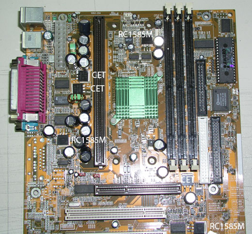

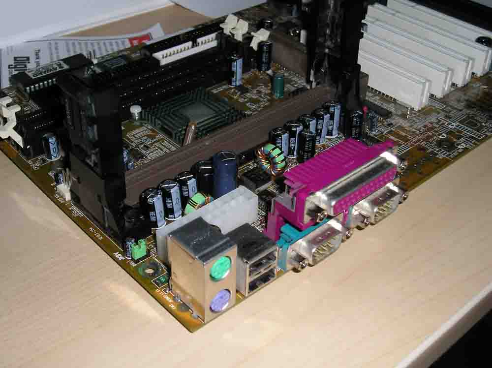

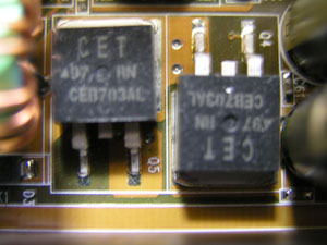

        that is a rather typical way for a 6163 to go. I can help you with half the question, the vrm fets are the 2 black square boxes inbetween the two rows of caps next to the slot 1. they are marked CEB703AL. I have some pics from before, on the first pic they are marked CET.

              you could also have chipset damage.
              sometimes the vrm chip itself dies when a fet shorts.an example is the sc1153csw between the inductor and the paralel port.if you get a blink and the fans twitch you likely have a shorted fet.

                    looking at the fet as it lies on the board with the pins pointed at you they are from left to right g d s.
                    gate drain source
                    they usually short d-s
