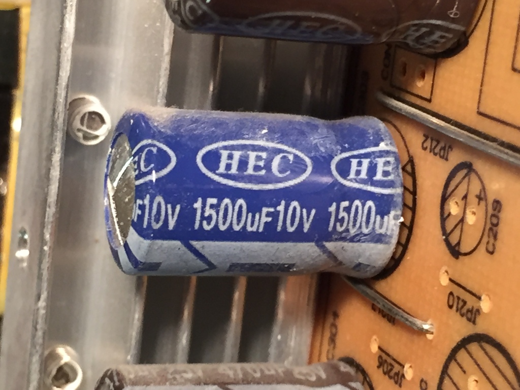

    I was not able to locate any information on a capacitor I have. It says HEC on it - 1500uf10V. I need to get a replacement and was looking for the specs on it. Any help would be appreciated.

    Don't understand your question. You want specs. on 1500uf 10v cap? All specs you need are on it.

      Sorry, I've only changed the capacitors on a TV twice. But the last time I did I was told I had to research the other values besides those I noted to ensure I get the right replacement. I think one value was ripple and the other ESR.... if I recall right. Is it just as simple to make sure I get the same V and uf?

        If it is for a power supply you would need low esr cap 105c temp.

            A good quality brand too. Rubycon, nichicon, panasonic
            It should say more than HEC. there should be a model name like SF, SM, ZB, just some of HECs radial models

              I've had this TV in my garage for almost a year. I never got the capacitors. I'm going to attach a picture of them. If someone could help me locate a good replacement, it would be appreciated. If I recall correctly, these are from the board for the power supply.

                remove it and see what else it says.
                or just use panasonic FR series.

                  HEC capacitors are crap and well-known to fail. Replace all HEC-branded capacitors on your power supply.
                  That said, without knowing the series of this HEC (should be a 2 or 3 letter code), I can't tell you what would be a precise replacement. But in general, the following are caps I typically use in switching power supplies:
                  Nichicon: PS, PM, PJ, PW, PA, HE, HV, HW
                  Panasonic: FC, FR, FM, FS
                  Rubycon: YXJ, YXG, ZL, ZLH
                  United Chemicon: LXY, LXZ, LXV, KY, KYB, KZE, KZH
                  In all likeliness, any of the above listed brands and series will work as a replacement.
                  Digikey and Mouser should have most of these. Badcaps.net/store may also have some of these.

                        Thanks for the help and suggestions. Ordered some of hte Panisonic FR series.
